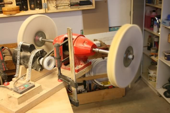

I used to get decent results, or so I thought, with hand polishing my lacquer finishes, then using lamb's wool buffs and hand glazing. It sure was a lot of work, though.
Rod True wrote:
I sure wish I had the room for a buffing wheel and arbor but that's just not possible for me in my small little space.
My buffer is mounted on a board which I clamp to a bench when I use it, and it can be stored on a shelf or hung on the wall otherwise. For me, this is much more effient than the manual procedure, and I think my finishes have gotten better too. I’m sure I could have improved my technique with my previous method and gotten equally or even better results with more practice and diligence, but for me this simple buffer has been a blessing. Finishing is a real time sink, and the less time I spend on this particular step, the better.
