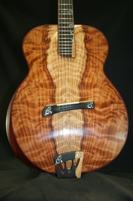

Peterm: What a beautiful curly soundboard!!!! Incredible grain!!! More pics of your guitar??? Love the idea of the double top, but not sure how to get there at this time ( inside skin, bracing, nomex?).....would like to explore this wood more....

[b]Dear Doug
I have just taken delivery of the following quilted redwood top guitar :
http://guitar4christ.com/modules.php?na ... ic&t=23637
Soundwise, it is very good.
Cheers,
[:Y:]

Great guitars guys, all are truly excellent [clap] [clap] [clap]
I think Peter's approach of using double top construction is a very wise way to over come the problem of the longitudinal weakness and instability presented by the short grain which makes the 'curl' in curly redwood. If I recall correctly, the top on Hesh's guitar was treated with epoxy which not only 'popped' the grain, but I imagine would have also gone a very long way toward locking or stabilising the grain.
Once again, I think it comes down to the piece of wood at hand, but I think Peter's approach is one way to ensure that a curly redwood topped guitar will be around and playing just as long as any other.

wklee, that guitar is beautiful! Different, unique, and beautiful! Here are a few pics of the eye candy in case someone doesn't click the link.......

wklee; your headstock/fretbaord/soundboard wood pattern is phenomenol...what type of wood is the headstock/fretboard...they all flow together perfectly (IMHO). Overall, an absolutely beautiful looking (and as you say, sounding) archtop. WOW. Who is that builder of such a fine instrument??
PostPosted: Sun Jan 04, 2009 9:38 am
Joined: Thu Dec 13, 2007 12:10 am
Posts: 3
Dear Doug
The headplate and fretboard are made from African Blackwood. The builder is Cory Batson from Nashville.
