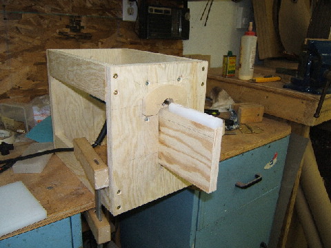

Here's the jig I made up last week to do #3. It's half in. plywood and clamps to the top of my bench for easy storage. Seen many ways to do the support to ride on the top of the guitar, but I made mine pretty simple. The LP style body I'm building has a pretty deep carve, so I took a half in. piece of pine, drilled a 1 in. hole with my forstner bit with just about half the bit hanging off the edge of the pine. That left me about 2/3 of the hole in the pine. Then I cut 3/16 outside the hole on my band saw, and glued it to the bottom. That leaves me with a 3/16 ledge to ride around the top. Just used it yesterday, and it worked great. But the edge on the body, start the router, feed it in till the bearing touches the side, then slide the body around under the jig. After doing 2 with a hand held base I made for my laminate trimmer, I'm glad I took the time to make this jig.
Here's the end result. It's still proud of the top, as I haven't scraped it flush yet, but it's tight all the way around with no gaps. That's a first for me.
