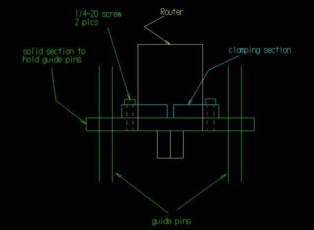

Chris...could you make that part of your carriage in 2 pieces? The top piece would have a hole for the router that was slotted so you can tighten it to the router. The bottom piece would have a hole for the router but no slot. This bottom piece would also hold your bushings that the pins run through. Then you put a couple of screws through both pieces to hold them together. I am terrible a describing this stuff...here is a picture. Hopefully this will make more sense.
By doing this your guide pins will be going through a piece of plastic that can't flex because you don't have a slot in it.

That might be an option but would take up additional material and space to fit it in. This is a Bishop Cockran knock off. here's another view minus the springs and plunge stop and cut depth adjusting knob.

Chris, one other thing you could try is to drill the guide pin holes with the "clamp" under tension. Clamp the router or something that simulates the diameter of the router in there and then drill the guide pins. Then your guide pins will always be in alignment when the router is installed.

Yeah, I already thought of that but I already have it drilled and I'd rather find a better material that I don't have to worry about doing that. I also have thought of just making it out of Aluminum which isn't that much different in price.
