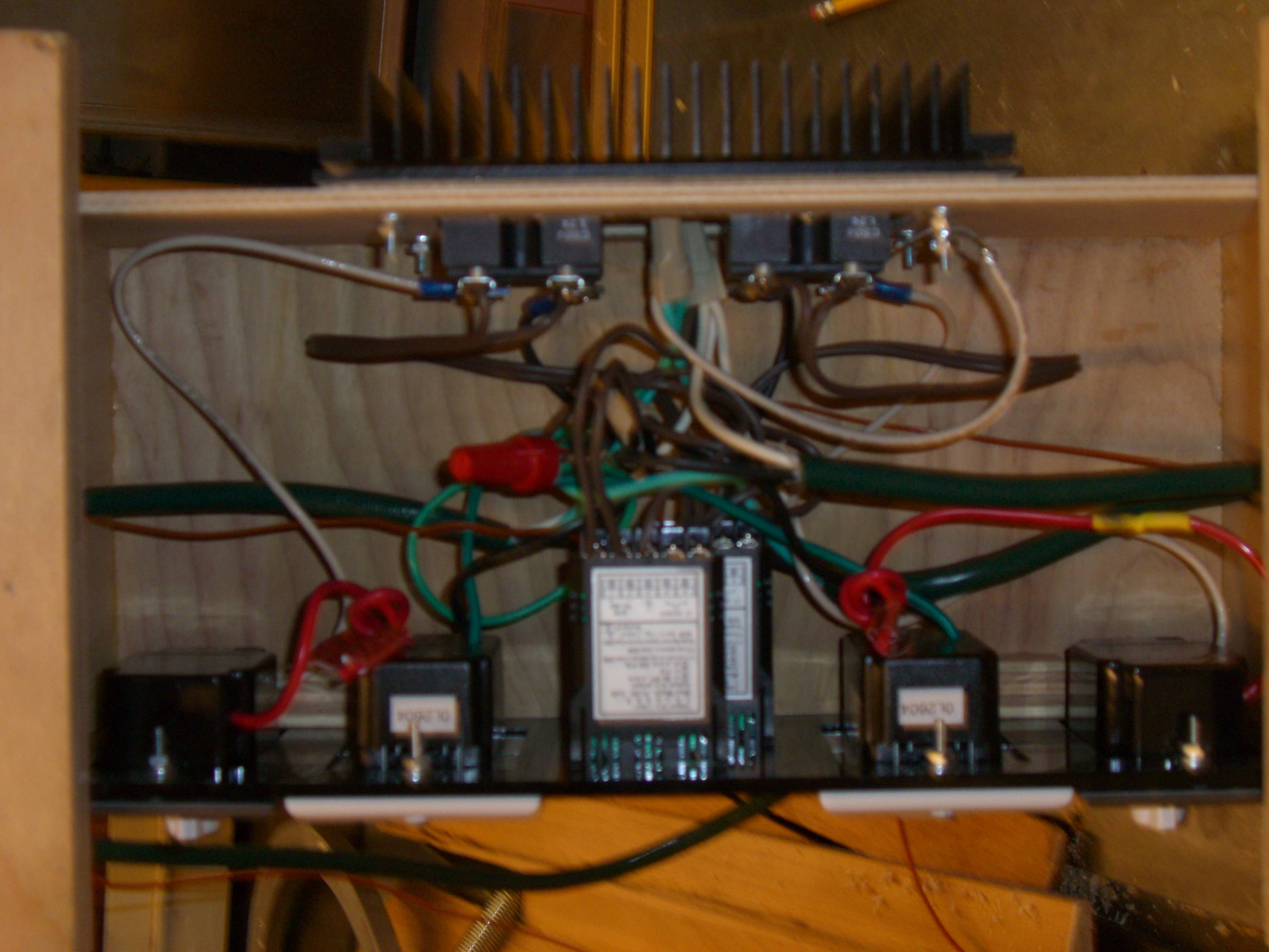

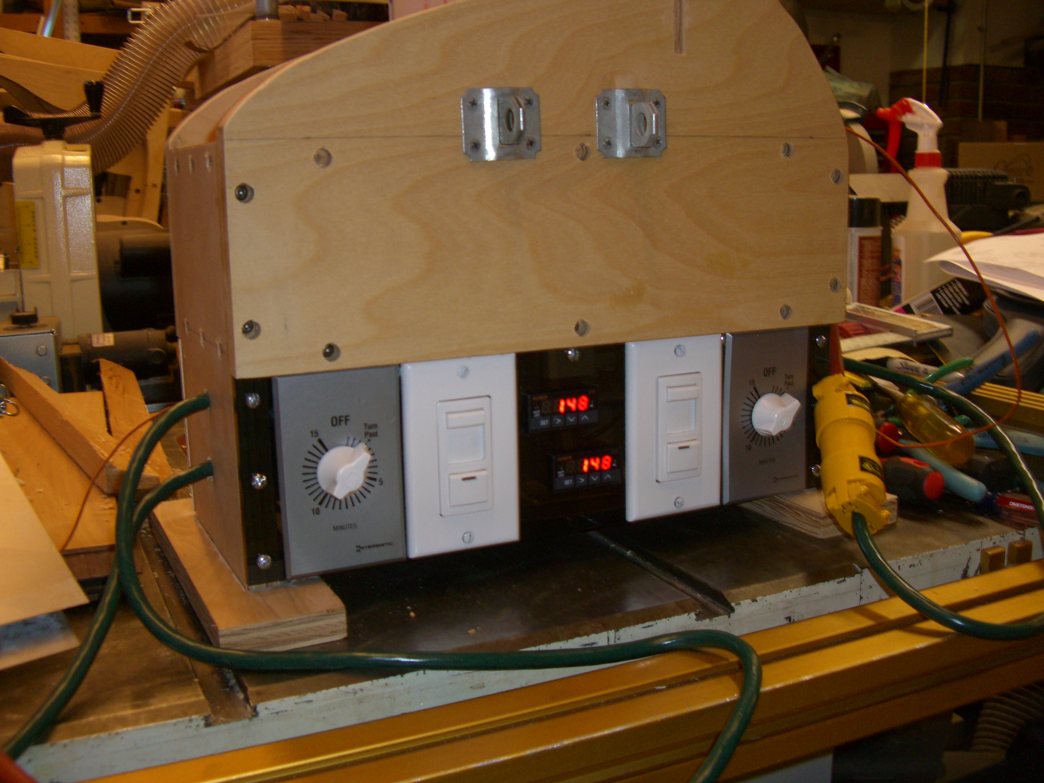

I want to thank all of you for the information posted in this thread. Most helpful!! It got me fired up to convert my Fox Style Bending Machine over to a temperature controlled rig. I found some different PID controllers on eBay (bit cheaper than the ones cited above). I made two channels, one for each blanket - either two big blankets in a sandwich or (what I have right now) a big blanket and a smaller extra blanket for doing cutaway bends. I cut the front panel out of some smokey acrylic sheet using my laser - didn't have to drill a single hole! :D

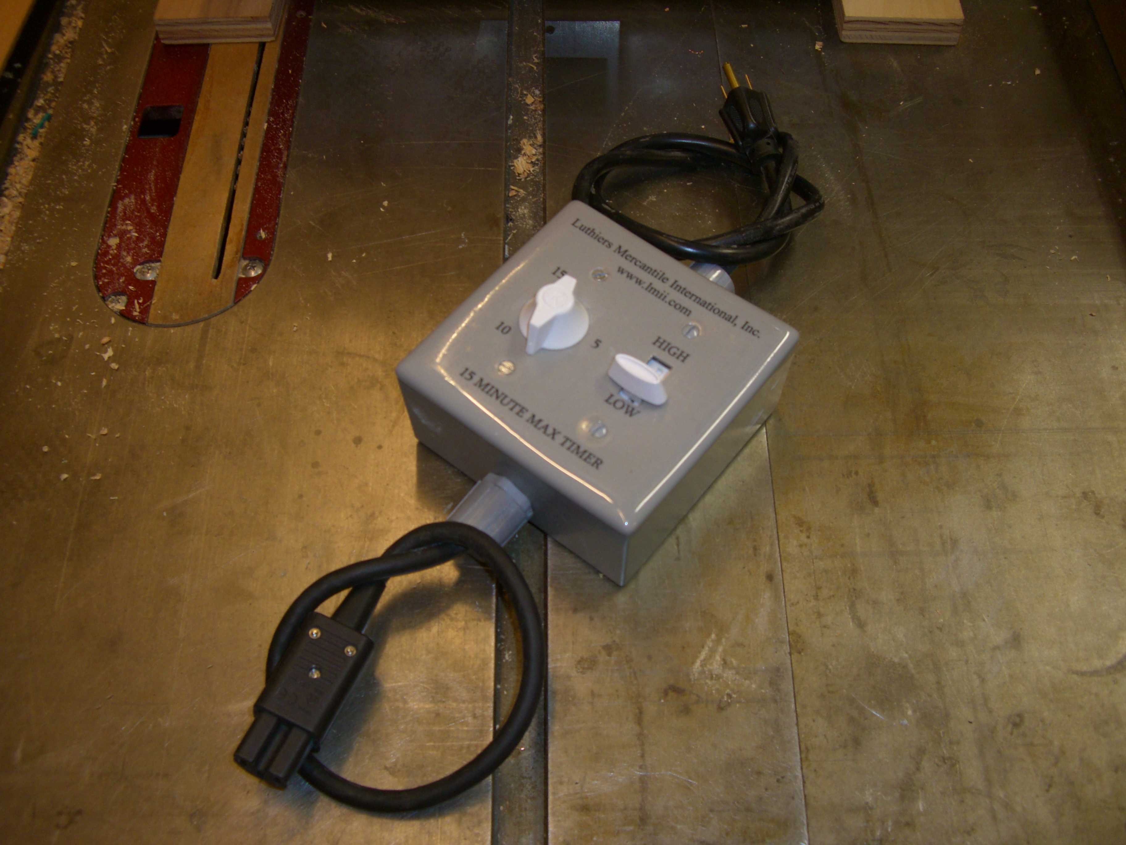

I put a couple of 15 minute clockwork timers and some 1KW dimmers in series with the blankets, but I found (after I had it up and running, of course!) that the dimmers really aren't needed at all. Also, I put the two solid-state relays on a substantial heatsink (from a local electronics surplus store) on the back panel, but found the heatsink really isn't necessary either! A simple sheet of aluminum for the back panel would have sufficed.

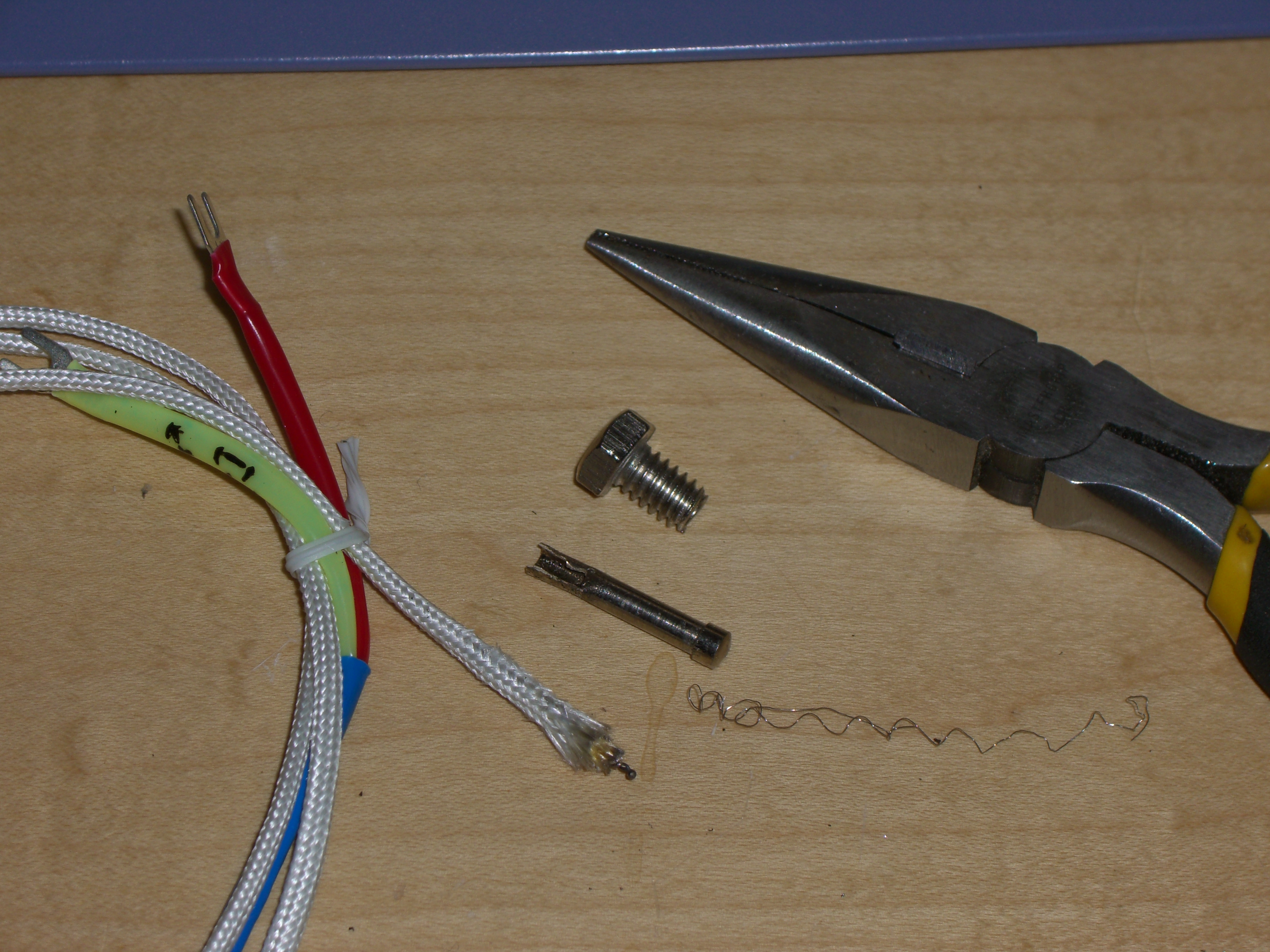

I didn't use the K-type thermocouples that came with the PID controllers - they were too chunky for my liking. I splashed out on a couple of Fluke thermocouples (they sell them as spares for their multimeters). These are much thinner/sleeker probes, and covered with Teflon.

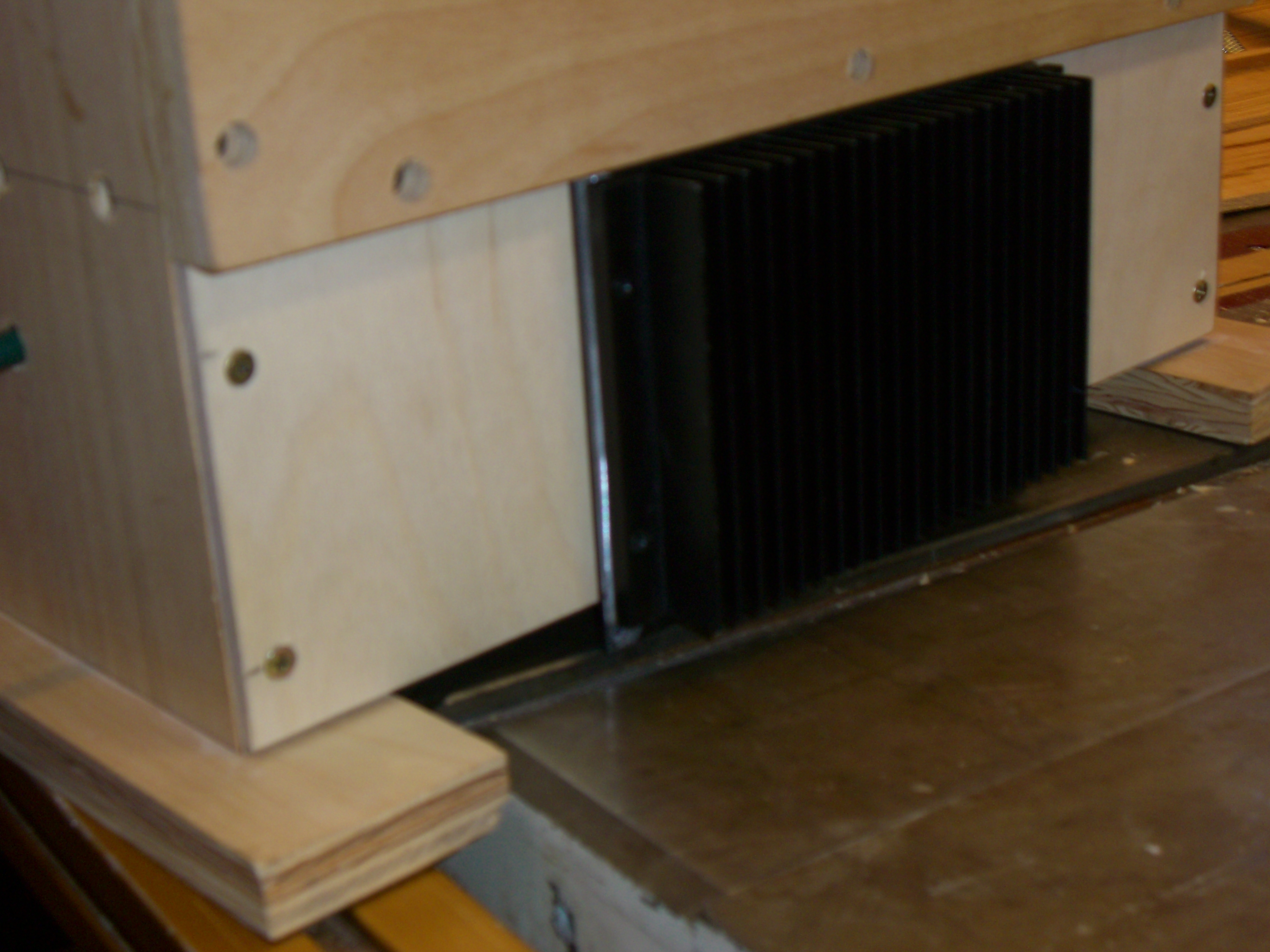

Here's a few pictures of my converted rig. Right click on them to see/download the high resolution version:
I put a plywood bottom on the unit after taking these photos, so it's safe from prying fingers. The auto-tune function on these PID controllers works beautifully. Like Nelson said above, it's interesting to watch them do their stuff! All in all I'm very pleased with this modification. Thanks again to all of you for pointing me in the right direction.

Actually a thermocouple is the contact point where the + and - thermocouple wires come together, I spent a large part of my working days as a controls electrician in a Chrysler auto plant, we made up the couples for the paint ovens from bulk thermocouple wire twisted together at the reading end and crimped into a stacon ring connector that was screwed to the oven wall.
I just cut the end off of the thermocouple that was included with the controller and twisted the wires together, it works real well and is dirt cheap as there is enough wire on the supplied couple to make 2.
The fluke meter temperature probes are also a good idea, if I knew I would start building guitars and need temperature control I would have brought a couple of them home when I retired, and even some thermocouple wire, we had miles of it.
One needs to realize that the closest contact point to the controller of the wires is the actual thermocouple, so this is where the readings are taken.

By chunky, I meant that the wire, including its outer sleeve, was too thick to put put in the SS/heating blanket/wood/SS side-bending sandwich for my liking. For grins, I disassembled the crimped bolt thingy that was on the end of the thermocouple that came with the PID controller. Inside, it's a normal small brazed thermocouple joint, so if you're happy with the thickness of the wire/sleeve, then you could use the thermocouple that comes with the PID controller for your side-bending sandwich.
Fred - Is just twisting the thermocouple wires together and crimping them good enough for a long-term solution?
I would be worried about the possibility of galvanic corrosion at the joint. Wouldn't the two dissimilar metals in the thermocouple wires create a difference voltage that will eventually lead to corrosion? The two wires of a thermocouple are normally brazed together to prevent air/moisture from entering as far as I can tell. Perhaps the galvanic difference voltage is too small to worry about? I'd be interested to hear what your experience tells you about this factor.

I also pulled back the outer braiding and just used the wire insulation and the twisted ends between the blanket and the slat. We used the twisted ends in crimped connectors on all applications where the walls of the oven temperature was needed. In some areas we were at 600 plus degrees and there was failure when the wire actually broke due to stress caused by heat and vibration. We were required to change these out as required by the ISO standard, in areas where the actual air temperature was measures we used the wand type Thermocouples that were exposed to the air flow.

I am putting together the parts to build one of these heat controllers. The insulation on the supplied thermocouple is really tough glass fiber that resists all my cutting tools. Any secret tricks to cutting this stuff?

Barry, I cut the glassfiber strands with an ordinary pair of sharp scissors! Perhaps yours is made of tougher stuff?

I think its the same thermocouple as shown in the photo. The glass fibers were tough and a little bit slippery so they just slid out of the sciccors as they were closed. I ended up using a pair of razor sharp snips that worked pretty well.
