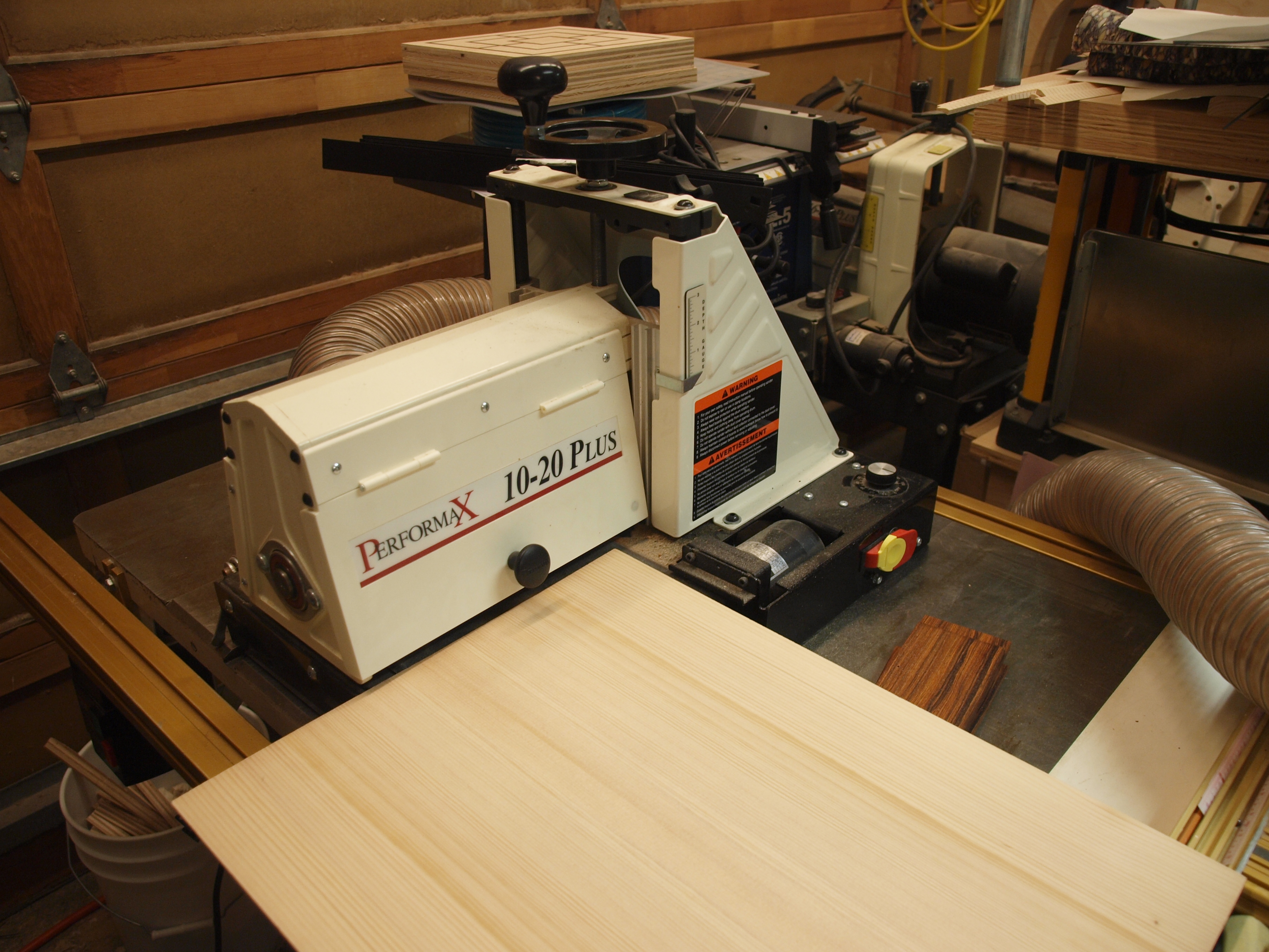

PostPosted: Sun Nov 30, 2008 10:23 pm
Posts: 1567
Location: San Jose, CA
Last Name: Fifield
City: San Jose
Zip/Postal Code: 95124
Update: I borrowed my buddy's 10-20 and did some comparison sands. It's a little bit better than the 16-32, but not a whole lot! The buyer for my 16-32 evaporated, so I guess I'll just have to soldier on with it for a while yet. It's not terrible, but does leave snipe ridges at each end on its way out of each sanding operation. I have to spend time with a scraper and/or orbital sander to remove them, but usually they are outside of the guitar pattern, so not a real big problem.
Here's a shot showing my buddy's 10-20. You can see my 16-32 in the background (with stuff all over it):
Cheers,
Dave F.
Cambrian Guitars
