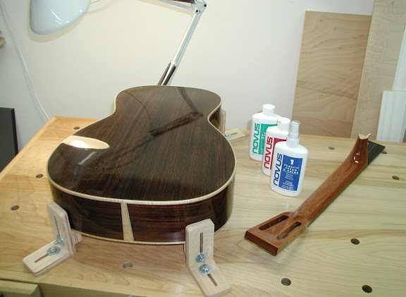

phil wrote:
dave,
when you polish, what do you follow the 0000 steel wool with? micromesh? or car polish compound? or something else?
phil
I got pretty good results polishing my Tru-Oil finish with Novus plastic polishes. The Novus #2 polish brought out a nice gloss in the Tru-Oil. I polished it by hand with the cloths that Novus provides in their kits. You might want to wait at least a few weeks for the Tru-Oil to completely cure before polishing. My Tru-Oil finish took weeks before it no longer smelled like solvents.
Ray
