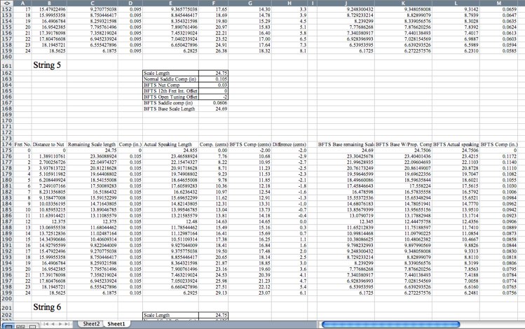

Considering the use and practicality of equal temperment in standard tuned guitars, I started measuring and calculating cent values for any given semi-tone and arrived at miniscule dimensions that make a difference in pitch, but are really hard to compensate for.
Given the build specs of one of my commissions, I decided to try to exact my intonation and dial in a more accurate scale layout. Checking some of my calculations against manufactured instruments revealed a surprisingly high level of inaccuracy. First of all, I will say that most people can't tell the difference in 3 cents off pitch, Unless I had the tuner in front of me pointing it out, I can't tell either. But what I did determine from testing these other instruments with a greater discrepancy in pitch was a complete difference in overall tone and sound of each guitar. This made me wonder and figure that among the various characteristics and approaches each builder utilizes in the construction of a guitar, this factor also adds the trademark sound and tone to different guitars. Intonation practices and the method with which frets are marked and set allow for subtlies in tone. Several innovators on this topic have devised methods they feel are more precise, but require extensive work to the nut and saddle, some even the frets themselves.
Now I could just be wrong, but I checked this formula against several brands and found they all varied flat or sharp by as much as 7 cents off,
depending on which fret it is, you may not be able to compensate to pitch. One cent being 1/1000th of a semi-tone is pretty hard to evaluate and correct. I doubt seriously if any of this is even relevant to playing and building a guitar, but I find myself wondering how I can cut any more accurately than I do. Not that I'm concerened, I think my practices have born decent sounding and close to pitch instruments, so in other words, everyone that builds a guitar is apt to have a different tone escape the box and I think this has a little to do with it. Could be that a little fall off "flat" translates to a woodier sound, and a more bell like chiminess is "sharper", maybe it's too early in the morning and my coffees' cold again.
I know that construction and bracing, top thickness and such all are more contributing factors in individual tone differences, but I think this could have a little to do with certain tonal variances.
Anyone want to measure out their frets after the fact and see how they run as compared to the measurements given for that scale?
I spend a good deal of time on this part of my builds, any comments on how others view this and their methods of installation?

Those are very good points Michael, I have been using a peterson 490 strobe, and you're right the accuracy is claimed 1/10th , which is close enough, but my thoughts were on common practices in just how close and by what means others go about referencing fret locations.
Lately here in my area I have had a number of people jumping on the intonation wagon, asking for finer tuned isntruments and talking about equal temperament and the flaws in this system. Seems there are so many variables embodied in the guitar as a whole, this is just an impossible notion.
But it prompted me to research the feasiblity of spot on pitch, and I 've determined these folks need to play a different instrument. I have come up with a method that works very similarly to the Feiten system, or Earvanna's method, but still it requires about 48 hours more work and several hundred dollars extra just to make it worth my time.
Grand Concert Piano, that's the only place you will find this type of accuracy, and only if it's tuned properly.

To add to this information, let's assume a guitar is reading 7 cents off at the 12th fret of a 24.9" scale. Knowing that the correct "in-pitch" measurement to the 13th fret is .699" or 45/64" , 7 cents off then equals a discrepancy of .048" or 3/64". That's why I posted this, to see how critical others are about spotting the frets and maintaining that scribed mark as measured. Even given the equal temerament of standard guitar, it's not hard to be off by quite a bit as you factor in cutting and marking.
I scribe my fret marks and then cut initially with a saw width of .008" and afterwards resaw at .023" for the fret fitting, after chamfering the slots with a small file. Otherwise I can't see the scribe under the .023" saw blade.
Maybe I'm anal about it, but it works for me.

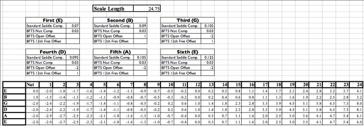

On a different note though, I have developed a scenario and working test model for what could be charged as a finely adjustable intonation system, after doing a bit of comparing and R&R I settled on this set up. I will have it
fully equipped on a new guitar here soon, so I'll post some photos and results soon. Have to do the legal stuff first. I might add too, this was a well paid venture for me, some folks very curious as to what I'd come up with.
