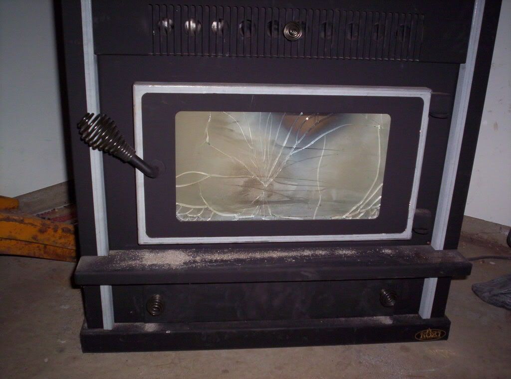

I live in Wisconsin. I build all year. The RH% is usually around 50%. I use an air conditoner in the summer when the humidity is 100% and in the winter I have a pellet stove in the shop. The RH% is around 40% with a humidifier. The glass broke on my stove about 6 weeks ago. I'm still waiting for the dealer to replace it under warranty. What a joke. So anyway I had to bring all my paints (I do airbrushing and taxidermy too) and glues and whatever in the house until it's fixed or warm enough..so for the past month it's been 10-40 degrees in my shop. Being cold the RH is the same, around 40ish with no humidifier. The only thing i've gotten done in the last month was sanding fretboards and reading past forum notes. On a lighter note, my wife was wondering when the guitar building obsession levels out.....LOL..shes trying to find a way to make money off styrofoam peanuts and cardboard boxes.
I'm lucky my shop did'nt burn down.

Jason - not so much a question but bummer about the stove!
