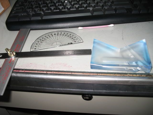

I have a "gobar deck", I have a rack I hold stereo equipments that doubles as a gobar deck. I think I might use something like cards or cardboard or something then use threaded rod expander as the clamping device. I can't use the fiberglass rod because it's expensive as hell to ship them here, and even then I only have about 7 inch or so of clearance on my stereo rack (I can adjust the height of individual shelf freely but that means I have to remove my integrated amp which weights half a ton along with some other equipments and the bottom shelf is free so..) so a bent fiberglass rod probably won't work too well.
By the way I did make the following tools:
I made a sliding bevel because I can't really find one around here (I know they're available but they're a little expensive and I just made these up in a jam...) by taking two rulers and drilling a hole in both of them and insert a wing nut between them, then used the protractor to set the correct angle. Sometimes it's amazing what some simple school supplies can do... Also, I found this piece of acrylic that came off of some cigarette POP that has the exact 5 degree angle of the back of the guitar. It's weird but this is very useful for supporting a router for routing the binding but I can also make the angle on the heel and tail block by using a robo sander and using this to sand in the proper angle.

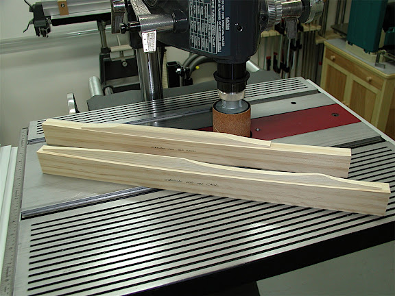

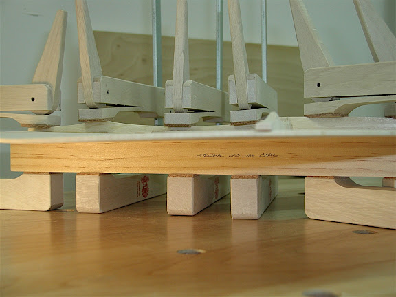

Thanks for the advice. Here is what I did today: I traced the back bracing pattern onto the back, then tried to dry fit them on with only cam clamps. I don't want to make any mistakes here so I went ahead and made a clamping caul. I traced the bracing underside onto a piece of plywood then cut them out with a jig saw and finished with a drum sander, then taped sandpaper onto the brace and smoothed them out. Here is the caul in action:
I did both sides, I traced the top brace on one side and the back brace on the other side so I can get two uses out of one caul. I think for the X brace since I don't have a large cam clamp (they are heavy, shipping them to Taiwan would be unreasonable) I am either going to make a "clamp" with 2 long sticks and 2 threaded rod to reach the middle, or make a few expanders and use them in my "go bar deck"
I glued this brace in with hide glue... hope this thing holds!
Here is my "go bar deck"... (an acoustic guitar is placed inside for reference)
