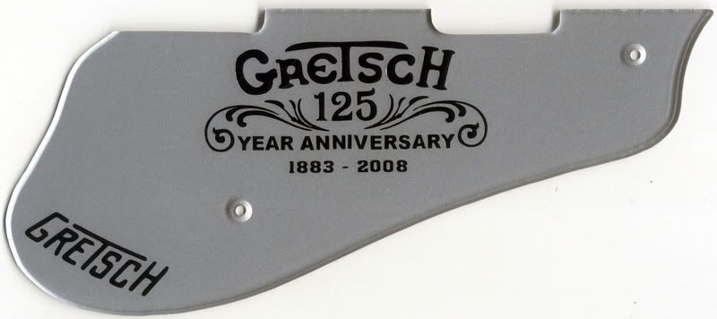

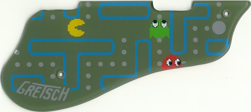

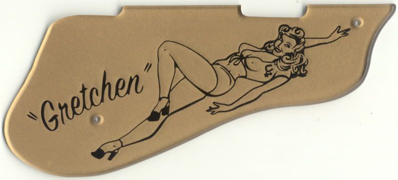

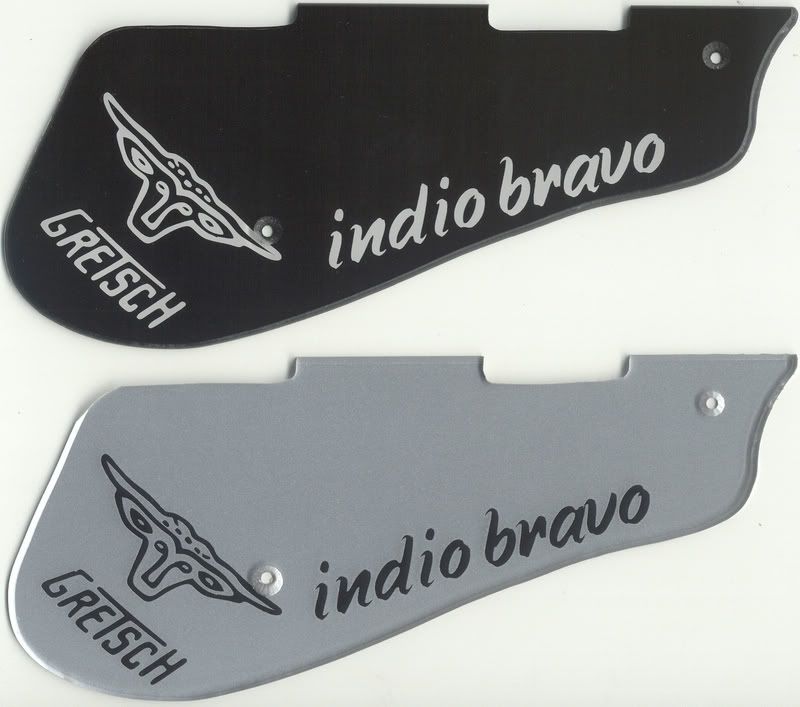

Mr Hodge: consider using water-slide decals. These can be bought in 8x11 sheets and can be printed using a laser printer or ink jet.
In the Gretsch community, its is very comment for the guards to be decorated from the back side with a waterslide. A solid color paint can be added for background.
Here are a few from Paul Setzer. Most have a western motif, but I think you can get the idea.
Joe
