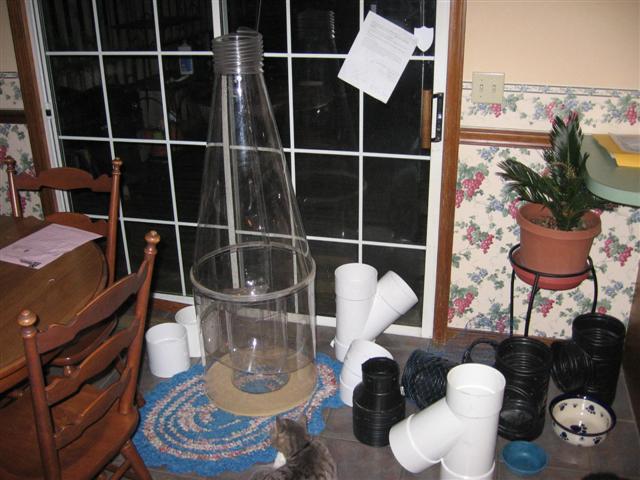

Sorry, I just had to share this. My new one just came on the UPS truck. Amazingly, my wife hasn't said a word.....
I suppose I should slip this stuff out the door and down to the shop?
Thanks Ed!

If I brought *THAT* home, I would have to move out.
I dont know if that is a cute daughter, or a mighty lucky son. Either way, they make a handsome couple!

Brock this is the 1800 ClearVue. The Mini is great for clean up and small tools. Remember I do a ton of resaw on that 18 inch Laguna plus lots of sanding on the 25 inch Dual Drum General. Dust is killing me, literally. So, beginning tomorrow, I'm trashing my 1500 CFM Delta Bagger and putting the 2HP motor and impeller blower on this baby. Also, I'm ducting the exhaust outside to release any microdust into the wild. If the 2HP won't cut it, then I'm saving up for a 5HP.
