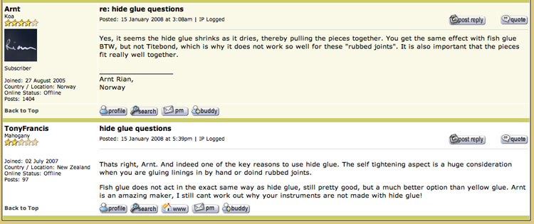

[QUOTE=Hesh] HHG has the ability to draw the two halves together too, even though you still should be clamping them, and FG or Titebond can't do this.My choices for joining plates are in this order:1)  HHG2)  FG3)  Titebond/LMI white
Hesh, Fish works just the same as HHG and draws the joint together as it dries.

OK I stand corrected.  Where it came from was this series of posts that happened a couple of days ago and the thread ended, for now, after the last post.  This led me to believe that the clamp effect is exclusive to HHG.

Sorry that came out so small and difficult to read.......
