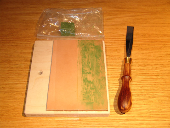

I have an LMI 18mm that just fits my hand very well and holds an edge for a long time.  Just as important it just feels right to me and I do have other chisels too, some pretty high quality, but I like this one.
So I use it all the time and in doing so I am probably a better carver with it.
It was also the first chisel that after sharpening I was able to experience a chisel sharp enough to pop the hairs off the back of my hand.  I think this speaks well to the steel used and what Mario said about good steel being able to be sharpened sharper then lesser steel.
I was stropping it several times a session on my 8000 stone, dry, until JJ heard this and took pity on me.  So JJ sent me a surprise that he made for me to strop on and I am looking forward to using it.  And yes JJ bro I WILL take the tape of the dry side before using......
