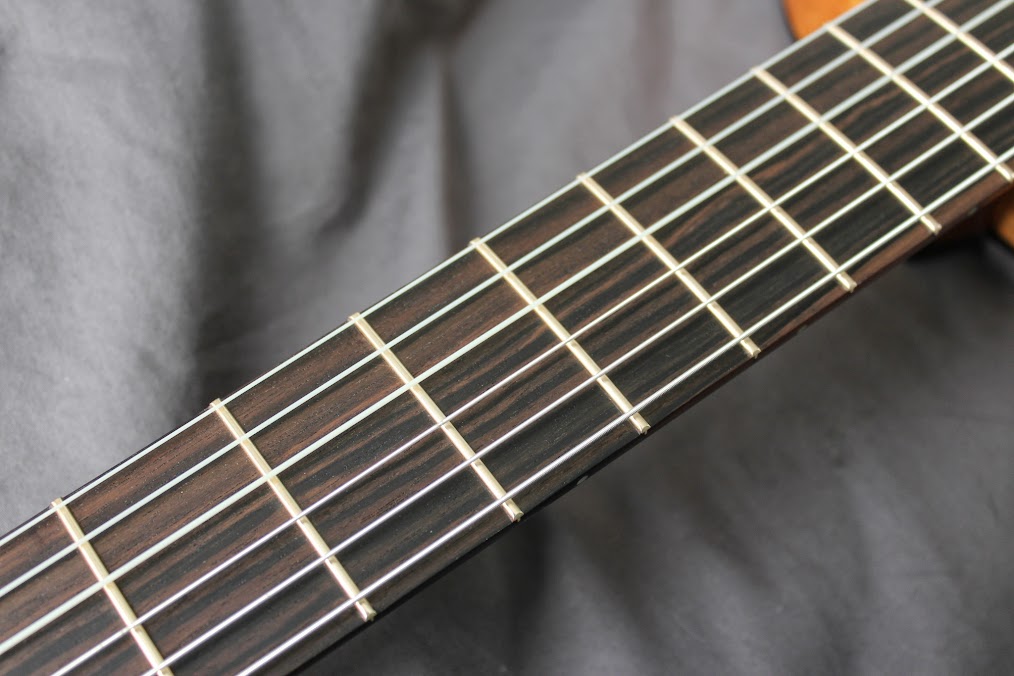

Crowning the frets after leveling.
After gluing the fretboard extension, a quick buff with steel wool and oil to make the ebony look slick.

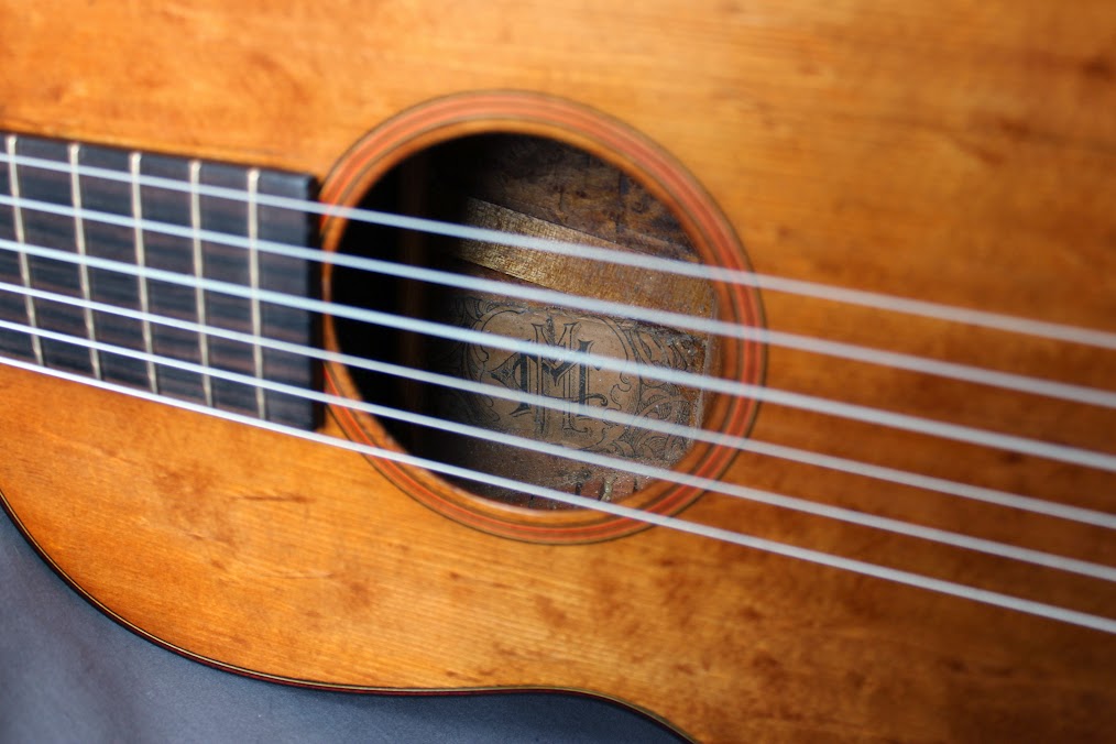

They certainly look like they're some kind of cousins. Mine had a different fretboard with star inlays and no binding.
Any guess about what the label might point to? Letters are "C" "M" and "M".
Thanks!
