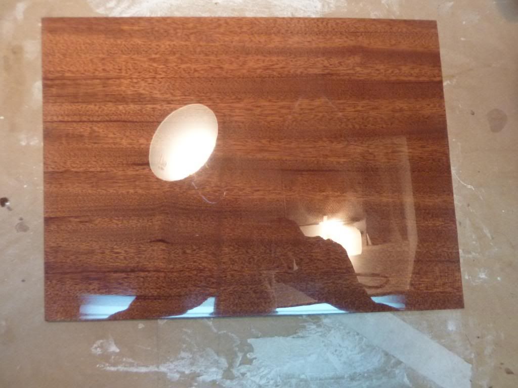

Here's an example of what I ended up with. This was level sanded with P600 then I shot 2 coats of PolyWhey thinned with about 5 to 10% distilled water. After drying for 6 days I final sanded with P1000, P1500, and P2000. Final sanding was wet with mineral spirits. Finally I polished with Novus #2 and buffed with an ROS buffer pad. I don't have a buffer yet. I'm plenty happy with the gloss - as good as I ever got with EM6000, fewer coats, and less work.
I could see some witness lines when I started final sanding but they seem to have vanished - for now ;) Also, the drop fills that I did are completely blended in.

How many coats total?

7 coats total IIRC. I'll check my notes tomorrow and write down the finish schedule I used; it was pretty typical for a waterborne finish though.

Not necessarily the way I'd do it next time but here is the schedule I used. I've posted most of this in pieces so I'm just kind of collecting it here:
1. 1 coat ZPoxy fill then sanded back to wood with P220. I hadn't used ZPoxy before and next time I'll probably do 2 applications; I had a few pores that didn't get filled.
2. 2 coats of 2# blonde shellac followed by a very light sanding with P600 then wiped with a damp cloth.
I sprayed with a Walcom EGO HVLP gun set at 2 bar (29 PSI), product feed at 2 1/2 to 3, other controls wide open (per manufacturer recommendations). Temp was between 65F and 70F, relative humidity between 40% and 45%.
3. 4 coats of unthinned PolyWhey at 2 coats per day about 2 hours apart. Lightly sanded with P600 after the second coat. Wiped with a cloth dampened with distilled water after sanding.
4. Level sanded with P600, wiped with damp cloth.
5. Sprayed one coat of unthinned PolyWhey and then contacted the manufacturer about maybe thinning the product as I was getting excessive orange peel. The next day I sprayed 2 coats of PolyWhey thinned 5 to 10% distilled water. The thinned product sprayed much better through my rig as I got a much smoother finish. I did some drop fills in a few areas.
6. After drying for 6 days I final sanded with P1000, P1500, and P2000. Final sanding was wet with mineral spirits. Finally I polished with Novus #2 and buffed with an ROS buffer pad.
Check my OLF Challenge thread for more photos and, in a few days, some photos of the finished guitar.
So far I like this product and I will use it again. Of course only time will tell if it will be a long-lasting finish. Next time I'll thin about 5% or 10% with the distilled water to start and probably spray 6 coats, level sand, then spray 3 final coats. I'll probably do 3 coats per day about 1 1/2 hours apart since it dries faster when it is thinned.
Steve Smith

Steve is providing much more information than can I at the moment since I'm just brushing on to a single board. Never-the-less here's what I got:
This morning, after allowing more than two weeks of curing, I sanded out my test piece going from 320 grit up to 2000 grit. Then I buffed it out only using the fine "white diamond" bar from Lee Valley. Finally I hand buffed it with Novus 2 compound mostly to get rid of the specs left by the previous buffing. The following pictures show the results in various lighting situations:
I think it buffed out nicely and it still does feel harder to me than water based finishes I have used in the past. It has also been very easy. So I am thus far impressed. The next phase of this test is to let it sit for another couple of weeks to see if I see any sign of further shrinking. Then I will attack it physically and chemically to see how durable it is. I am becoming optimistic that the stuff is worth testing on a guitar. I'll keep you posted, and thanks Steve, for showing your results. Your guitar looks good.

Pat, that's good info and I'm thinking the more folks that try this the better. I agree with you that it is easier (than EM6000 in my case) and buffs out nicely.
I'm hoping someone will spray something real dark as a test. I might do it after I get this guitar done.
Some more observations:
1. Recall I waited 1 week to buff (gotta get it done for the Challenge), I'm seeing some more shrinking on the top - getting a tiny bit of corrugation. Ideally I think it would be good to wait at least 2 weeks like Pat did or even 3 or 4.
2. Finish will bubble up if you apply too much heat (just like other finishes so not a big surprise). I did this when heating the area before re-gluing the bridge. Fortunately you can sand it back, repolish, and recover somewhat. It can be seen but not unless you look close. I will probably try to touch it up later just to see if that's something we can do with this product. This isn't the first time I've done that on a repair - I think it's time to move the heat gun to the other shop and get a hair dryer down here. :?
3. On the BRW headplate I'm seeing a very slight bluish tinge - this is under fluorescent T12's and high temp fluorescent task lights in the shop. Outside under a gray sky it looks fine. Haven't had any sun yet so don't know how it looks there. I don't see this bluish tinge anywhere else.
4. Finish will crack if it is stressed too much. I pressed in a tuner ferrule and hole was undersized which caused a couple of 1/8" or so cracks in the finish in line with the grain on the headplate.
