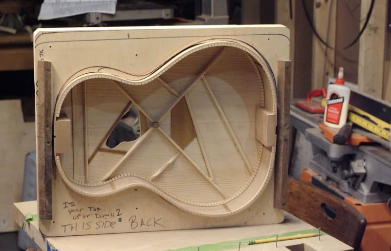

It's my take on the Contreras "Double top." Which to me, was the first DT out there. First presented in 1974 the idea was to isolate the vibrational movement of the guitar from the players body by using 2 tops and a suspended back. The first looked like this-ish.
http://www.manuelcontreras.com/index2.html
Click the "models" tab. Then the 1st Class Classical Concert Tab. Then the 25th Anniversary and it'll scroll through a few pics of Manuel's fathers design. I've basically just enclosed the back plate and added sound holes for it to breath.
Yeah Haans,
Thats the back. Here's the front.
I was stuck as I had closed the back up so tightly that the air chamber between the 1st and 2nd backs wouldn't allow for any vibrational movement. I was warned about the possibility that I was limiting the movement of the back but I refused to believe it until shame and the truth of it actually set in. I would tap the top and nothing would happen. Nothing!!!
So now there's 2 voiced pieces of spruce that move and compliment each other correctly. I may need a couple of more holes yet. My volume is still a little limited.

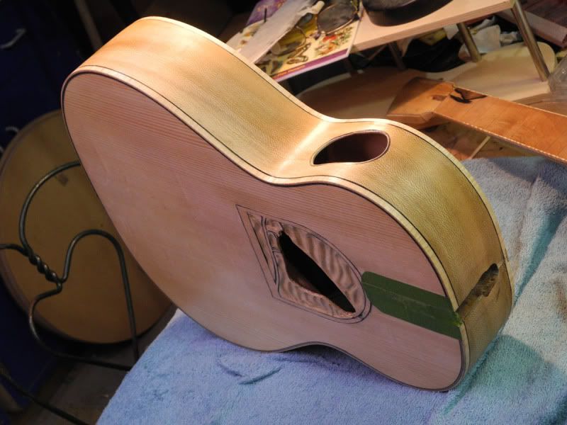

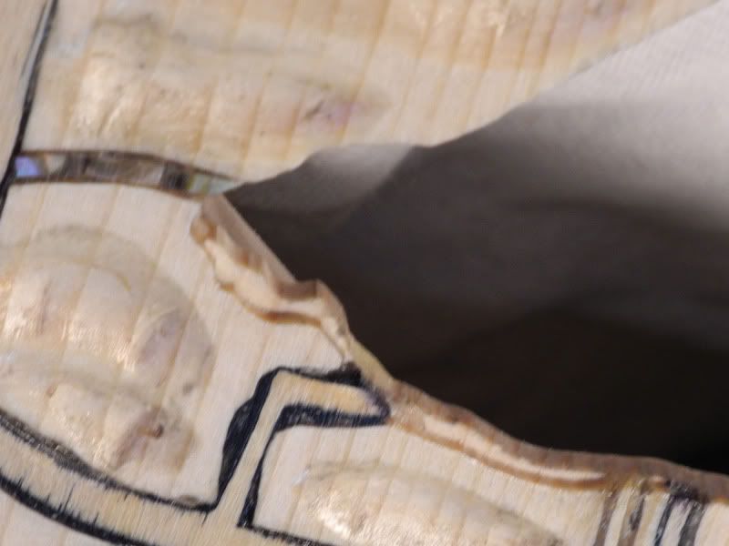

Here is build #2 "the Butterfly" I am half wayish on the French Polish. Western Pa Sycamore I rescued from a burn pile a few years ago, the top is Adirondack with some great Butterfly Claw. The sound hole is a Monarch butterfly shape, a silhouette of a Monarch attaches with magnets
I dug out the waves with a dremel on a stand to control depth
my pricey sanding tool

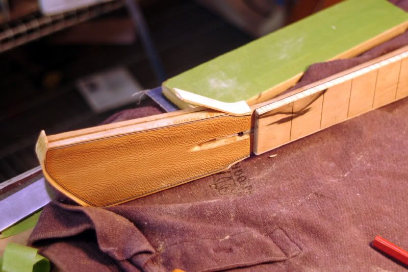

Rock or Steel Maple for the neck, the back plate is 150 year old Wormy Chestnut

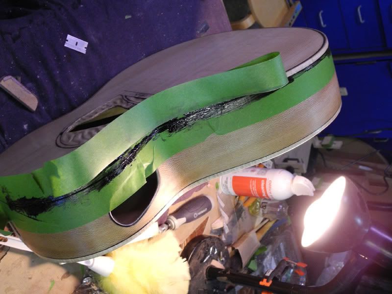

I found Binding to be the toughest oops to deal with this time. I miscalculated the black line and had to recreate it with super glue mixed with Grit Laskins black powder ( that looks mysteriously like Copier toner!)
I ended up sanding "the frame" Would it still be called a Rosette? I also replaced the antenna with Abalone

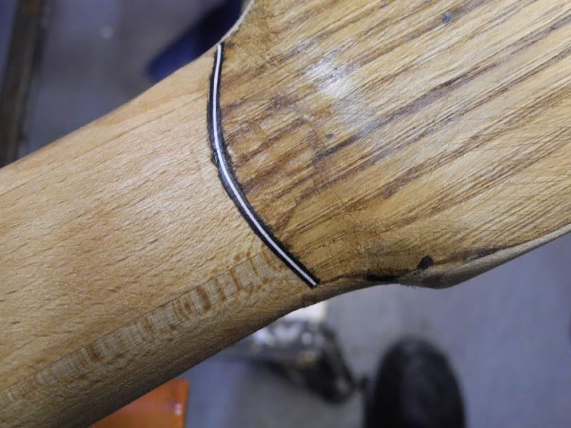

White oak 12 ready to button up...
