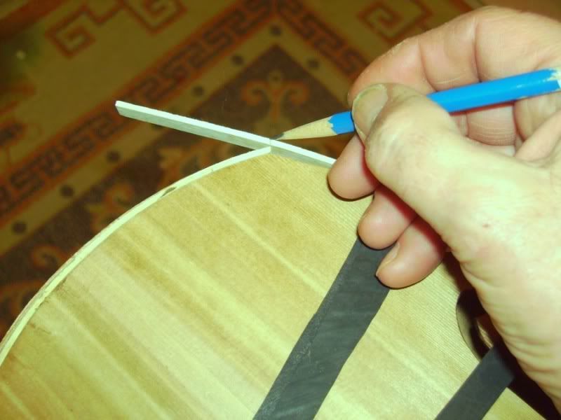

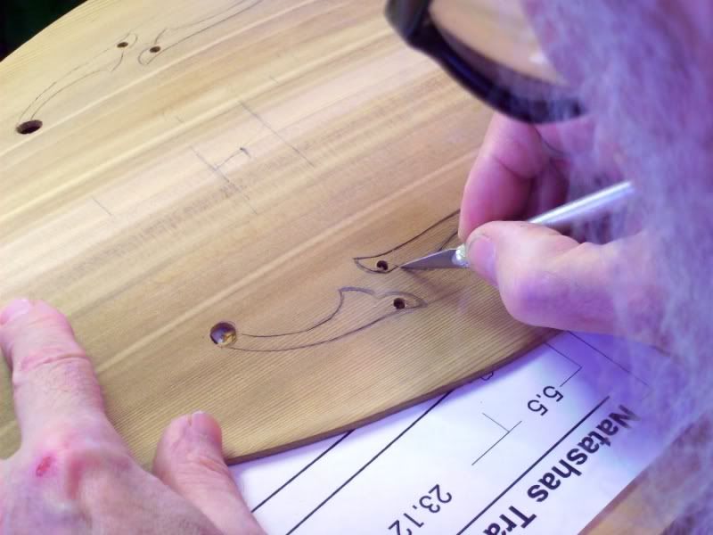

Cutting out the 2 part F holes.
Routing out the truss rod slot.
Normally the bracing would be done now but because the profiling will change with the flexing down and gluing of the top it was left till after the clamps came off.
The bracing has been scribed, cut, fitted and installed. Unfortunately most of the pics of this process fell off the truck. Oh well. but here you can see me using carbon paper to mark were the braces need to have a talking to.
Yes the bracing is a bit thick but then this is cedar which was tooled down to about 1/8 in the recurve area and 3/8's under the bridge. So ...beefier bracing.

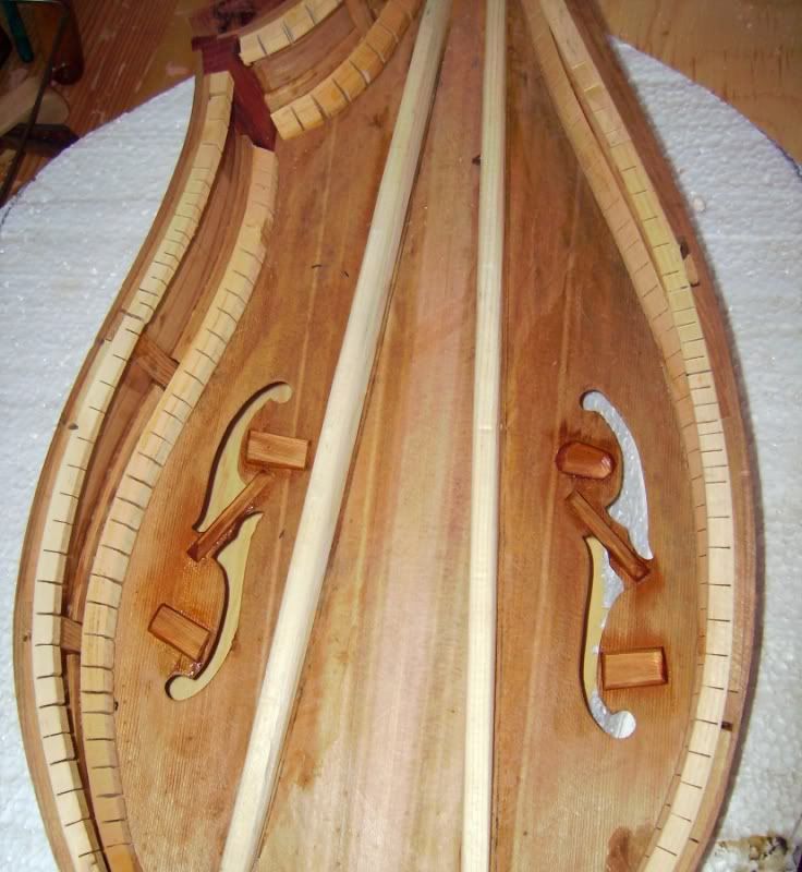

Ok here is the pic with the 8 braces...This style of F holes me got from Steve Stevens a while back...modified them to make me even happier and started using it as me signature and found out that they needs back braces to be happy especially if me keep takeing the recurves down to less than 3/16. But then me never really played it safe in me life...well...only when it comes to building houses schools and banks which me don't be doin no more...especially banks!
Ya, she may be ugly on the inside...just like some people around here, but look at all that wood...thick braces, double lined re enforced ribs, heavy duty kurfed lining...with cedar top thats only .110 in the recurves and .180 max under the bridge. Same for the back plate....Gee you would think this is a travel guitar thats really meant to go travelin ...well ummm ya ~ It is.

First things first: I like that comment about knowing more than you used to know, but forgetting faster than you are learning. It's funny, and it's insightful, too. It's a phenomenon that is probably happening to all of us.
Okay, next, about those braces: I fully understand those skinny little braces between the halves of your f-holes, but I've got a hunch those other braces at either end the f-holes aren't necessary. Of course, they probably don't hurt anything, either. Furthermore, as this is your instrument and not mine, I think you should do it any way you want to do it. I am just commenting here, and...you know...free advice is always exactly what you pay for it. So don't pay too much attention to my free advice.
I like your instruments, your experimental and artistic design sensibility, and most of all I like your sense of humor about yourself!
Patrick
 Post subject: Re: Travel Guitar
PostPosted: Tue Feb 08, 2011 8:54 pm
Posts: 1982
First name: duh
Last Name: Padma
Ya well Partick...experience has tought me that for this style of "F" holes, braces are absolutely necessary especially when taken down to .110 or the bridge between the two halves cracks or the wings break off. This situation is a trade of off looks for safe design function...what can me say ...me ego is going for the looks and so me brace to compensate.

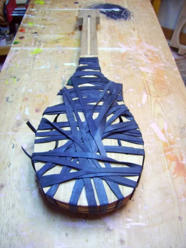

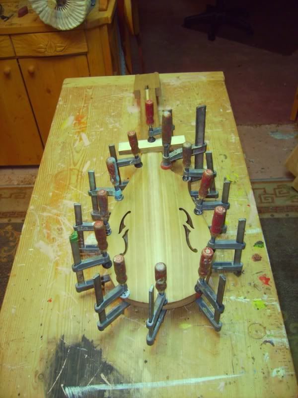

Signed the plates , glued in the sticker, wrapped her up and put her to sleep for the night
Maybe I start the banding in the morning or maybe me work on the Easter Lily and get her closed up too. Ya better do that and then me can band both at the same time.
Yup inner tube..but ya gotta really appreciate were the stuff comes form.
Like BIG Truck tires 18 wheeler jobs is supper thick strong rubber
15 or 16 inch tire tubes good solid rubber
12 or 13 inch is thinner again and more stretchy
and bicycle inner tube is both thin and much more stretchy
Depends on what me doing as to what me use.
blessings
duh Padma
PostPosted: Fri Feb 25, 2011 6:52 pm
Posts: 1982
First name: duh
Last Name: Padma

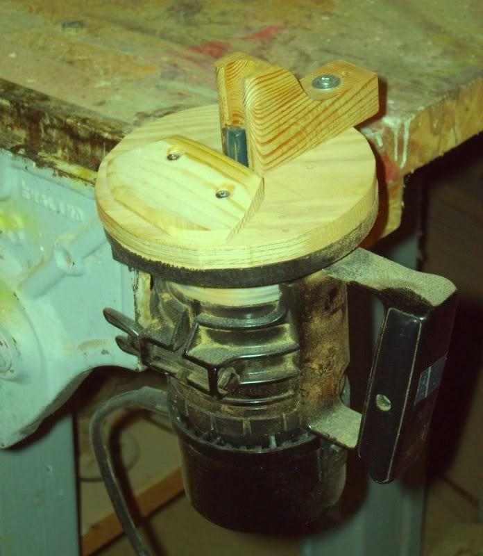

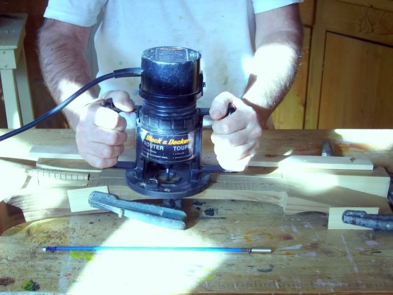

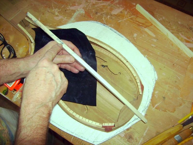

Rabbiting for the Banding

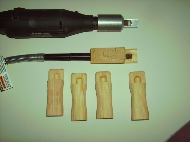

well me first rough cut the rabbit with this old Black and Decker held in the Recorder.
Then used this little attachment on the Drememl to clean up the rabbit.
Here you can see some home made attachments that do the same thing but fit on the dremels pencil extension.....much easier to control

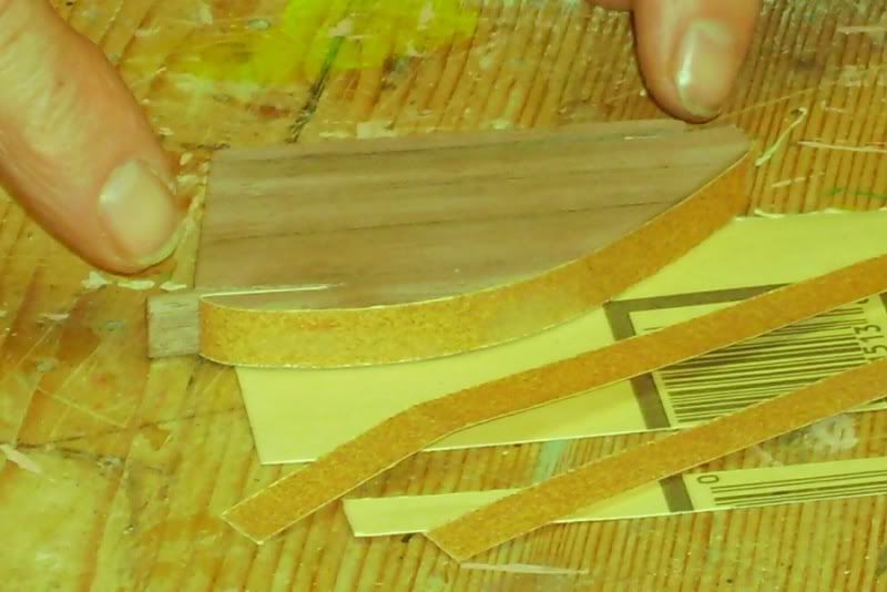

Me then made a sanding block.....
To clean up the rabbit.

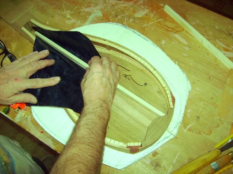

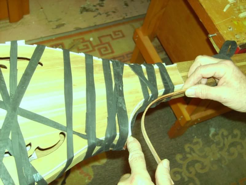

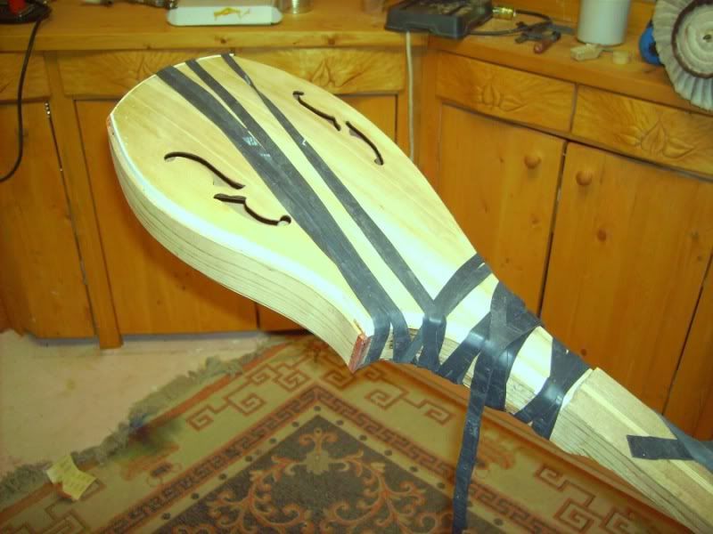

Banding
Ok here we start the banding...
Was suppose to be using Paduke...but me was not having any success in bending it so moved over to Sirari, a very hard South American wood that is easy to bend and kinda pinkish in colour.
Here you can see the bent sirari and white holly from Jesse Burge, and the assortment of tools needed for this operation.
He be nice pic of me with a loop for too be eyeballing the edge of the chisel that is really a scraper for cleaning out the glue after installing the holly. (Actualuty me using me X Ray Heat Vision to Cosmically re temper the edge. But please, don't go and be tellin no body, you know what they do to people like me!)
Ya, her tap tone is sounding gooder.
Will post again when the Sirari has been installed.

Quite a nifty little curved sanding block you used to clean up those binding channels. I really like the little wedges for securing the sand paper strips. Wish I had thought of that. Well....like so many things in life, it seems very obvious once someone else points it out to me......
Patrick

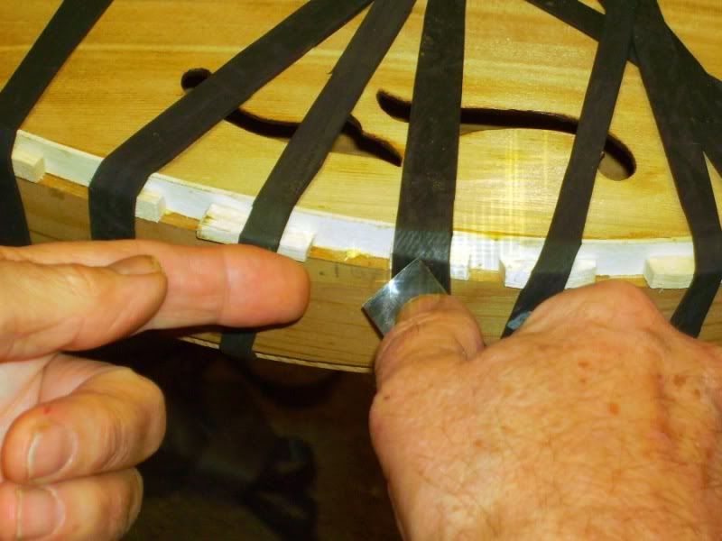

Here be pic of the rejects...there were more but kindling was needed for to start the stove.

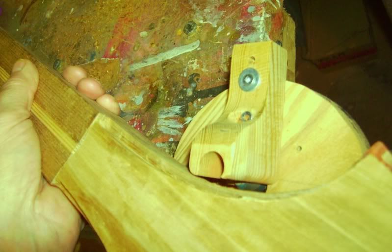

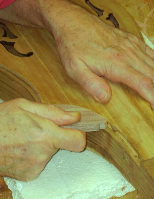

Glued in the heal block of coco with some sap edge, or maybe it's a chunk of Black African...same difference. Me think this piece came from Ron.
Try out fit and fidget.
Here is the finished banding before the clean up starts.
Here you can see the scallops in the ribs. This lets me know how much me can sculpt away from the banding and the ribs. Is about 32nd of meat left and its break through to the lining. Don't wanna be doing that.
Rough sculpting of the ribs on the belt sanders wheelie. Really gotta keep the box moving or me could cut through to the lining. Did me mention me don't wanna be doing that. No! Then its on to final shaping with a bastard and scrapers.
Scraping her down. You can now really start to see the rounding over of the ribs and get
a feel for how the instrument gonna feel all rounded over, full and voluptuous.

Ooh, looking very nice. I love the rounded edges. Always bothers me when people leave them all squared off. Arm starts to hurt just imagining the edge digging in.
Heel cap is excellent as well, especially with carving. Looks like blackwood to me.
Hope you can get us some sound clips of this baby before she goes off on her world tour :)

Glued on the fret baord, and headstock with holly and sirari. Black wood cover plate and nut. Zerro fret added after me level the other frets.
Shaping the neck...10~ 15 min max.
Here she be ready for sanding. Nice day....may sit on porch and sand her down. Might even get a flash coat or two on today.
Heres a shot down the neck showing the twist in what appears to be the neck but in reality its in the body. The instrument has been propped up on one side to simulate the weight of the players right fore are which would then twist the body the 15 degrees seen in this photo.
Wanna get her singing by the full moon.
