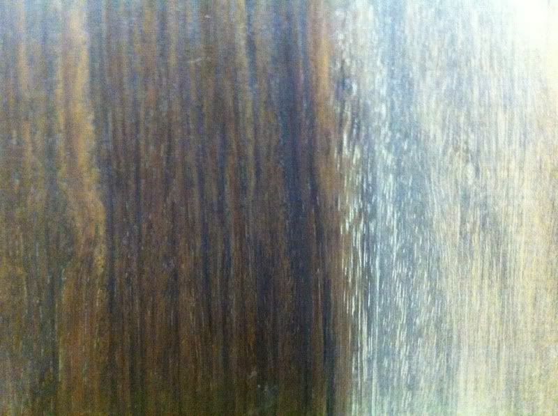

Well after a bunch of reading I went and got some timbermate pore filler and some die to tint it.
I used the tint base, black airbrush die, burnt umber airbrush die and a bit of ebony dust.
I mixed up the filler to a creamy consistency, added the die's a drop or two at at time till I got the color I was after, well almost. I would have liked to have had a darker brown to start with, but this is acceptable to me. I added the ebony dust just to see if it would get a bit darker and it did.
As you can see from the picture, the pores were filled and the color of the filler was lighter than the rosewood (right hand side) which was not acceptable. However on the left side is one quick wipe with shellac which wet the filler and we'll see if it stays that way once the shellac is cured.
Looks promising :)

Well, the filler didn't go dark after spraying shellac as my filler..... Time to sand back, pull the filler out and use something else. [headinwall]
