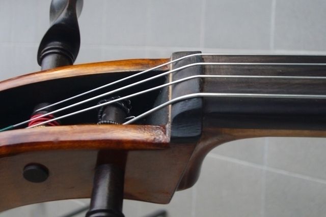

There are some important differences for violin family nuts. (not to be confused with violin family nuts)
The windings on violin/cello strings are very fragile and won't tolerate a sharp transition. Especially because the break angle into the pegbox is steeper than to the tuners on a guitar.
Not a lot of bending going on.
Intonation is not really an issue on violin family stuff.
The nut in the photo above would be considered very poorly cut. In addition to being way too high, if you follow the curve of the strings with your eye, you can clearly see the lumps and bumps in the curves that make an instrument hard to tune and will wear out strings prematurely. violin family strings can be incredibly expensive.
Mike, you can ramp to an angle but if you ramp to flat,(parallel to the fgbd) it won't work on a violin or a guitar.
Paul Hostetter's site has some really useful diagrams if you have not been there already.
http://www.lutherie.net/nuts.html

My slots (so far) have been ramp to front edge of nut. We've got a drawing above saying ramp to flat. We've got David (above) saying that won't work. Why won't ramp to flat work?
To me, as an engineer, (mechanical if it matters), there's a good reason for everything. There is a relationship to slot width to string width. Then there is how the string rides the slot. One thing we do is press string at first fret to see if the problem is at the nut. It usually is. How do we build a nut to act like a fret? Am I mistaken, or have I seen zero frets before?

This one seems well crafted and looks better -- still a ramp shape that ends with a flat and defined edge. Strangely about half string depth.
