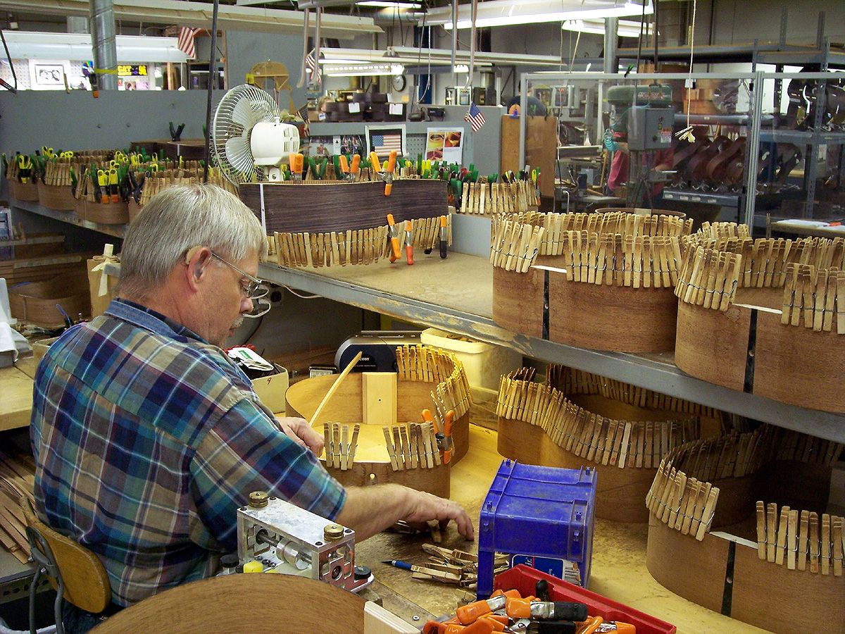

Like the Martin factory I use clothes pins and an occasional spring clamp -- I have gone to bamboo CP's which are very strong and will not crack when a high tech rubber band is added to increase clamping force. As a side bar note that the rim "is not" in a mold for the ribbon lining installation. I believe Dick Boak has been quoted in a couple of videos saying "spring clothes pins have been found to be the perfect tool for this job"

It should also be said that in the Martin pic, which is very cool by the way thanks Ken, Martin is not typically installing wood bindings. Instead these days it's pl*stic which is way more flexible and conforming than wood bindings. The cement used for plastic bindings is not as dependent on perfect fit as some wood glues are and HHG certainly is.
Clothes pins are fine, as per the Martin pic, for pl*stic bindings but for wood I would have concerns that the clamping pressure may not be there. I always installed my wood bindings with Titebond meaning that wood to wood clamping and fitting requirements came very much into play. The binder clips have enough pressure for wood to wood and I never had any issues.

I am confused (easy to do) but the photos and some where I have a video is of the guy installing traditional triangular wood ribbon linings -- not bindings.
