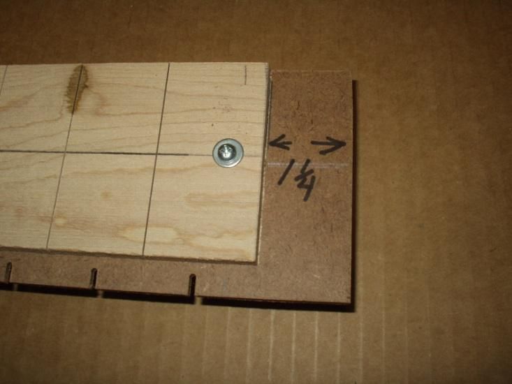

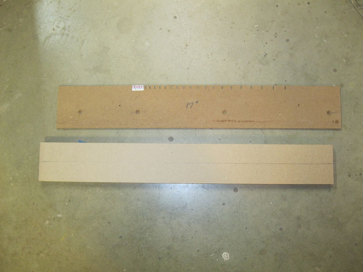

With all the distractions I think the essence of this thread may have been lost. So I took a few minutes to make a sample pallet/sled -- for photo purposes I actually made a complete usable pallet -- took less then 15 minutes complete -- the point being, this is a real simple fixture/jig to make and worth considering.
You start with your template and a piece of material for the pallet this one is 3" x 3/4 " MDF, could be something much thinner
Drill some counter sunk holes in your template then fasten it to the pallet leaving the notches exposed.

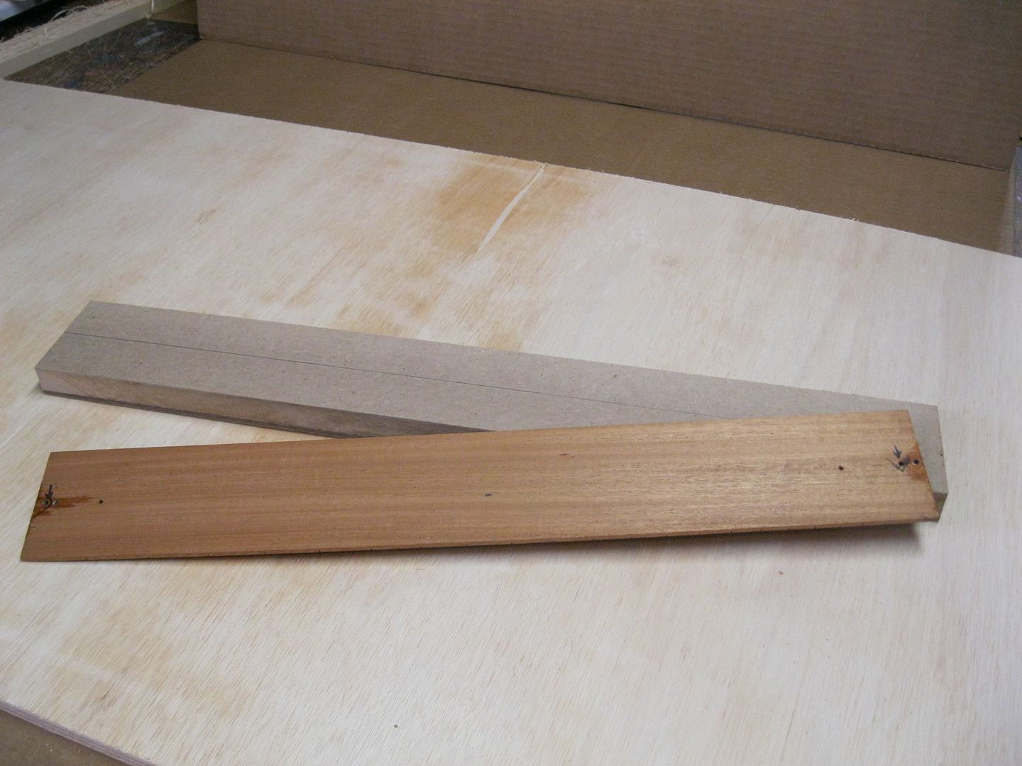

Now you need to make a FB blank master which is simply a fingerboard size piece of material with a center line and holes drilled on each end
Use the master to position the end holes on the center line of the pallet adjust to accommodate your locating pin offset this example is really for a table saw pallet so its upside down

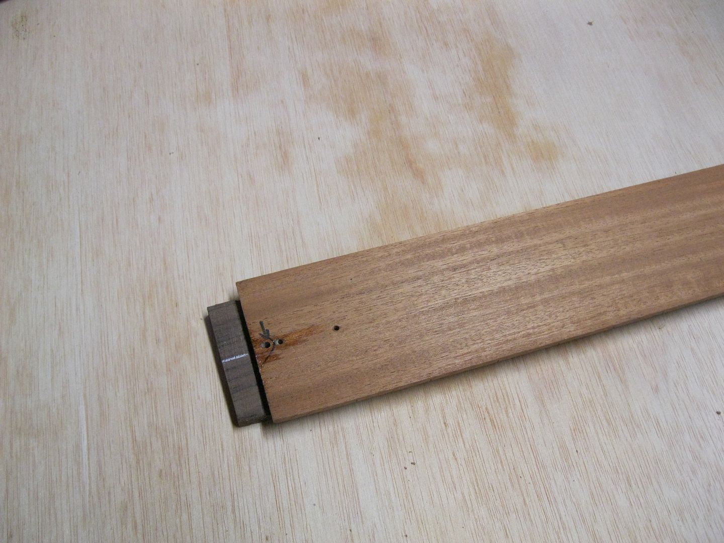

Prepare the finger board blank by drilling holes on the center line at each end using the master.
Screw the FB to the pallet and you are ready to saw away.
