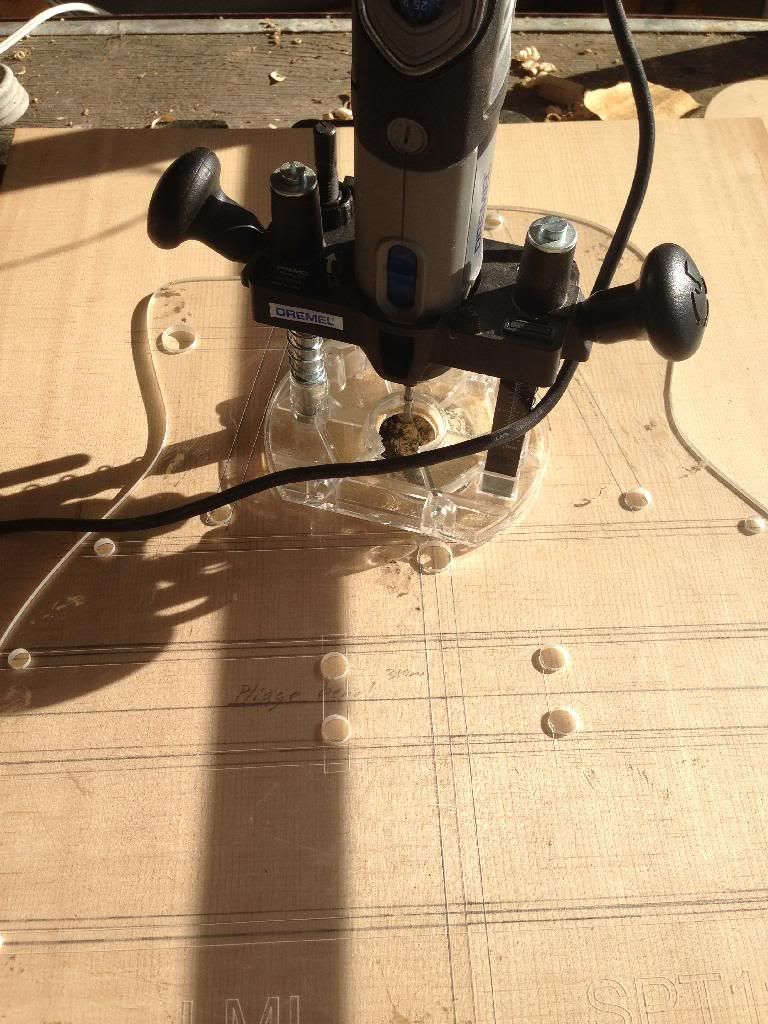

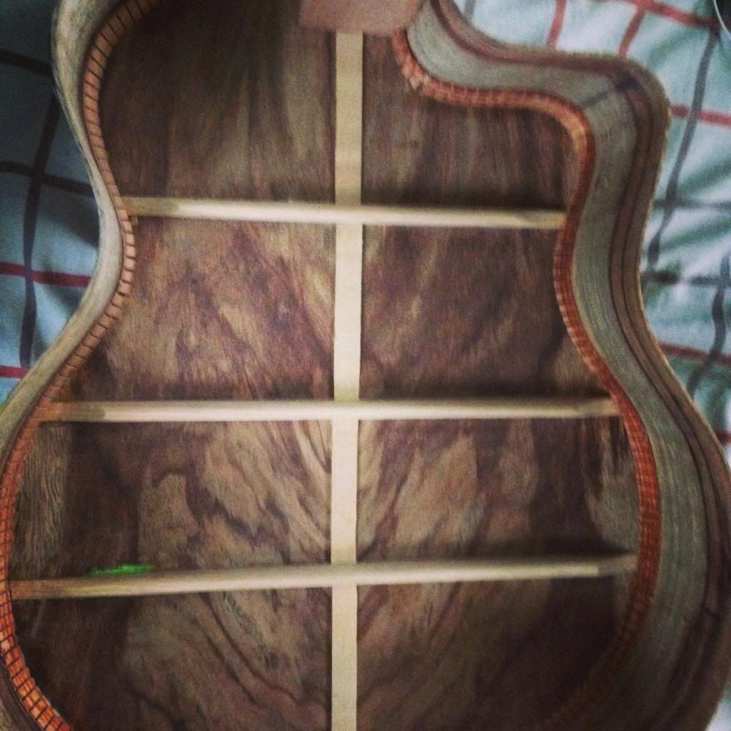

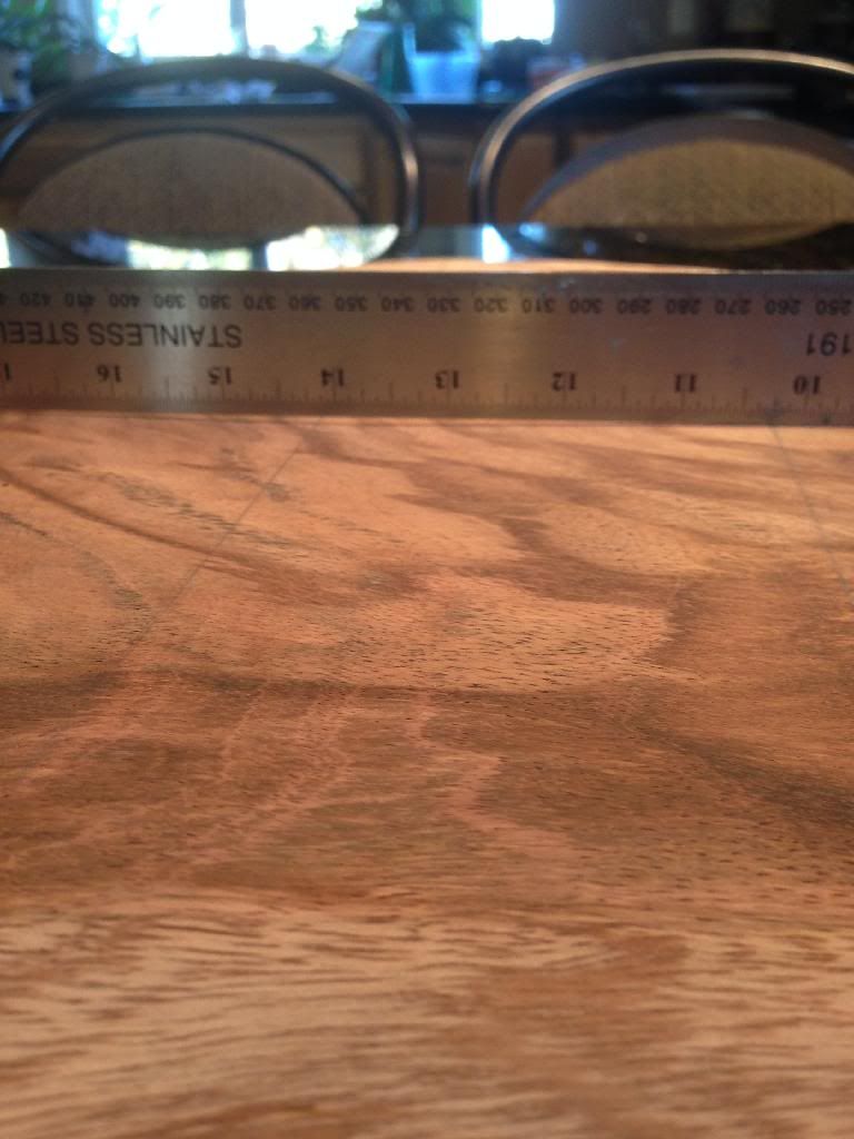

Well good things and bad things with this build, there was bound to be something going wrong and it finally happened. when i was trying to glue to back to the sides today. During the dry clamp i noticed that where the last brace the back isn't fully arched, but rather dips a bit. After a few hours I've thought of an unorthodox fix which will either repair or ruin this build. I put a 15 foot radius on the sides( the back is a 12 foot radius) and i removed the last brace and will re-arch it. Hopefully with the 15 foot radius on the sides it'll force more pressure on the back giving me more of a dome. I also found a pattern router bit for my dremel and i decided to test it on the soundboard for the sound hole and rosette!

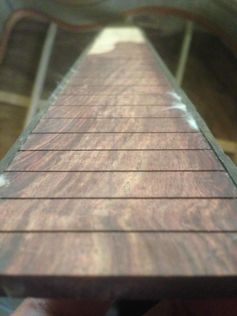

Not going to meet the deadline for the competition, but oh well id rather get this guitar done right than finish it on time and it be a bad instrument. Unfortunately I've been so busy i haven't had a chance to really work on it. Some updates since April are the back which was re arched and re domed and now works, a slotted and bound fretboard, Soundhole rosette which i will be finishing tonight and the headstock!!

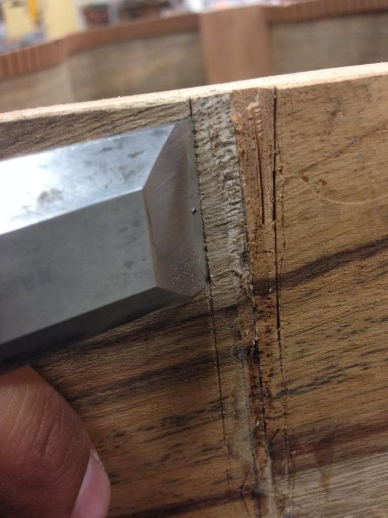

I apologize for not posting frequently, truthfully I've been incredibly busy with school and then the San Diego fires. anyways i haven't really done too much work other than add the end graft and a back strip to the guitar. feedback is greatly appreciated!
