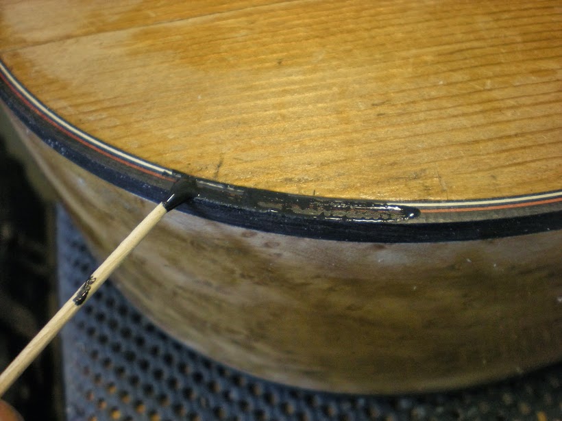

Alright, some more progress.
Gap filling with white glue + black pigment.

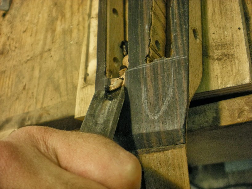

Drilling tuner holes.
I cut the slots with a coping saw, then cleaned the slots with the bosch.
Shaping the ramps.
Done headstock.
To be continued.

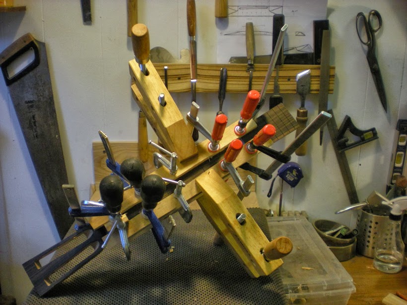

I drilled through the UTB for accessing the trussrod.
Glued the fretboard on.

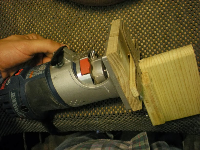

Here is my stupidly simple jig for routing the saddle slot.
Template.

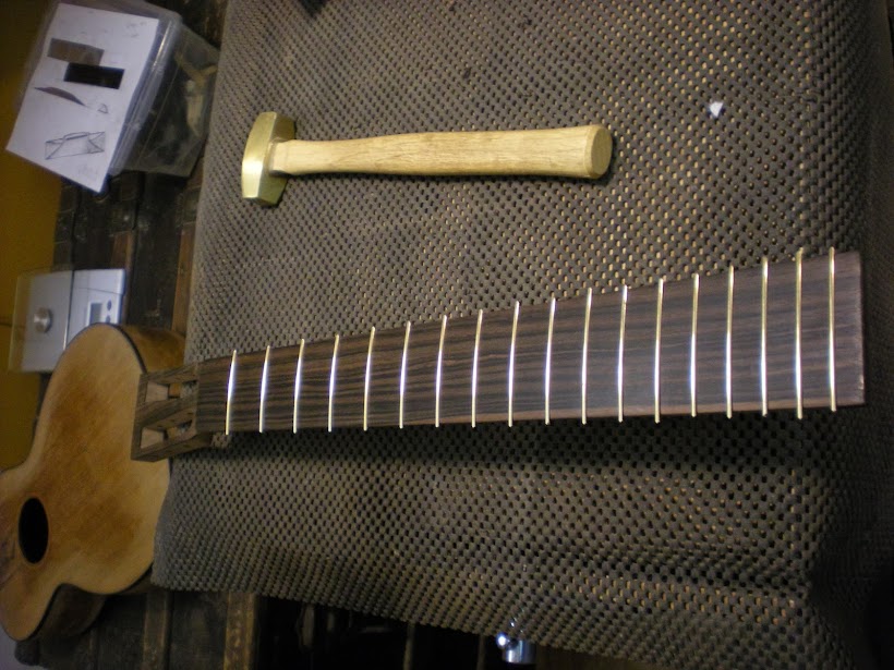

Finally for today, I sanded and polished the fretboard, then knocked the edge off the fretslots with a triangle file.
Then hammered the frets in.

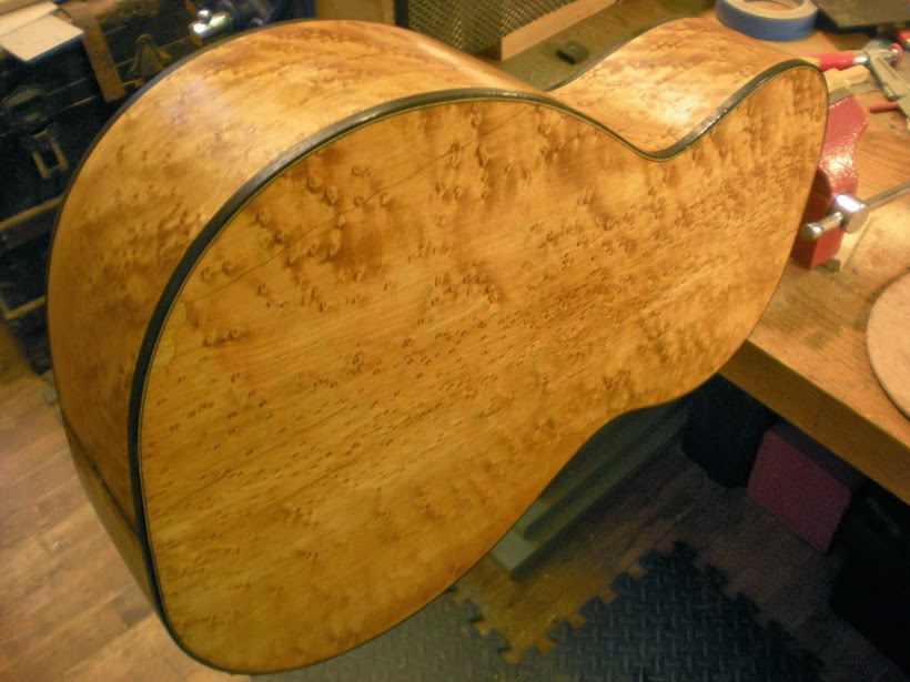

First coat on the top.
There is some bearclaw on this top. Interesting.
The back is now alive.
And then the neck.
I'm done for today. In the next weeks, I will build coats by brushing on the shellac, sanding back, brush-on more, etc.
