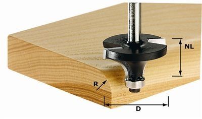

On the last few archtops I made it struck me it might look nice to round the edge over like an electric guitar so I used a bearing guided roundover bit to trim the binding. It took a couple of passes but went very well. After a little time with a sharp chisel removing larger proud areas, I did one pass to get things started, sanded the sides clean of crud and did one more pass. Done.
I'll certainly try it again.
