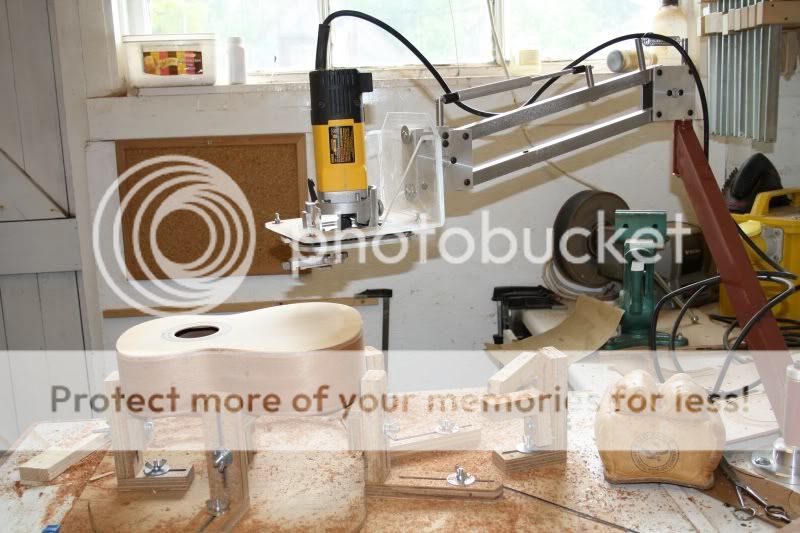

I've used a few types of jigs, including a home made version of "luthier tool" type jig, which is again similar to older designs shown in one of the "Red Book of American Lutherie", Jim William's guitar making book, MIMF and other places, its one of the most common designs that's been around for years. I've also used a few different set ups for arch top instruments, but the the one I have will do both, and better and any system I've tried before. It was a limited run of jigs made by Garry Hallam in the UK, and is reminiscent of both an architect's lamp and Jim Olsen's jig (and I guess yours too, Don ;) )...
Works great!
Thats really nice. Could you give us a shot of whats inside the plates on each end of the articulating arms?
PostPosted: Sat Sep 08, 2012 10:58 am
Essentially, sleeve bearings to keep from crushing and binding the square aluminum tubes, and a bearing post on the top square with a vertical tube for rotational purposes, similar to the one at the base, in a way. The spring is the key to balance. I believe he also made a few with an adjustable hydraulic option as well, but the spring works fine. The key was exceptional machining capability to make everything really square, and not bind under the weight of the router.

Yes I was also lucky enough to get one of Garry's rigs, I do have a gas shock on mine as well as the spring. The gas shock pressure is adjusted with the trimmer mounted so that it just very slightly raises the trimmer if you let go. This makes it impossible to drop the trimmer onto the guitar, it also makes the trimmer feel virtually weightless and makes it very easy to control. I love this rig.

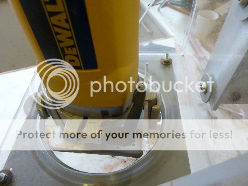

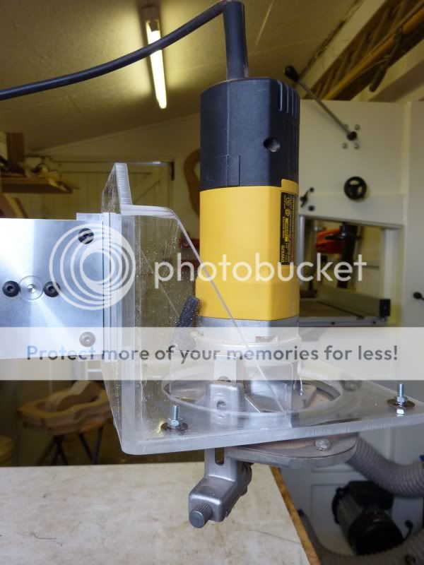

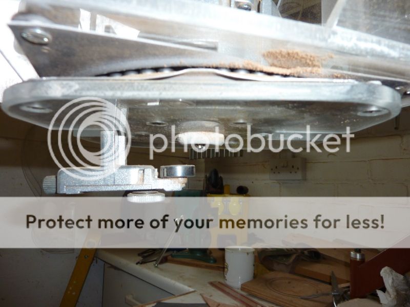

I also use my De Walt trimmer with a guide bearing attached and mounted on a small lazy Susan allowing the trimmer to rotate. This means that I can use a downcut spiral bit and can adjust the depth of cut very accurately to suit whatever binding/purfling scheme I'm using. I also don't have the risk of the bearing coming loose on the cutter, nor have the bearing bind and spin at the cutter rate, marking the sides, which happened to me once before I made the switch.

I now, as I said above, use one of Garry Hallam's rigs, and like Arnt I've found that it gives me faultless channels on every type of instrument I make. I can't see me, or any of the people that were lucky enough to get one of Garry's rigs, changing the way that we cut the channels.

Colin, would you mind posting a pic of the guide and lazy Susan that allows you to use a down spiral bit? I'm not understanding and picturing that.
PostPosted: Mon Sep 10, 2012 2:46 am
Darryl this method was devised by Dave White, I've used it on both my Williams/Fleishman rig and now on the Garry Hallam one, it means you can use a downcut spiral bit , rather than having to use one with interchangeable bearings. I can fine adjust both vertical and horizontal cuts to perfectly fit my binding/purfling schemes. It is far and away the best system I have used, and as I said I've used all of the ones mentioned in this thread over the years. It gives a great 'feel' when cutting the channels, something I completely missed when using a method where the guitar is moved rather than the trimmer.
Here's a few photos that should help.
