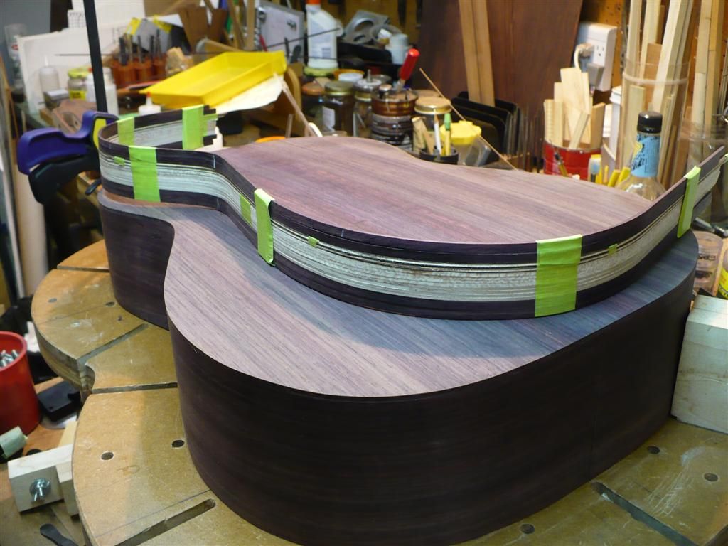

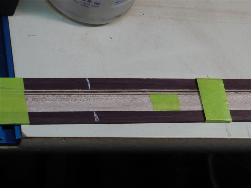

Thanks for all the replies guys. I love the exchange and the wit [:Y:] .
I made the bindings out of dimensional Bloodwood with the purflings glued on with TB prior to slicing and thicknessing to .095. The I hit the old trusty BBQ Pipe for the bend. At that thickness, the pipe internal temp needs to reach about 450-500 degrees before the wood "lets go". Otherwise I'm sitting there for an hour waiting for the slow relax. I've not had any Bloodwood bindings break on me, although, I've seen some potential run-out wannabees trying hard.
Well, at that temp, I get the expected delam; and at the waist, I get the unfortunate binding cramp/crinkle where the surface area of the bindings does not take kindly to being squeezed. Maybe, I need to lam AFTER I bend - but that seems like such a pain in the ....
Questions, for those using pipes or even benders - I assume the same applies - reducing the surface area of the laminations seems to me it would still want to resist reduction and its only option is to crinkle/crimp.
Thanks again for the help. I LOVE Bloodwood bindings. Maybe I need to find a wood that relaxes at lower temps.

Steve - 0.095" is a lot of binding thickness to try and bend, especially when it is cranky stuff like Bloodwood. Even 0.010" less can make a significant improvement; 0.015" off is even better.
… or … as we've come to say in the luthiering bidness … "stress free". ;-)
Filippo
In looking at Steve's pics, it would appear that he's laminating both edge and top purfs, which results in the big numbers for thickness and the delams he's seeing. The alternative approach is to laminate the side purfs, thickness, and bend, then add the top purfs as a separate element.
Actually, I do the top purflings separate in a separate channel (glued in a form so they're pre-bent; they only need to be cut) I only lam the bottom purfs. It is interesting that I didn't realized that my final thickness is MUCH thiner than .095 - so why do I start at that thickness in the first place? idunno
On my next, I'm going to take everyone's advice. Bend just the binding (even if it isn't bloodwood), then add the bottom purflings. I think, as stated, that it will be much less stress and make it much easier.
Sometimes I just have to do things the stupid way before those with much more wisdom point out the errors of my ways. [headinwall]
You have all provided wonderful advice and some insight into the bending process I had not considered. A big thanks to everyone!
