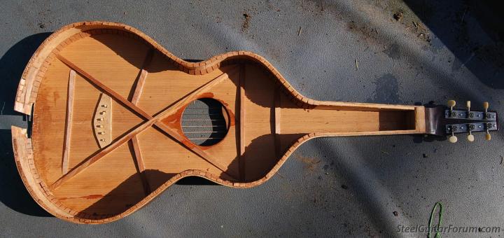

There are some fantastic pictures of a of an early Weissenborn (1914-1915) that George Noe posted over in the Steel Guitar Forum:
Steel Guitar Forum thread with George Noe's pictures.
A mighty good look at the bracing:
He also posted some info re: dating Weissenborns in this thread.
In the first thread I mentioned, George mentions the "Knutsen bridge." Ron, if you haven't seen the picture on this page of Gregg Miner's Knutsen Archives, you can see the evolution of the Knutsen and Weissenborn bridges.
