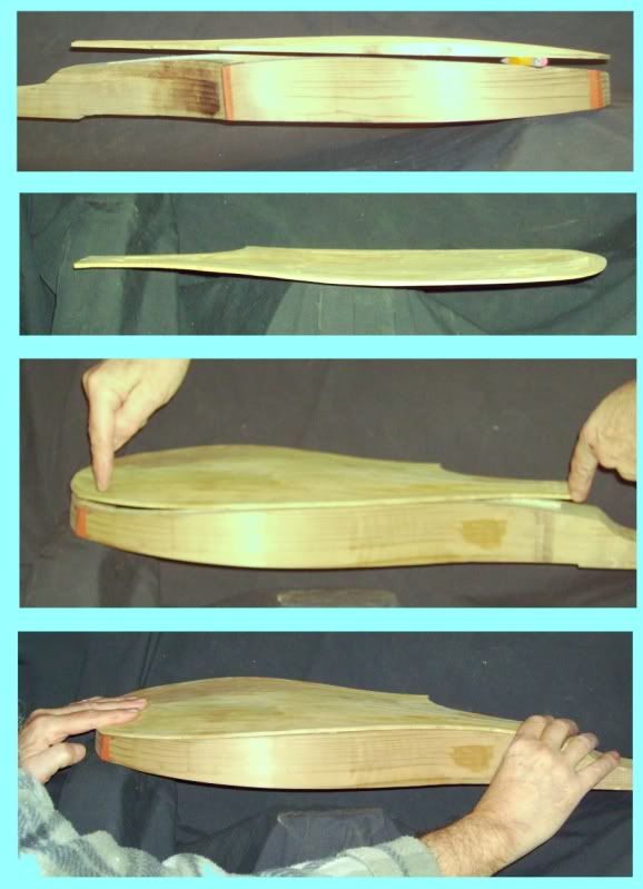

Just a quick recap...
Carved arch top of lutz but looks like it might just be cedar now cuz for some strange reason me jointed two cedar plates up instead of a lutz and a cedar. Oh well.
Cedar neck body and back.
Paduk headstock, fret board and banding.
Gold hardware.
Short neck at 23.12 inch string length.
So here it is. Cedar. Two necks from this stick
Me tailpipe and a BBQ starter upper bending away.
In the next three pics you can see the hight of the ribs varies around the perimeter
from as narrow as 7/8 to as wide as 1 1/2 inches. This widening and narrowing of
perimeter produces some real tricky compound curves with the shape of the perimeter,
especially in the cutaway area. Cutting the banding channel gonna be a real trip for
sure...probably do a hand cut. We see...not there yet.
I install the corner and cutaway blocks into the ribs now as I find it easier to have them
structurally in place as opposed to the hassle of planting binding, which if its gonna
get knocked is gonna fall off. Making the corner blocks
in this fashion ends that problem and gives some repair man a headache tryin to figure out
how to get it appart...but then thats their problem. Yes, Padauk banding.
Yes, that is a "twist you see in the body. Is intentional cuz when held the fretboard will be
slightly "tilted" towards the player thus alleviating the "over extended guitar players buzzards
neck" that pickers get from constantly sticken their head out to see the fret board.
Got the plates jointed...should be carving them by tomorrow...maybe. I have
learned that life often has other plans for the Padma.
blessings
duh
Padma

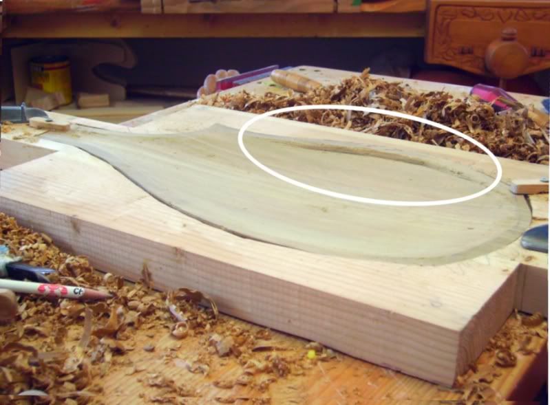

Made a cradle for the plate out of 2 x fir
and started to hog it out. The process of hoggin it out and rough planing to shape was no more than about 10 min.
Then went to the round bottom plane...took it down to rough shape
Then me checked the tap tone...well me was so delighted with its tone quality me just couldn't help me self, went tribal and started a tappin and a dancing all around me work bench.
Ya me may be crazed in the head, but me ain't stupid. So like when was the list time you
let it all hang out and danced for joy? Hmmm?
bliss
Me will now do the final tap carve and voicing of her top. This final step is were me pay real close attention.
blessings
duh Padma

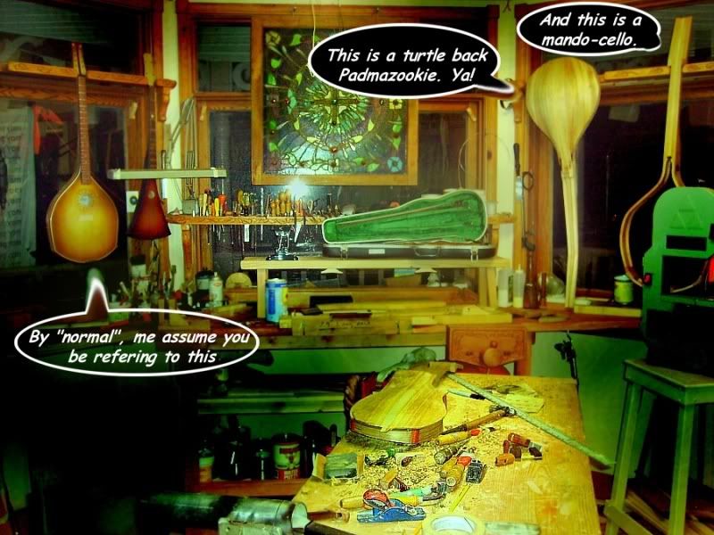

hey Padma,
Whats up with the normal looking mando behind you in a few of the pics?
 Post subject: Re: Travel Guitar
PostPosted: Sun Jan 30, 2011 3:42 pm
Posts: 1982
First name: duh
Last Name: Padma
oval soundhole wrote:
hey Padma,
Yo, soundhole,
Thank you for asking.
There may be a pic else were in this Travel build that shows a "normal" mando... Its in for new bridge and set up. Perhaps you be referring to that.
Ummm, duh Padma and me builds don't exactly fit normal no how. To really get just what the mandocello in the above pic is about and its mandolin partner, go here http://luthiersforum.com/forum/viewtopic.php?f=10101&t=21036
and see the thread of their being build. They are now both in the final setup stage but are not high on me list of things to be dealt with. One day.
Enjoy!
blessings
duh far away from "normal" as possible Padma laughing6-hehe

In this pic you see the carved out back and the lip (inside the oval) that has to be lowered to accommodate the changing rise of the ribs.
The top pic shows the outer carved profile of the back plate. The second in the series shows the finished carved plate...Notice it is rather bowl shaped. In the third pic you see that even though the plates perimeter is now bowl shaped, the plate still needs to be flexed when gluing it to the rim. The final pic shows me very own to hands flexing the plate into place.
So now its make the internal top plates parallel braces, F holes and the closing up of the box.
