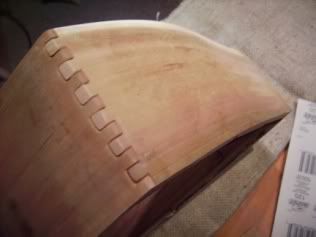

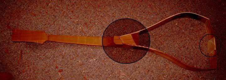

Its coming together.
Fashioned the heal block and the necks tenon. Made the tail block mounting plate.
Cut some dove tails. Ya,why not!
The angles of the 4 joins are different on both sides of the heal and on 2 corners, which are
compound curves and of various thicknesses. Pretty gall darn uniform fingers for no measurements eh!
Is simple, just eyeball, scribe cut and fidget.
Only gonna smooth down about half of the inside surface of the ribs, leaving the rough surface that frowing slabs of a billet produces, just in case anybody down the road ever take a notion to look inside. That should pop their eyeballs. But the burn marks will be removed.
Box is closed at the heel but not the end rib which has dove tales that need just a bit more work.
By looking at the ends of the finger joints you can see the different thicknesses of the side ribs, which varies depending how round I wish the edge to be in the final sculpting of her shape. The ends of the fingers have all been 1/4 rounded over...its sorta taking on the Green and Green look of early last century not to mention a strong Heida quality to her is emerging.
The end block has to be added to the two 1/8th inch end blocks plates which were flexed glued into the compound
curve of the end rib. They will then be planed flat on the inside to accept the actual end block. Then its on to the kurfing.

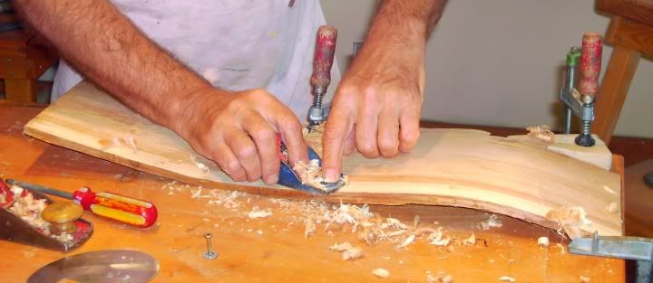

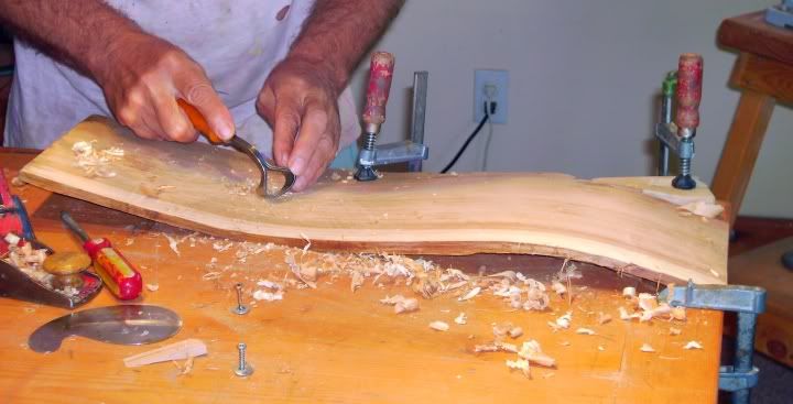

Sun don't shine every day so I took advantage of it and worked out side.
Woodn't you know it but out of my stash of cedar tops, only one was long enough and wide enough
and it happened to be the ugliest, twistedest, nastiest run out every which away top me got ~ go figure.
Spirit is trying to tell me something I'm sure.

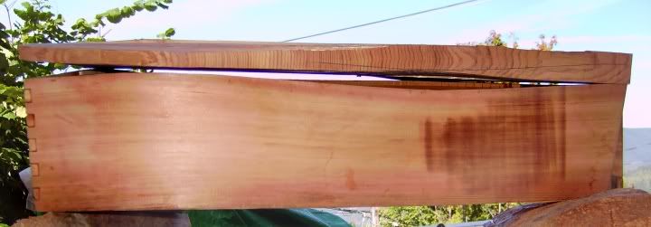

So I start with my trusty hand held jointer for bulking the shape.
Then its on to a closed or hooped draw knife.
The run out ain't the problem ... its getting it to fit on the rim as you can see in these pics. Scribe cut and fidget,
scribe cut and fidget. Did I mention that its scribe cut and fidget all the way...oh ya and pray.
This is the only gap that may give me troubles in getting it closed... I won't know until the back
has been scooped out as to weather or not it can be flexed down. Thing is I gotts to carve the whole
top to really find out. Is a good chance that it will. Is near feeding time and me tired
so I will leave the scooping out till tomorrow and then we will know for sure.
This is as far as me got today.

Another sunny day.
Got the back bulked out, and managed to close up that gap.
Contact cemented some 80 grit paper to both sides of long thin spatula and
kept pulling it through between the tops lip and the rim on the ribs till the top
fit nice and tight ... no light coming through. Yay.

Here are progressive pics of the suclpted ribs taken from the neck joint to the end rib. I am only gonna show one side but the other is quite simmilar.
This is the side...
and this is the progression of sculpting
The sculpting is best seen in the shadow cast by the sand paper. It is up to 1/8 inches deep down by the neck joint and changes gradually to a 1/8 buldge at the widest part and then goes almost flat at the other end with the dove tailing..quite difficult to photograph. Note the edges have been rounded over which will enhance the visual overhang of the rounded proud violin edge of the plates.
This is a shot of the end rib showing its voluptuous compound "S" curve and the finger jointing of the side and end rib.
Gonna finish scrapeing the ribs, add the bracing and attemp to glue the plates on, closing up the box befor the end of the month because I will then have to hang this build up for a bit to take care of other stuff. You know the stuff that gets in the way of building. Oh well.
