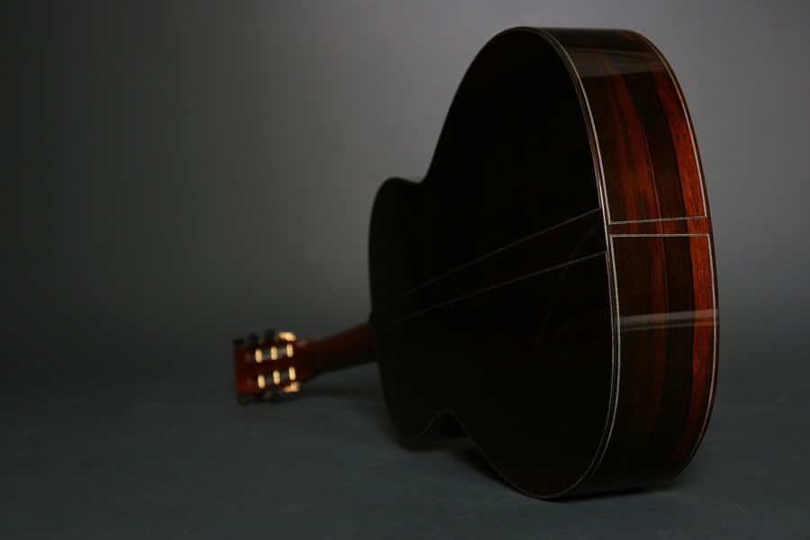

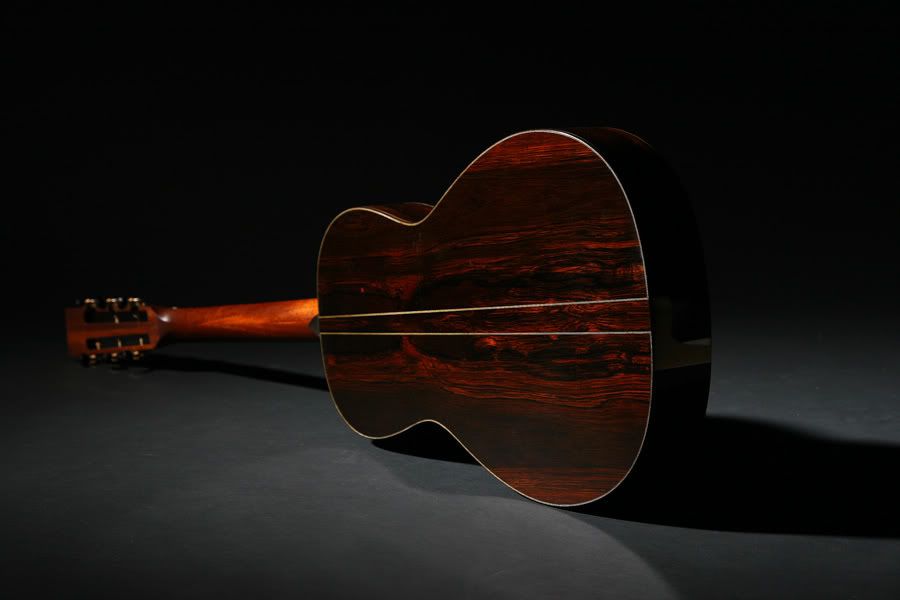

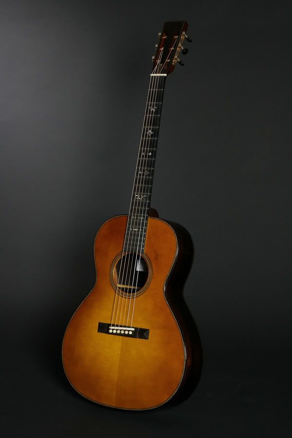

Arnt boy, yes we have to meet! You're in trondheim right? Speaking of braz... just gotta post these fabulous photos taken by a friend of mine, Jens Larson at geronimo studio here in stockholm. This is the third guitar in this batch that I started back in april.

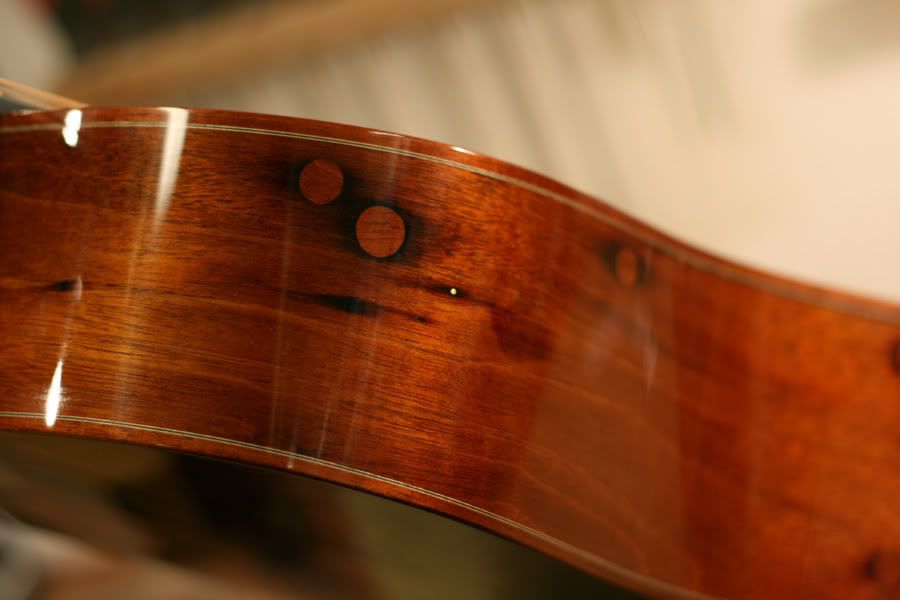

My mother has a mahogany buffet in her living room that has the same depth of color! I wonder if there's some way to force new hog to get that color! It's gorgeous!
You got the plugs from the same scrap wood?

Did you use original mahogony to plug the holes?
What a cool concept.

Yes, the plugs were taken from the scrap, some were 10 mm and could be cut with the 'plugmaker' (wallbit is the transation i can get?) and some had to be fit by hand.
Lefty, thats going to be some cool ukes! The history of those are going to top mine.. please post some pics of the project!

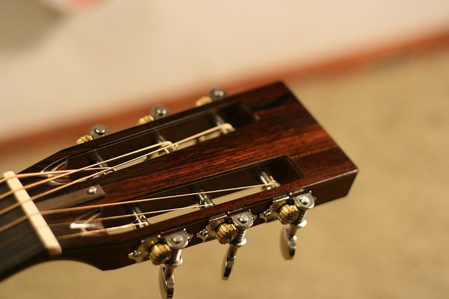

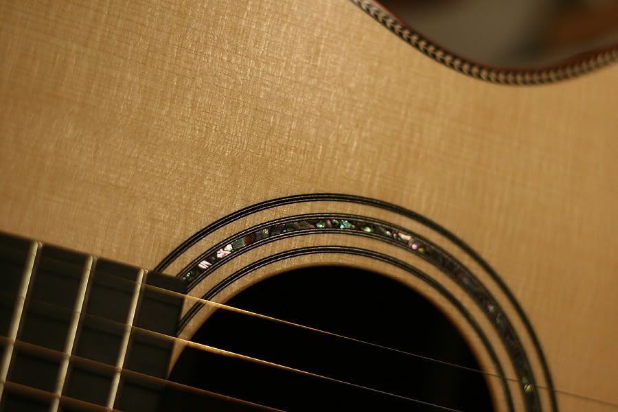

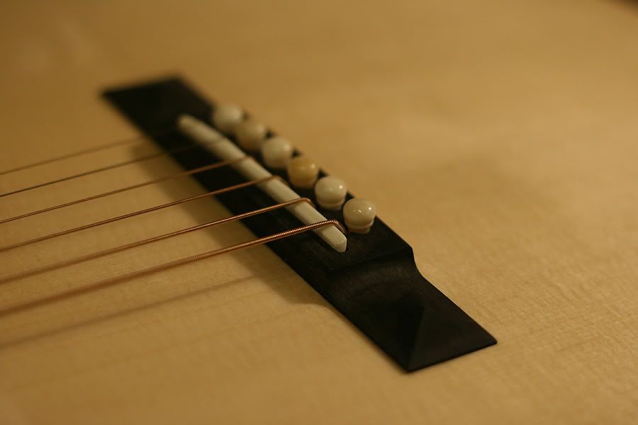

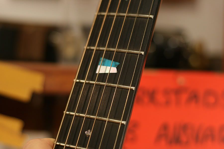

I took some closeup pics.
Inlay at 7th fret
Original brass nail!
Rosette
Headstock
Bridge:

I was wondering if you could tell me what type of glue you used to install the plugs. And, did you have to drill the original holes a bit larger so that you would have a nice perfect hole for the plug to go into.
I am still in the planning stages of my "Battleship Ukuleles."

Hi,
I drilled the holes to fit a 10mm plug, except two that were too big. On those I fit the plugs by hand. I glued them in place with titebond, and when leveled i put thin CA to fill tiny cracks that may have occured when hammering the plugs in... On the back I have little mahogany reinforcements alternatively braces glued over for support too. The sides are laminated with a 'solid' piece of honduran as a inner veneer. Wish you best of luck with the ukes, looking forward to see the results!

You're an amazing builder, Lars. Anyone who can bend a plug has got my vote.
