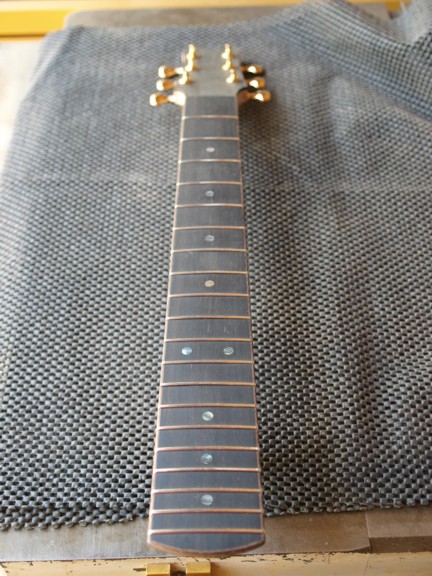

My first fretboard came out perfectly. After gluing to the neck, fretting, and getting the neck set right, it looks to me like I won't need to do any fret leveling at all, but time will tell when I get the final nut and bridge/saddle done in a week or two.....I'll let y'all know....
Sorry about the focus on this picture - I'm still getting used to my new camera (Olympus E-3) - the next lot will be much better, I promise!
As far as whether the shaft is necessary or not, I don't think it is absolutely needed, but it sure makes life easy, being as how it forms a very stable, no-slop center of swing action.
