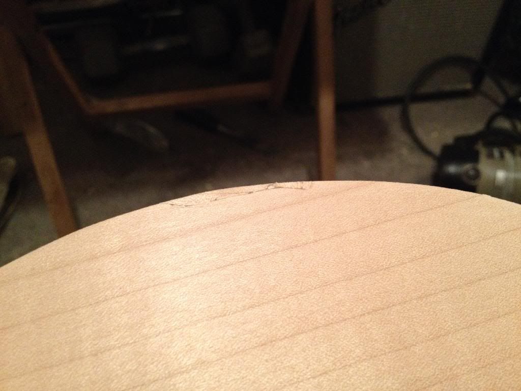

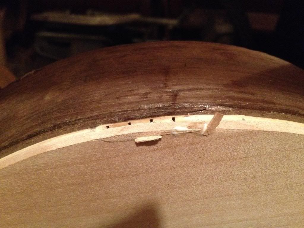

My collet adapter came in today so I was able to route the binding channel but I had a bad booboo. The pilot caught a piece of side wood that had a splinter chewed up a spot of my soundboard. The only thing I could think to do was make a patch and fill it the best I could. It will never be invisible but I'm hoping to get away with not painting it.
The first patch.
Filling in.

PostPosted: Mon Dec 16, 2013 10:16 pm
Joined: Mon Sep 30, 2013 12:51 am
Posts: 280
Location: Where Palm trees grow
First name: Jeremy
Last Name: Wood
City: Galveston
State: Texas
Zip/Postal Code: 77554
Final result.
