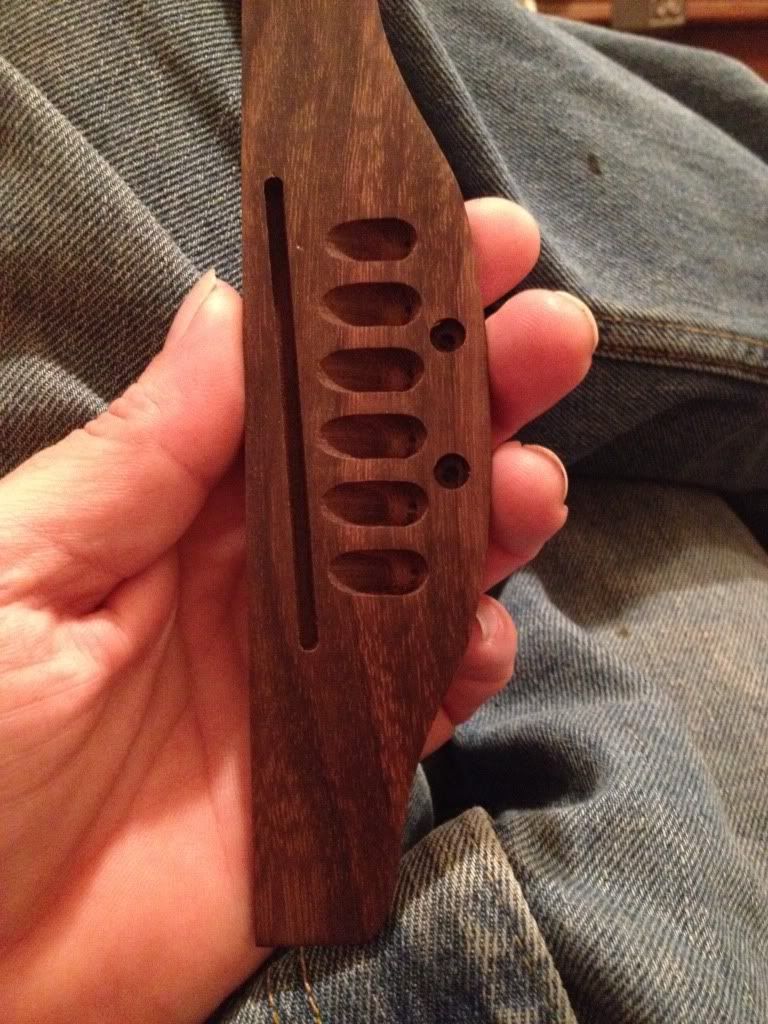

Well y'all have definitely given me a lot to think about. Especially after seeing and hearing the Taylor.
Ok my pinless bridge came today. And in the ad it said the two "not fully drilled" holes were for screws to screw it on I guess? But I know some people drill holes in these and use dowels. Would any body know the best way to attach this bridge to the soundboard?

I could really use some help on the proper way to attach a pinless bridge. I have been looking and can only find people talking about the bridge itself and no installation procedures.

PostPosted: Wed Nov 27, 2013 8:31 pm
Joined: Fri Jul 05, 2013 12:57 pm
Posts: 903
Location: London, England
R.M. Mottola glues a pinless bridge in this tutorial, http://liutaiomottola.com/construction/GlueBridge.htm.
You can drill through the saddle slot and use pins to help relocate the bridge when gluing. Not sure if it's recommended or not but the positioning "pins" on my first guitar were just the drill bits I used to make the holes. I didn't rely on them completely but they certainly helped.

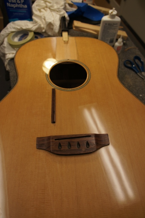

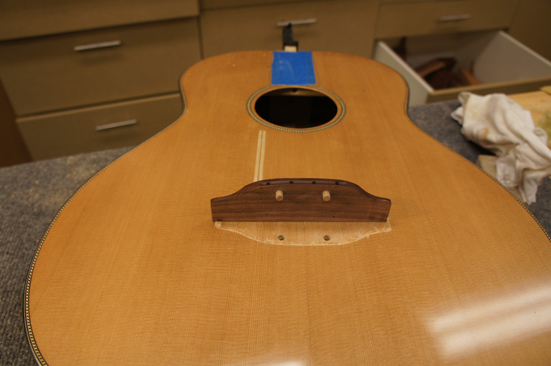

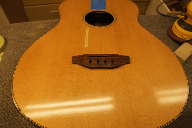

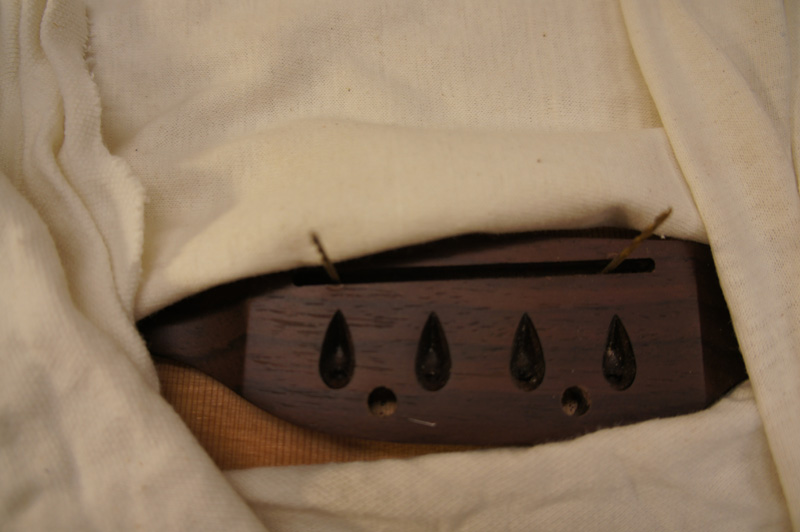

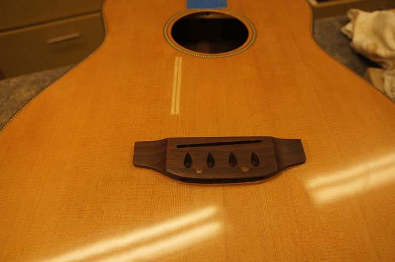

PostPosted: Sat Dec 07, 2013 11:56 pm
Posts: 1714
Last Name: Parchem
City: Seattle
State: Wa
Zip/Postal Code: 98177

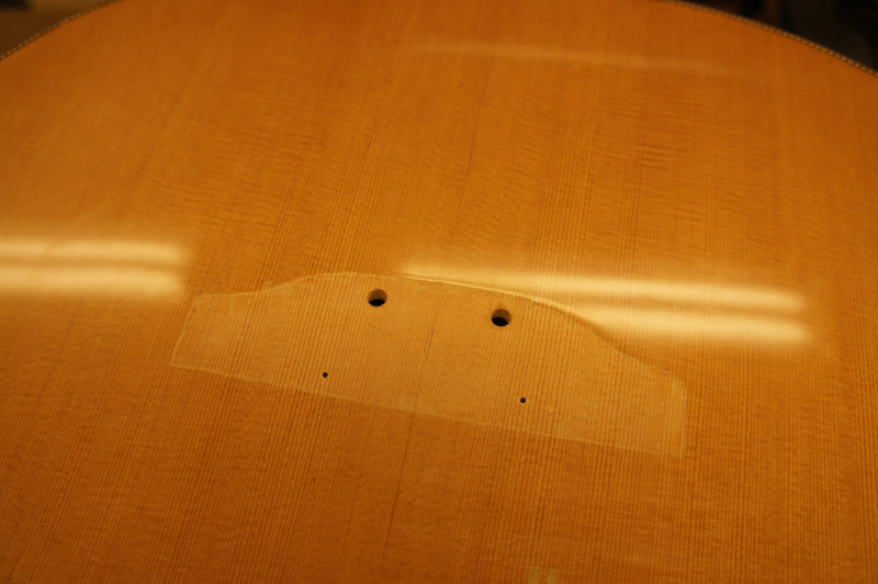

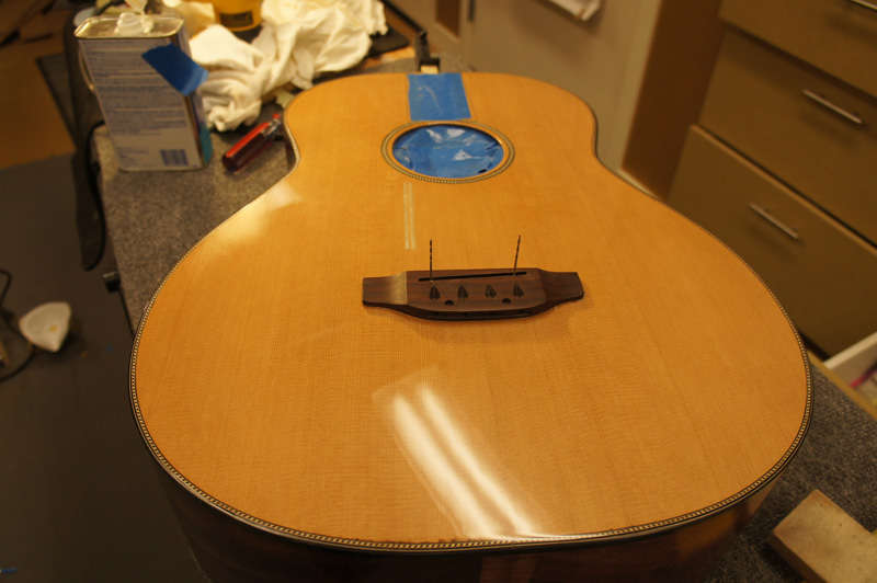

You can just glue it on after matching your top radius it should hold. I have put them on with dowels as well.
I had already postioned the bridge with 2 1/16" holes in the saddle slot. I never seem to be able to find the right side brad when I so I have just started using the upside down drill bit as a position pin. I first drilled the bridge on the drill press to get nice straight holes. Then I used the bridge itself pinned to the guitar to start the hole in the top. I finished the hole with the bridge off.
I took a bit of 1/4" dowel and chucked in my drill press and with a sanding block made the exact 15/64" inch dowel I was looking for. Cut them to the right size and CA glued them into the bridge.
A lesson to always dry fit. The sharp eye will note the bridge is slightly lifted. The dowel was a hair to long and when clamped against the gluing caul lifted the bridge. I sanded a bit of the dowel, rechecked and glued it on.
