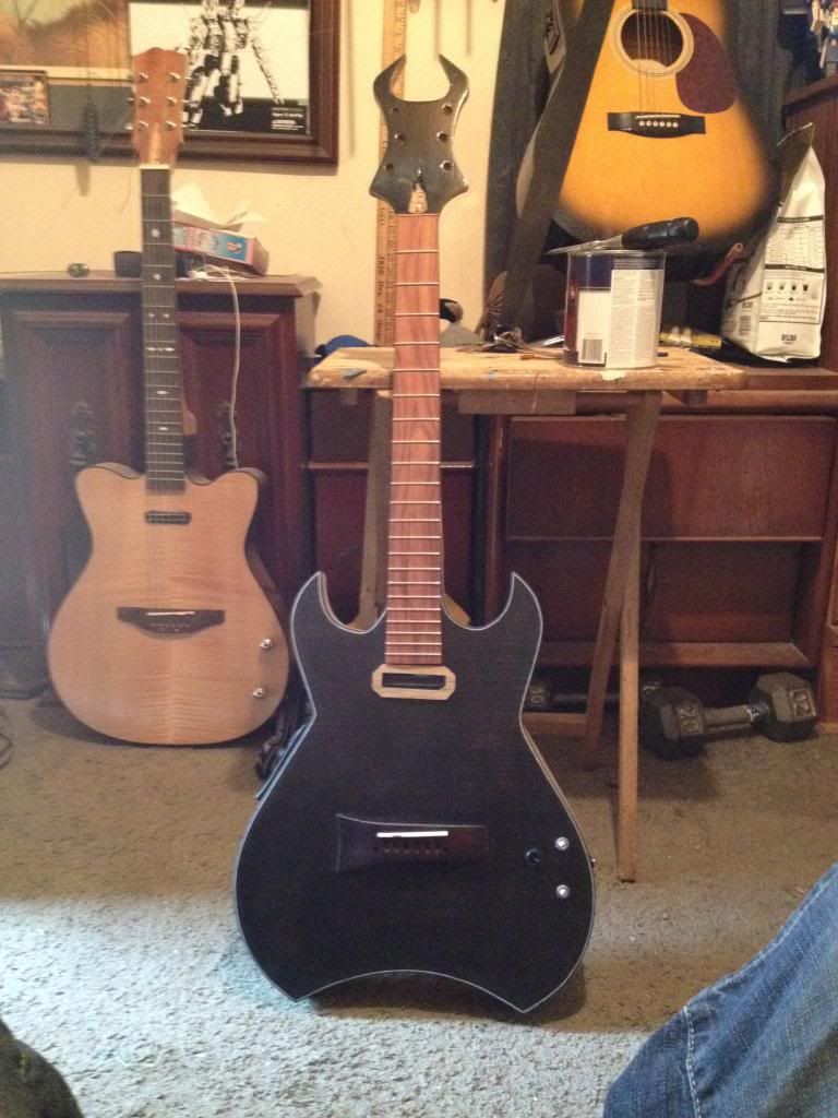

Thought I'd let y'all see my lates guitar. I went with black blue and white binding. I'm kinda pissed though becuase I went ordered a router bit and bearing from stewmac that was supposed to give me a .100 binding channel and I believe they sent me a .80 because my .100 binding scheme was almost ruined because I didn't realize til I had already glued the black on top of blue. So now I have to paint the outer black on top of the blue middle layer. I was afraid of melting plastic else I would have re-routed it.
Ok so on to some good news. As you know I have been buying custom necks with the angle already cut into it at 2 degrees. Well this has been a problem since I'm building flat top guitars that need lil angle. How I discovered this is through the new Neck angle calculator. http://www.tundraman.com/Guitars/NeckAngle/
And I learned more about why we need it. Any way so unfortunately I had already ordered my neck before I ran across the site. But I fixed it and actually a lot better and easier than you are supposed to.
I just took a sanding block and started at the top of my neck joint and sanded a reverse angle until it just it just started becoming right. Took a lil while but I'm pleased with it and the joint. And now I can order my necks with the proper angle.
Any way so here's a couple pics. I asked for a fatter headstock and that's what I came up with.

Looks good to me. Really like the design
