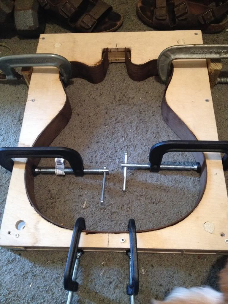

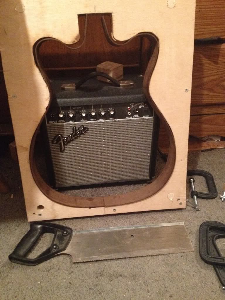

Been busy the past two days. I fitted the sides to the mold and made the necessary cuts where they needed to be cut. I didn't worry about making special cauls, when I tested just using clamps it worked out just fine. I still need to re dampen and and reheat but believe it or not there was little deviation when I removed the clamps. I got also got my neck block cut to the correct size and started on the sound board by gluing the side tone bars.
Sides fitted and cut.
Sides after fitting and cutting released from clamps.

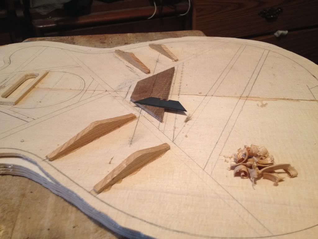

Started carving my side tone bars today. I went out and bought a set of wood carving chisels to start with and after a couple tries I found it easier to just use a trapezoid razor blade with tape on each end. It went a lot smoother and I was able to take off as much or as little as I wanted. For the most part I'm trying to get the left and right sound to the right pitch. Any way I like this part.
This is what I have so far a real rough cut. Still needs final shaping and sanding to refine them. I messed up cutting my bridge brace cut it too short. I got a funky pinless bridge so I just made sure it was placed where it all needs to be. It's got plenty of room for the front and back dowels to be drilled through and plugged.

Looks like you're progressing well. A couple of observations: 1) unless you buy the most expensive chisels, most come with a very rough primary bevel and no secondary bevel. They need to be honed to work properly. There are endless discussions on this forum and on woodworking fora and YouTube on successful edge tool sharpening. It's worth doing it right…they cut like butta!
2) I might not be seeing it the way it is in real life, but your soundboard looks like there's glue squeeze out at the joint, and that will prevent adhesion and proper gluing of your braces, so be sure to scrape that off and make sure both plates are level with each other…that there's no step from one side to the other. 3) you've already mentioned this, but your bridge plate is not going to butt against your X brace, and that might be a problem tonally and/or structurally. It's easy to fix now by planing that one off, scraping all the glue residue and gluing a new one on.

On it easy fix, and thank you I didn't think it would matter much. But thank you would hate to get too much further then realize I really fouled up.

PostPosted: Sat Nov 16, 2013 10:20 pm

Is it just me or does the finger braces look flatsawn? I also thickness and sand the top before bracing them. It is very important you control the humidity during this step, otherwise you will have potato chip.

I ordered them as a single plank of western red cedar that I cut into the right size strips using a table saw.

PostPosted: Sat Nov 16, 2013 11:35 pm

You should buy a thicker plank and split it, then saw along the split line...

PostPosted: Sun Nov 17, 2013 12:51 am
Posts: 4820
Good work on your sides!
Everything on the top is critical. The bridge plate unfortunately needs to be redone. The bridge plate helps send string energy through the top, which is why it needs to be "coupled" to the X-braces as much as possible.
You can plane it off as Beth suggested. Another option, assuming you used some sort of wood glue, is to soften the glue with heat by placing an iron on it and testing every minute or so until it starts to pull up when you get under it with a chisel or something. Cover the iron with some foil to keep it clean. Be careful not to gouge the top.
Try to make sure the rest of your braces are quartersawn.
PostPosted: Sun Nov 17, 2013 1:08 am

On ladder braced guitars, it doesn't seem possible to couple the bridge plate at all, unless you want an excessively large bridge plate... but there doesn't seem to be any issue with sound... The top on the ladder braced guitar I have seen is made from birch, so maybe there's a difference.
If you have a flatsawn piece of wood, you can make it quartersawn by turning it 90 degrees. The only guitars I have seen flatsawn braces on are cheap 100 dollar guitars, and we all know what they sound like.

PostPosted: Sun Nov 17, 2013 8:26 pm

The problem is once I had read this I had already fixed the bridge patch and glued on the two side tone bars. And I've already used my "guitar fund" up this month. I did a test of the wood I'm using and can't see much difference in the flex of either one. Since this is an still pretty much experimental in my eyes. The only thing I can do is try to use what I have to the best of my abilities. I do have another soundboard that I was gonna use some makore veneer on and use it as a back but if I decide my current SB ain't worth a crap or is unusable I can always use the other sound board and try to find a cheap set of hardwood back pieces.
