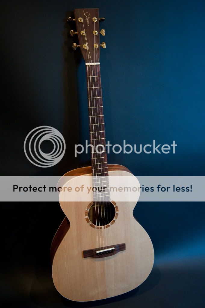

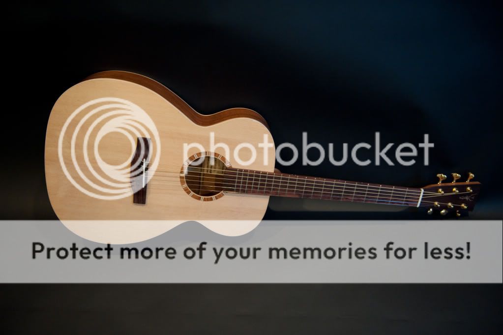

Gosh I don't know where to start. I have so many mixed feelings about this guitar.

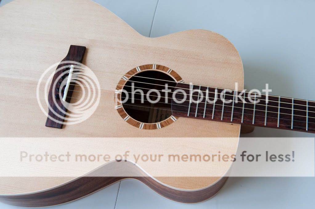

From a workmanship point of view this guitar is a mile ahead of my first one. I found the quality of any given task depends on good process and good skill. Good sound process can carry, to a degree, a lack of skill but you really need both. This guitar making thing forces a person that is serious about it...to analyze EVERYTHING. I need to pay more attention to the joining of the bindings. That would be an example of an area that needs improvement.
Sound is where I am most disappointed. We all know how subjective describing sound can be but I'll take a shot at it. It's too 'tinny'. I've heard some others refer to this type of sound as 'bright'...thin. I've been doing some research and I have identified a few items that I think contribute to the really exaggerated brightness of the guitar. The bridge is Madagascar rosewood, which has really low damping characteristics. The strings, which were given to me by the guy getting this guitar (in an attempt to help me) are Elixir extra lights nanoweb. I've never played extra lights. In fact I was originally going to string this guitar up with D'Addario PB lights. Also this guitar has a Sitka top (but I'm not sure that's a cause). With Mahogany back and sides I was really looking for a more round..full...earthy sound. Not so metallic.
So here are the photos.

I really like it. Visually it has a crisp and clean look compared to your first (and I don't mean to put down your first because I liked that one). I think your binding job looks cleaner on this one. I love the rosette. I can't wait to hear it. You might be right about the sound and the relation to the strings. It might be worth a try with some heavier ones just to see.

Cool looking guitar. You're missing a screw in a tuner though :)

It looks great. Have a little patience with its tone. (I say that as someone who has a tendency to overreact to initial impressions of my own work! [headinwall] ) How long has it been strung up? It'll continue to break-in for a good while.

Chris, based on that string selection - I wouldn't have that high hopes, regardless of how good a guitar. Hearing a tinny sound is exactly what I would expect, especially in regards to the high b and e strings. For spruce topped guitars, I STRONGLY recommend phosphor bronze - don't use the Elixir 80/20's because they tend to sound much brighter. Go buy a set of D'Addario phosphor bronze light gauge strings and wait at least a week or so after you first put the strings on to come to any kind of judgement about the tone. Since this is your second guitar, I strongly suggest holding onto it for the first couple weeks so that you have a good basis on what needs to be improved the third go around.
And the guitar looks beautiful - I like the shape of the heel when viewed from the back - very nice.

Only two days? Give it another couple weeks before you judge it too harshly.

The guitar looks absolutely great, Chris. You have done an outstanding job. I'd give it some time and play in on the sound too. Couple of days isn't much.

Gorgeous! I love the rosette and three piece back! Very nice work.
