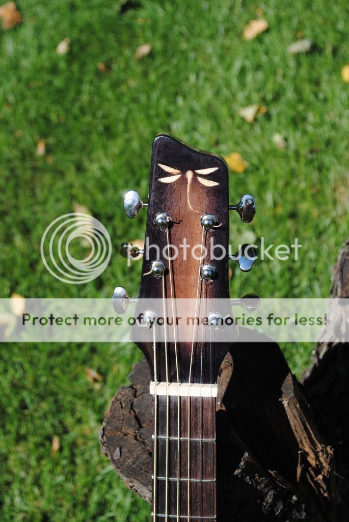

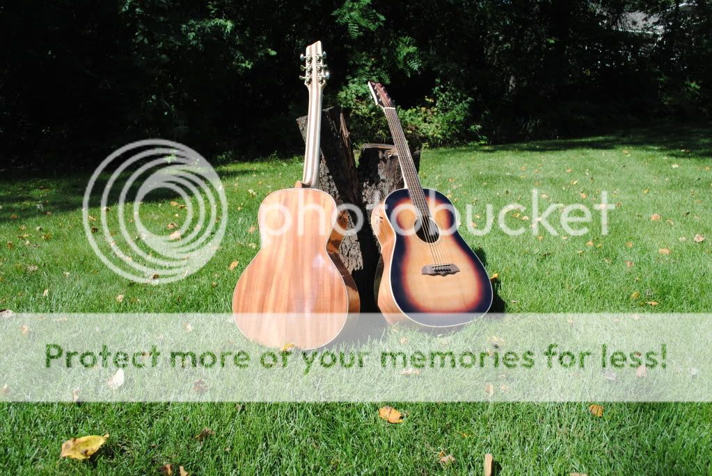

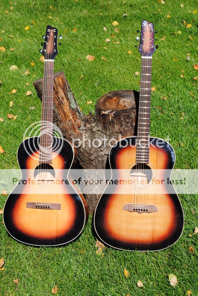

Here is what I did this summer.
Different build for me in that I had the concept of the finish before I started building. The sunbursts are a first and turned out alright. Sprayed on Target USL.
Both are 3 piece Douglas Fir tops with DF braces on African Mahog. It is trimmed out in maple. The neck is maple and walnut.
They sound great. Very different, but very good. First time that has happened where a guitar came off the bench sounding like a million bucks.
I'll buff again in a few weeks and put a finish on the bridges.
Dave

How would you characterize the Doug fir in terms of the impact on sound quality? More or less open than spruce when you strung them up? I'd really be interested in how the sound evolves as the guitars break in.
Oh, and did you change any of your design for tops, braces, (dimensions?, scalloping?) when building with the Doug fir? Thanks.

Corky, I built a parlor from this same board a few years back and absolutely love it. Went straight off the plan (mostly, but with my own little changes like feathering the X and lower legs into the soundboard and using what some describe as a parabolic shape.) The D was around .110" thick and the L-00 .100". I might try to finger braces on the next L-00 just to give a little more focus to the trebles.
Both are punchy and loud with the smaller being a little bassier than the big D (yes, I said that right.)
The D has that throaty Martin tone you hear in a nice D-18 with lots of mid range to punch through and be noticed.
Terrence, the wood is sorta local. The top came from a board I found at the family farm back in SD. The back came from Youngblood lumber yard in Minneapolis and the neck is lumber from Menards. All in all the lumber for the two guitars cost about $60. That's less than the hardware and fingerboards.
It was all an experiment for the sunburst and the new body sizes. So now, I can do three new things with good wood, the slope D, the L-00 and sunburst for anyone requesting.
