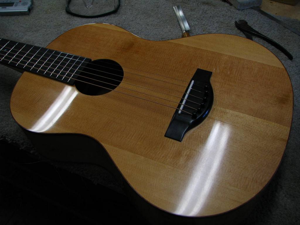

PostPosted: Sun Mar 28, 2010 5:41 pm
Joined: Sun Dec 27, 2009 2:59 pm
Posts: 458
Location: Northeast Indiana
First name: Phillip
Last Name: Patton
City: Yoder
Zip/Postal Code: 46798

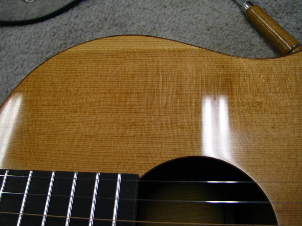

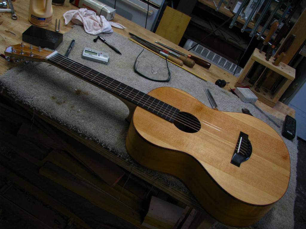

Frei wrote:
Yes, pleasxe post pics. The fingerboard is the main issue, and using an already built guitar to get the dang thing done. I dont like nylon strings, is the main issue.
Here are all the shots I have showing the fingerboard:
Hope this helps.
Phillip

PostPosted: Sun Mar 28, 2010 6:32 pm
Joined: Wed Jan 30, 2008 11:16 pm
Posts: 718
Those are great! Do you have any soundclips?
What string guages are ou using?
How thick was the soundboard? I was thinking look at around 3mm if using a standard X brace setup, but Im not sure what the lb pull is for light classical and light SS, or electric. This is with a stiff 'classical type wood, Carpathian or Adirondac.
I don't really have any sound clips. I need to get a good player to record something for me. ;) But I'll see what I can do.
I think these strings are mediums. I might try lights next time I change strings, just to see how it sounds.
The sound board was around 1/8" in the middle, thinning a little toward the edges. I used the standard x bracing, and it sounds pretty good to me. [:Y:]
