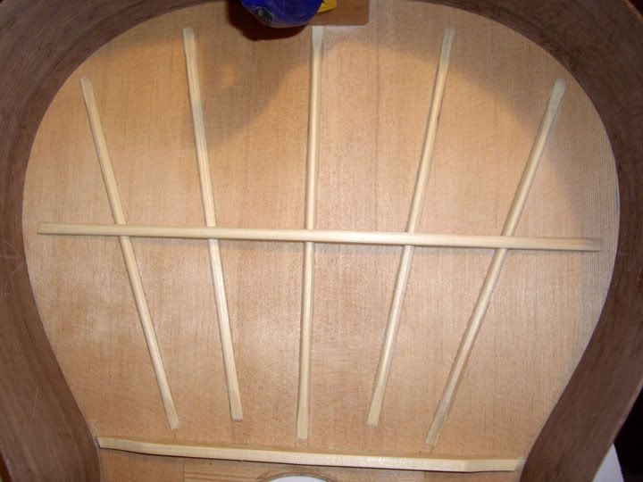

here is a photo. :)
This is before the linings, ive glued the the top ones into the sides already. Haven't glued the sides down to the top yet though. With the linings in, this brace is not quite or just barely touching the linings. m using kerfed linings
PostPosted: Wed Feb 24, 2010 11:12 pm
It looks like you'll be fine. You might want to carve it down so it's flat going under the linings., so when you notch them you can make a square, flat bottomed notch.

Here are some shots with the binding:
Close-up:
So should I extend the brace with a bit of extra wood?

No expert, but from my reading of the text of the courtnall book, the bridge bar (the crossbar under the bridge location) should finish before it reaches the linings so you are fine there.
PostPosted: Thu Feb 25, 2010 11:17 am
Good catch! I think you are right. I didn't notice that it was the bridge bar, and not a brace. I guess I'm just not used to that, as I don't use one or even a bridge plate on my guitars. I don't think that bar needs to go under the linings at all, but should be feathered to nearly nothing at the ends. "Linings" are inside the guitar, "bindings" are on the outside, at the edges.
