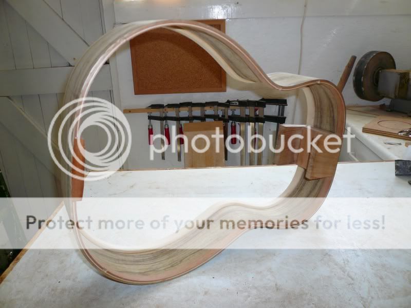

A lot of classicals have use single layer solid linings for the back, bent to fit the plantilla. I use solid laminated linings in all of my guitars, both classical and steel string, using four 1mm laminations, these are laminated together cold in a mould for each body shape.
Linings in the mould
Removed from the mould
Close up when glued in at the waist.
Glued in to the sides.

I've used kerf-less linings (mahogany) on my last 2 steel strings. I stole the method of construction from Colin...thanks, Bro!
I noticed the difference in stiffness and like what I heard. It's a bit more work but I'm in no hurry.

I use 5-6 mm poplar bent on a hot pipe.

Yes, they are solid.
To the "offshoot question"... We've had this discussion before, and although I remember I was in the minority in that debate, I agree with you: once the top and back are glued on, they lock the position of kerfed linings, and I really don't think it makes a whole lot of difference if they (the linings) are kerfed or not. I sure can't tell any difference, the closed box feels just as rigid, and I don't know how you'd measure, or even test, how it influences the sound of the guitar. Anyways, I've not seen anything but a whole lot of opinions and anecdotal evidence about it, so as in most things we do people will believe what they want to believe.
I can however confirm that the open rim is very stiff with the solid linings in place, and it makes such a clean looking interior, just look at Ken's picture, wow!
