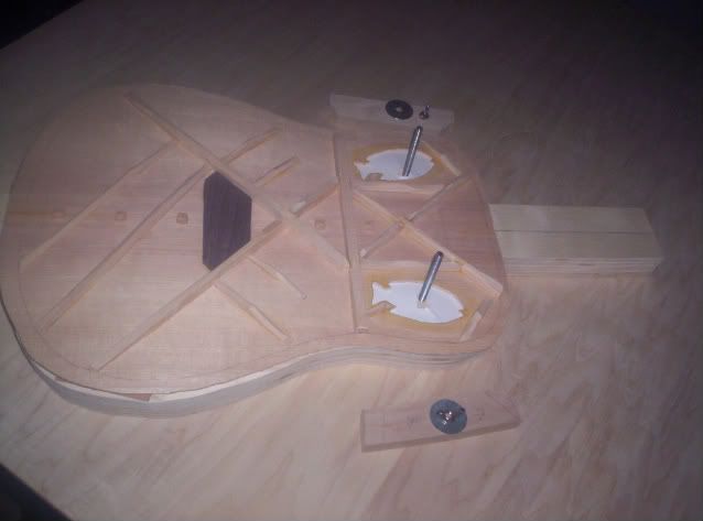

I did fish shaped soundports. It sounds awesome. One thing to take into consideration is the bracing. Heres a picture of what I ended up with. I'm thinking of doing some more creature shaped ports. Endless posibilities. Good luck.

First: Get the 'Big Red Book Vol.1' from the GAL, and look up the article on air resonance by William Allen. It's required reading.
In a nutshell, though:
The hole size and placement more or less directly sets up the 'Helmholtz' air resonant pitch. This couples with the 'main top' resonance to yield a 'main air' mode at a somwewhat lower pitch than that of the Helmholtz mode. This is the lowest resonance that can radiate sound effectively, and accounts for much of the bass response of the instrument.
The larger the hole the higher the 'Helmholtz' pitch, and the stronger the mode in general. The closer the hole is to the end of the guitar the lower the 'Helmholtz' pitch for a given size. Then you have to start thinking about how it all works with the top and back to make the 'main air' pitch you will actually hear.
It's been a while since I read Baranek, but I do have some experience with 'roses' in soundholes that divide the thing up into a bunch of smaller areas. Think about slapping some sort of grill into the hole. In that case, basically, the pitch of the 'main air' resonance will be established by the diameter of the hole, while the addition of the grill adds drag that cuts down on the amplitude of the resonance. I would imaginge that as the small holes get more dispersed the thing acts less like a hole with a grill in it, and gets more complicated.
A slot, like an F-hole, has the equivelant area to a round hole 1/3 the length of the slot, iirc. Since there is more 'edge' for the amount of area, and edge is where the drag (and losses) come from, the amplitude of the mode tends to be lower that it would have been from the round hole.
The soundhole also 'listens' to internal air resonant modes in the box. Some of these aren't heard well by a normal soundhole, and don't contribute much to the sound. Moving the hole very far from the waist will likely change the population of audible modes, and alter the sound. I talked about these modes some in my paper on 'ports' in American Lutherie a while back, and it's on my web site:
http://www.alcarruthluthier.com/Downloads/sidePorts.pdf
I once made a guitar that had two holes at the outer edges of the upper bout. These 'heard' a 'crosswise sloshing' mode in the upper bout, at about 700 Hz, and tended to 'beam' sound in that range toward the player. The tendancy was to back off a bit on notes that had a lot of that sound in them, to even out the sound to the player, which, of course, made it sound uneven to the folks out front.
As usual, this can get as complicated as you want to make it. The bottom line is that the closer you stick with 'standard' design features, the more 'standard' your sound will be. As you start making changes things get more and more unpredictable. Whether they're 'better' or 'worse' is a matter of opinion.
