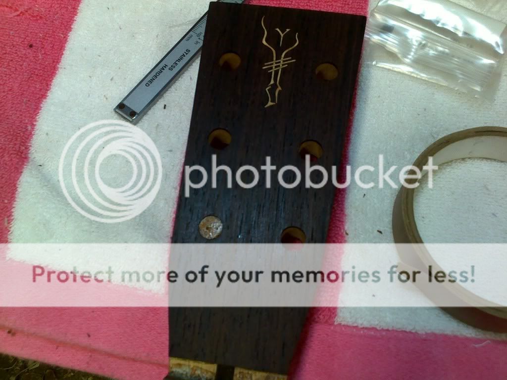

How do you go about repairing this? I've got some ideas but they don't include 10mm dowels...can't get those at the BORG.
It's the low E tuner hole.

Chris, it looks about 1/16" off &, depending on the tuner, a 10mm dowel repair & redrill would be totally invisible with the tuner & washer in place. (Great contrasts on the wood BTW)

The tuners are a set of Gotoh closed gear. I think they are Rotomatics but I can't remember. I do have some play under the washer. Looking for suggestions as to method...adhesive...so on.
And yes...I think it is somewhere between 1/16 and an 1/8 off.

Make your own dowel by turning it on the drill press if you don't have a lathe. It's really not that hard.
If you only intend to use the guitar for yourself. You can fill the hole with epoxy putty and redrill. The epoxy will look like a tiny crescent moon nest to the new hole and can be stained to look like RW on the top and mahogany on the back. It will be no more noticeable than a dowel plug. If the body of the turner and the nut will cover the patch, no one will ever know.

10mm is about 3/8 .. and you can likely get those at the BORG ....
I would plug and redrill .... and before making another guitar, like Hank says, make a drill jig.
Too bad hte inlay is already in there .. otherwise plug and reface ... invisible. BTDT.

I don't know if anyone sells them, but if you can get a 10 mm plug cutter, and have some waste from the headstock and headplate, you can make a near invisible repair that way.

You can also make a nice plug by whittling one that is slightly oversize, and pound that through a 10 mm hole in a steel plate. After you drill the steel plate, don't remove the burr as it's edge will shave the dowel when it goes through the hole.

I ended up using a 3/8th's oak dowel (it was all I had)...that left just enough wiggle room for some medium viscosity CA to wick in (slow). Re-drilled the hole and now I'm on to other things.

This is a terrible photo but here's the fix. Oak dowel cut short so that I had a shallow 'pan' on both sides of the headstock. Wicked in some CA...and remarked where the hole should have been.
I'll be making one of them drilling jigs fer sure.
