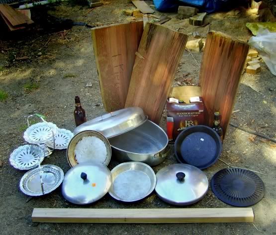

Now for those of you who can't read between the lines, please look at this next pic and find the feeling no pain Padma ...
holding an oval aluminum roasting pan...that would be the body, yup an oval body`~ two of em, and the assortment of aluminum pie plates ....them the resonator, there is even a saw pierced silver dish from a lazie suzan that gonna make a fabulous cover plate. Now that dark round thing with all the slots in it is teflon coated...don't know what it was for originally, but she sure do ring nice when taped..yup a cover plate for sure....maybe paint the whole thing black and oft it to some heavy metal dude. The stick of wood in front is the neck and the cedar shingles gonna be the top....naw, best me use ply wood for top instead. All the hardware for this build me found at the Rev. Jim's Junk Store...ya know him collects and sells the junk to finance his soup kitchen for the homeless here in town.

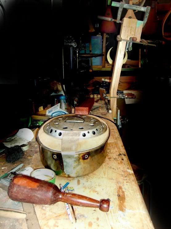

Any suggestions for connecting a stick to a can...as in options on neck joining to a parabolic curve. (The aluminum roaster, she be oval)
Seems to me to be a few options...bolt on....quick and dirty.
or
2 cut the roaster and ad a heel block to the neck, mortise slot the sides that slides onto the cut.
or
Do a dove tale into the roaster....Naw... a parabolic shoulder on a doves ass is too much to be bothered with.
Your suggestions and donations to Help the Padma figure it all out Fund, are most graciously welcome.

Quote:
Quick & dirty? Carve the neck so it touches only at the outer edge of the heel and hollow in the center. Then use bondo to fill in and give better contact to the metal bowl. Screw or bolt through from the inside. No need for a heel block if the metal is sturdy enough.

Yup,Greg, Quick and dirty she is gonna be alright.
Yahoooooooooo .....

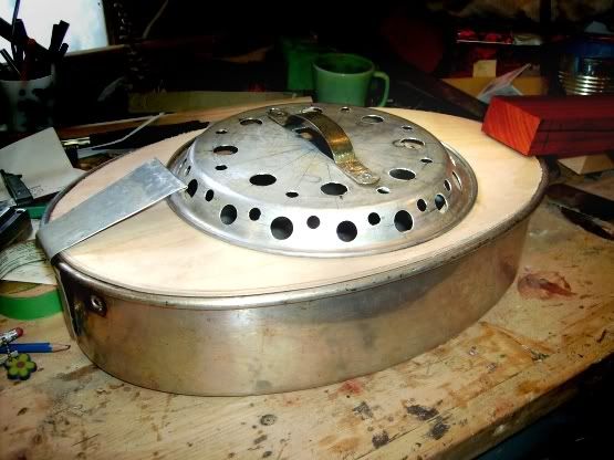

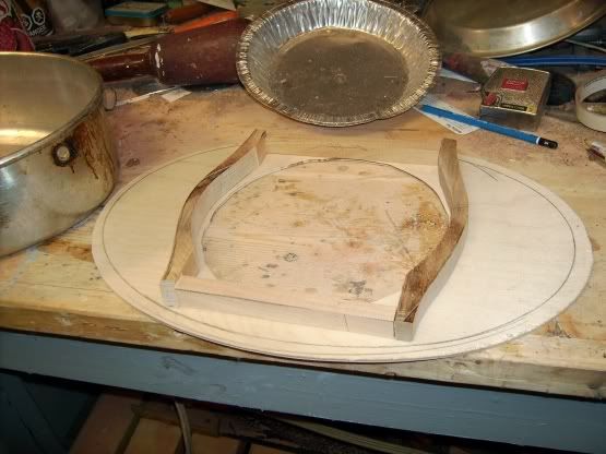

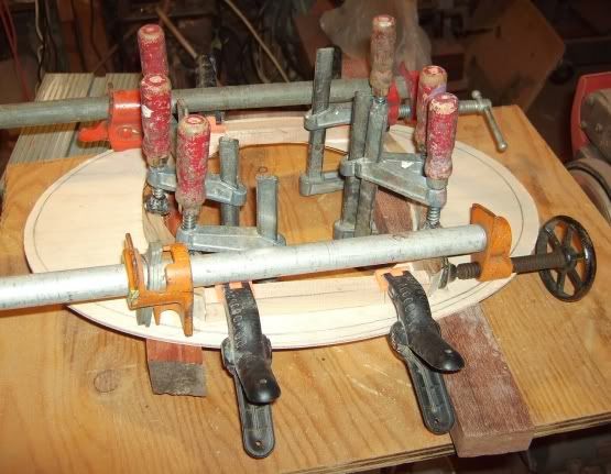

me poked a hole into some birch ply.
cut and glued up some birch bracing.
cut a hole in an old pie plate and drilled the holes to mount the bridge cove which is one of the two handles from the roaster. Will add the sound holes tomorrow.
Me can hear it already.
Gotta go git some epoxy to glue down some kurfing for the top.
Don't ya just love it!

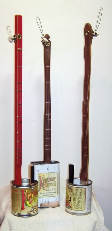

Perhaps others might get the big idea that it don't gotta come from Stewmac and cost a lotta dollars. I believe in instruments for them that don't got no fist full of $. or a 9 to 5. Music was always a tribal thing. Even if you plugged into a 1000wat Marshall. Roots were tribal...stick, string and gourd. Only we don't got no gourds in NA but we do have a huge daily crop of tin cans. Remember the cigar box guitars?
Kathleen n me, we played with a lotta cans a few years back. In fact, we put a neck on every type of can we could fish outta the recycling bin with a stick string and a magnet....scrounged for about 6 months. (maybe for the next batch of canjos, I invite Steve (slstexas) to go fishin with me). Don't need no bait, boat or fishin license .
The round cookie tin had the neck screwed on to the lid. Sonically it didn't cut it.
Here be some pics of the Canjos.

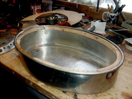

epoxied in the kurfing last night.

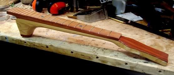

me pulled out a tight grainded red cedar neck, blocked her up, and cut out a block of paduk for the fret board.
made a tail piece from an aluminum pie plate
and added some more holes to the lid.
Gonna go carve the neck after me get fed.

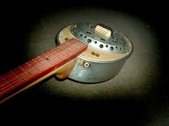

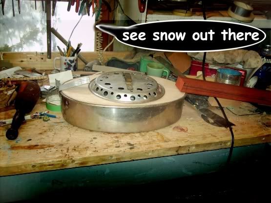

So after feeding me went at the neck...came out like this.
Gonna butter her up with bondo and bolt her down just as Greg suggested.
Padukie on Red Cedar. Abalone at the 5 and 12th. Quick brushing of some plastic
stuff from the Wally store.
Did some embellishment on the tail piece.
Found some brass rings for sound ports.
Heel looks like this and is joined at about the 18th, runs back to about the 15th. A total of 22.
Same width as a strat. but 24.85 long and flat. Much fatter and "D" shaped. Slight cantilever on
the last 4 frets.
If I had some strings I'd be plucking her in another hour or so...but gonna hafta wait till
tomorrow or whenever the snow stops.
Gonna use a high set chunk of brass for the bridge.

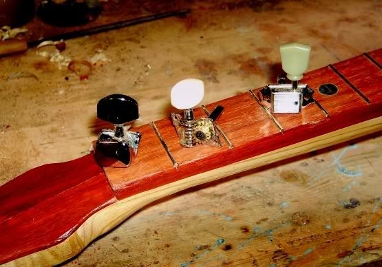

Been thinking of using assorted tuners...just to add some funk...what do you think?

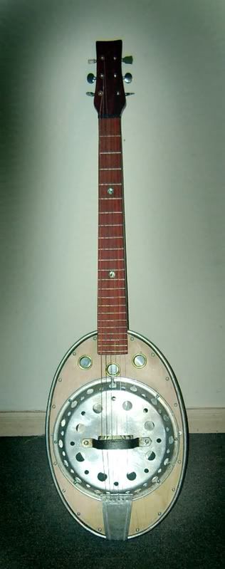

So there she be. Came together faster than I dreamed of.
Always wanted me a dobro. Every time me make one, some one else gets it. This one is mine.

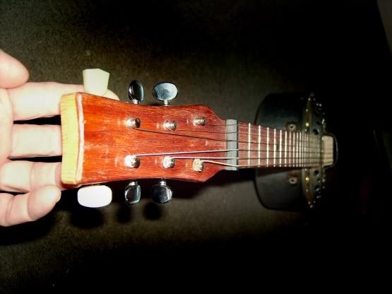

here be pics of me resonator efforts.
Check out the tuners.

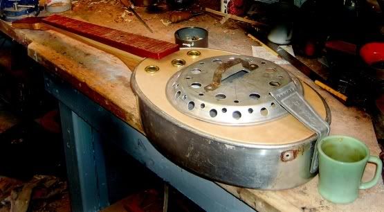

Neck came out too thick. Still gonna shave the neck more. Pull the frets, joint off a 1/4 inch from the fret board, refret, get a case of beer, change me name to Dr. Feel Gooder, and go at her.
Is heavy. Not quite as fuzzier buzzier as me would have liked...watching the junk shops / garage sale for the type of disposable pie plates from the 60 / 70s. Hard to find but the fuzzie buzzies suppost to be there according to the myths and legends of the long ago builders in these hills. When me find one I will repost.
Was after that "made way back in the hills" look...thinks me nailed it...just gotta watch out for
the silvers. oops_sign
Still have the lid which is dome shaped...one day and with luck me find two of them pie plates...then...
All in all she works. Looks real funkie. Was a fun go around.
Don't ya just gotta love her!
