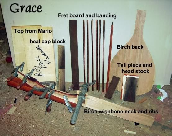

Birch; a Red Bear donation from the Mario, thanks Mario; Padauk; White wood Holly gift from the Jesse, thanks Jesse; and some really dark brown and darker brown (as in black) grained stuff me no not what it is or from were it came. It appeard one day about a week or so ago and is just enough to do one build with. Hmmm...
Parabolic or domed carved top but with the recurve on the inside so the top is one big curve.
Back ...probably leave it in one piece and carved just like the top with the recurve on the inside.

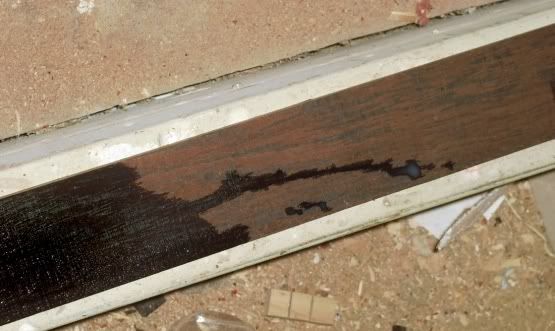

At first I thought this Chocolate brown and black stuff was cocobolo but she no got the smell...is easy to bend. Perhaps someone here might be able to ID it.

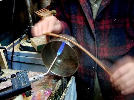

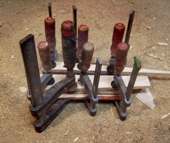

Regarding the bending of the wishbone sides, kurfing and back carving. The process is identical to many of my other builds.
As such they have not been posted...if interested, I refer you to my other builds on this site which document this process.

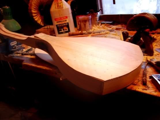

So I got the back on.

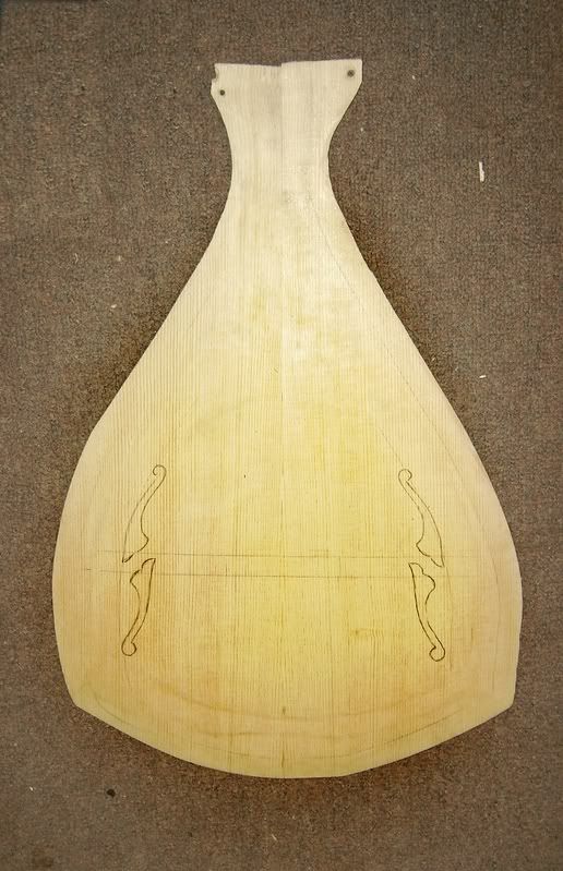

Started carving this Kermodi Red Bear top, and encountered this.
At first I thought I had caught it with the plane in the rough bulking. Scraped it out but it keeps opening up a few 16ths up or down or over. Seems the top has run out that wants to open up ...like as if the wood is spiting herself open. Appears on one half only...now it might appear on the other side but of course it would be on the inside of the top.
So now I gotta decide if its worth spending half a day carving out the back only to find out the top is truly defective. Just another Hmmmm....what to say or what to do....perhaps I will take down the back in this area only and then decide.

Now I like a challenge...so tomorrow I will carve out the back and see what I am working with. See if the situation carries right through the wood. The area in question may just fit right under the cantilever fret board. Non the less the situation is a learning one for me and as such I will hold off on accepting your kind offer for a bit. Its the challenges in life that make it all worth while and offers of help that make life easier...
Well after finishing carving the back I decided to use it although the wood seemed to be some what soft or punky and cut best with the chisels at almost 90 degrees to the grain to prevent tear out and grain separation. The tap tone is good.
However as this is another experimental build, I wanted to learn from this piece of wood as to how it would perform. If it was a clients build, the top would have been rejected within the first 5 min of starting to carve it. Non the less I wish to thank Mario for offering to replace it.

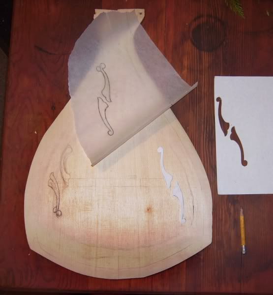

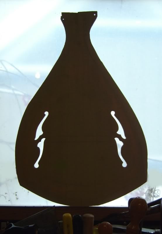

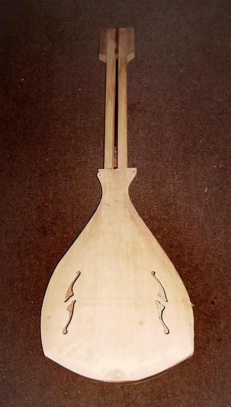

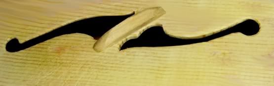

Must thank Steve (slstexas) for the design of the "f" holes which I then modified some what.
and ended up looking like this...gonna see / hear what see sounds like...then perhaps
use this design on the head stock, pick guard and tail piece.

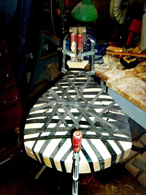

Added a small brace to the f hole and somewhat thicker birch parallel braces up ether side of the center to compensate for the softer wood. The wood has a tendency to tear with scrapers so its gonna hafta be sanded down instead. This should prove to be an interesting top.
Top ready for gluing to ribs.
Quote:
Hey Padma
Nice variation on the "F" hole design.
Looks graceful and well suited to your instrument shape.
~ Steve

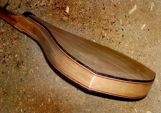

Ready for routing the banding rabbit.
Banding is weng, padauk, and some holley from Jesse.
Laminated, ripped and bent.
Two pieces left to go.
Black African heal and detail of banding.

Banding came out like this...is ok.
Quote:
Padma,
That is just beautiful. Wonderful work. Great design.

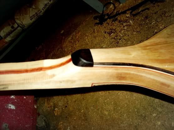

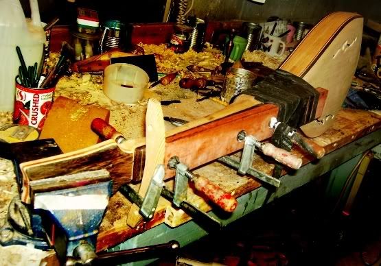

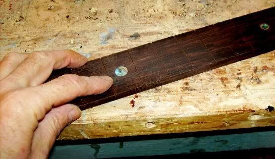

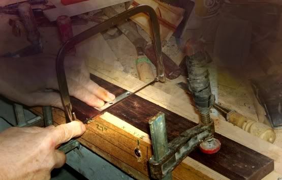

Slottin for the frets
Gluin her down.
Carving of the heal.
Quote:
Daggone if that ain't another beauty, Padma! Keep it up, you continue to amaze and inspire me.
Blessings,
~ Mark

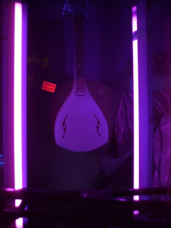

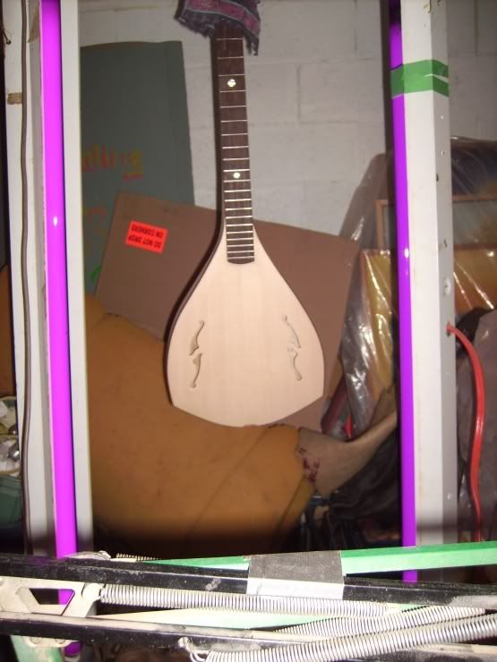

Patched, scraped and sanded.
Then hung up under UV lights to get that 'old patenia' look.
Gonna let it sit for about a week.
We will see how it comes out.
Well, if I let it sit under them UV for about 6 months well then maybe...I get better results exposed to direct hot sunlight
for half a day. Then I find out the UV bulbs gotta be them real expensive suntaning type insted of
the black light painting / party type I've got... just another one of them oh wells.

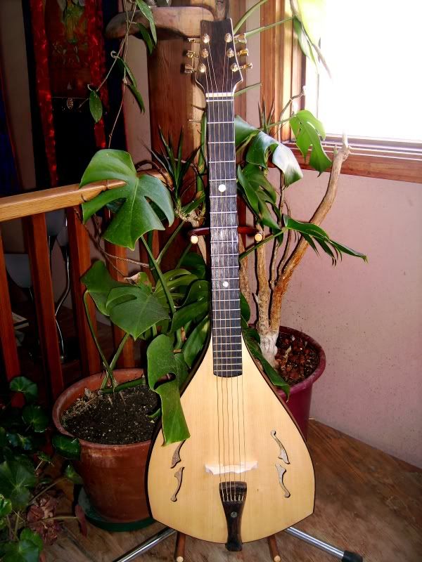

Ok. Here be pics of the finished Grace build.
Had troubles with the first finish and so strip it off and re did her.
Of course this meant loosing the little UV aging that did develop. Oh well.
Oh and Eric, you asked about the UV lights. Well all the UV lighting I got is good for kicking of my black light art work
and works for fast curing a boiled linseed oil finish but as far as aging an old patina effect...well it would take about a month for any descent results although it dose work..but too slow. So I would advise natural sunlight or using the UV lights that the females of our species like to tan under.
So here she is finished.
