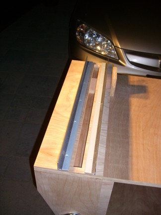

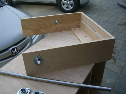

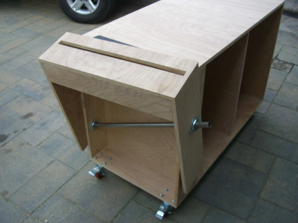

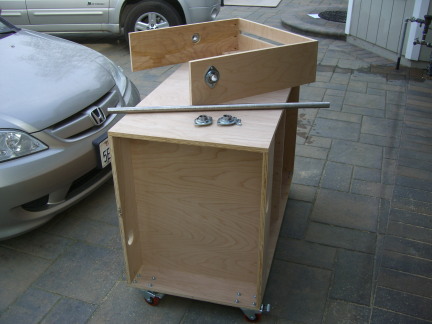

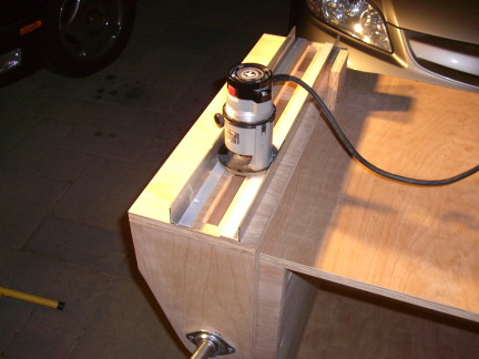

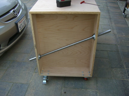

I was kind of stalled making progress with my first guitar until I had made a couple of jigs that I wanted. These were a compound radius router jig for doing the fretboard, and a Fleischmann derivative flying router binding jig. I decided to build them into one work unit.
Here are some pictures of the jig I built for routing a compound radius on fretboards (12" radius at the nut end and 20" radius at the soundhole end). The original designer of this type of jig is Mario Proulx (of Proulx Guitars fame) who has a brief description and some photos of it on his website - kudos to Mario for thinking of it first (way back in 2003 or earlier I believe!). I found out about Mario's original after I'd started work on my version! Great minds think alike, they say (or is it "fools never differ"? :lol: ). I checked with Mario first before posting, to make sure he was okay with it, and of course, like the true gentleman he is, he had no issue with it at all. Thanks Mario [:Y:] [clap]
My version of this jig occupies the left hand end of a mobile work unit that will also have a Fleischman derivative binding routing jig on it. The work unit will also eventually have a set of 8 or 10 drawers for luthier tools and supplies. The jig works by virtue of a stainless steel shaft that runs in four spherical bearings, one pair on the sides of the work bench and the other pair on the sides of a swinging router guide. The shaft is set at an angle to the work surface such that the radius of the swing is exactly 12" (from the axis of rotation to the surface of the fretboard - assumed to be 0.25" thick before routing) at the nut end of the work piece and exactly 20" at the soundhole end of the work piece. The shaft forces the router guide to swing in a compound arc, tracing the surface of a section of a cone.

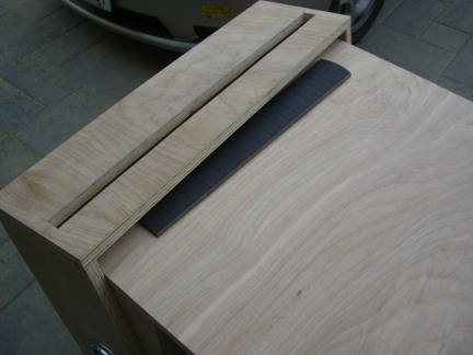

Almost done! The swinging router guide subscribes exactly the right compound arc, per the calculations! It has plenty of free swing to route the widest fretboard I'm ever likely to want (over 4" wide!). The swinging router guide binds on the sides of the work unit at its extremes. Just need to add some aluminum angle with some sticky-backed slick material (which is clear, so you can't really see it in the photos) to set the router path straight:
Et voila! Done!! It's incredibly smooth in operation. I think I will devise a way to lock the swinging router guide in place for each pass of the router - perhaps a set of holes with a lock-pin, or perhaps a threaded lock-knob of some kind (although I'd rather it not intrude on the drawer space...). I'll post pictures when I come up with something.
I will also post a link to the SketchUp file (that I got my son to make to prove the design) in this thread later tonight when I get home from work.
I hope this helps someone.

Dave you are a genius! Where did you get the hardware? [:Y:]

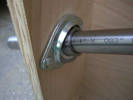

Dave I've thought about bearings like that but couldn't locate them. Where did you get those?

Genius? :o That's a bit strong Ricardo... :oops: Maybe "dexterous" :D
The bearings were from The Big Bearing Store ($8.78 each) and the shaft was from Mc Master Carr product number 89785K173 ($59.45). The alumin(i)um angle for the router guides was from a local metal supplier - you can find it pretty much anywhere. The work unit is plain old 3/4" A/C birch plywood glued and screwed using pocket-hole joinery courtesy of Kreg. Sturdy castors were from Woodcraft - product #141050.
The bearings and shaft I used are way over-engineered for the job really. I'm sure you could use a much smaller (1/2"?), and cheaper, shaft and bearings without any issues.
HTH,
Dave F.
Cambrian Guitars

Looks great Dave! How sturdy is it against twisting? What kind of bit are you using?
Any photos of a fretboard straight out of the jig?
Hi Erik,
It's very sturdy indeed. I don't perceive any twisting at all. The swinging router platform is stiffened by the plywood "end plate" and further by the alumin(i)um angle router guides. It doesn't need it, but if you wanted to further stiffen the jig, you could add metal angle to the vertical sections of the swinging router platform.....really though, it doesn't need it.
I used a 1/4" diameter flat bottomed router bit and ran about 10 positions when I did a 2" wide test piece (scrap wood) on it last night. Perhaps Mario will tell us what bit he uses also. I have yet to do my first real fretboard (the one you can see in the photos) in it - I'll do that this coming weekend and post pictures then.
BTW, I set up the height from the top of the work unit to the underside of the swinging router platform to be exactly 3/4". This made set up (getting the platform exactly parallel with the work surface) easy - all you need to do is slide a 3/4" thick board into the jig, then tighten down the bearing screws. Also, it allows you to use a simple piece of 3/4" plywood to stop the platform from falling all over the place when you're not using it - you can see the simple L-shaped plywood "stop" that I made for this in the last few photos above. This holds it in the dead straight up position when not in use.
Cheers,
Dave F.
Cambrian Guitars
