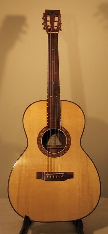

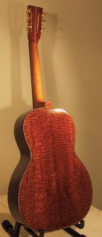

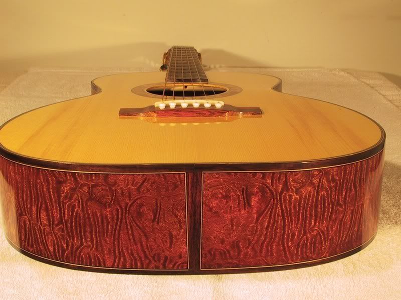

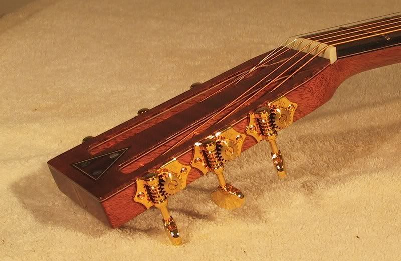

I recently completed and setup the first of 3 that I started back in October. This one is a 000-12 Fret with the following specs:
...Top...Adirondack Spruce-- Very stiff but has some cosmetic flaws (much like it's builder).
...B&S...Quilted Sapele-- From The Zootman. Remember when I dropped and split the back and brace? Thanks to David Collins for the on-line tutorial as well as the Fish Glue and hardware to do the repair!
...Bracing...Adirondack Spruce (HHG)
...Bindings, Bridge & FB--BRW
...Rosette...Segmented and mitred Quilted Sapele
...Neck...5 piece laminate finished in Danish Oil
...Finish--French Polish using Robbie's method.
...Tuners--Grover gold
...Glues--HHG on everything except FB to neck (epoxy)
There are a few firsts on this one for me:
...Untucked lower X-Brace arms
...1/8" saddle with a 5* tilt
...M&T aligned and routed using the Woolson/Fox jig
This guitar is for my personal use since I have given away my first six to family members. As many of you know, I name all of my guitars. This one is dedicated to Bob Cefalu and is appropriately named, "Zootman". It honors his friendship as well as the help and advice that he has given me over 3 the past years. Thanks, Bob!
Here are some pics of "Zootman":
The sound is loud and sustains forever. I am very pleased with the results but need to have an unbiased player to fairly characterize its sound. I have a difficult time describing tone but it seems to have a very balanced voice. 12 Fretters are my personal favorites and this one is very responsive to my style of play. Thanks for looking!
PostPosted: Fri Mar 02, 2007 3:26 am
JJ,
You should be proud as should the Zootman. Lovely looking guitar and the FP really glows.
Looking forwards to some soundclips
PostPosted: Fri Mar 02, 2007 3:29 am
JJ: Love everything about this one. The sapele is just stunning and I love the rosette. FP is so amazing in how the wood seems alive underneath. Cheers JJ - for this beauty.
PostPosted: Fri Mar 02, 2007 3:35 am
Nice......real nice.
Great looking guitar JJ, ya done good. Nice rosette and matching headstock trim. What else ya hidin over there?
PostPosted: Fri Mar 02, 2007 4:22 am
Really really nice guitar, JJ. Love how present the grain looks through the FP.
PostPosted: Fri Mar 02, 2007 4:33 am
Posts: 1075
First name: Coe
Last Name: Franklin
City: Decatur
Excellent work, JJ!
Coe
PostPosted: Fri Mar 02, 2007 4:34 am
Joining the Chorus, Way to Go JJ. I especially like the Rosette, it rocks. The headstock and your design inlay are top notch. The tuners are good looking, I have a set like that waiting on a luthier, ahem.
And last but not least, Bob Cefalu is a heck of a guy. He's a self-made zoot man, and deserves this kind of recognition. Plus, the fine sapele will draw comments until it passes from your hands and beyond. The likes of Rembrandt and Stradavari combined come to mind. JJ, now you've gone and done it. You've created a masterpiece.
PostPosted: Fri Mar 02, 2007 4:41 am
Posts: 783
First name: Kirby
Inspiring!!!
"It's a Tone Faerie thing"
PostPosted: Fri Mar 02, 2007 4:48 am
Posts: 326
Stunning! What a great usage for such wonderful wood. Your work is spotless.
PostPosted: Fri Mar 02, 2007 4:50 am
Posts: 655
Location: Columbus,Ohio
You should be proud and happy to finally own a quality instrument just for your own use! Several points I like, the wood is stunning and I like the way it comes out from the finish. Clinton
PostPosted: Fri Mar 02, 2007 5:12 am
JJ, This is AWESOME my friend! I really think you outdid yourself on this one! WoW ! That rosette is beautiful! You should be proud of this one and cool that you named it after the Zootman! Yep,I do like it! Any chance of a sound clip? I would love to hear how it sounds.
PostPosted: Fri Mar 02, 2007 5:29 am
Posts: 1624
First name: Larry
Last Name: Hawes
VERY nice JJ. The Sapele is STUNNING and the rosette is great and beyond my skills. I happen to LOVE 12 fretters too and yours is so classic and clean. SUPER good job. I'm going to string my 12 fret Redwood Bloowood this weekend. CANNOT wait and am very inspired by yours.
Awesome job and thanks for posting the pics.
Larry
Thank You and Best To All
PostPosted: Fri Mar 02, 2007 6:04 am
Posts: 1315
Location: Branson, MO
First name: stan
Last Name: thomison
City: branson
State: mo
Zip/Postal Code: 65616
Country: united states
Great job JJ. nice miters on endgraft. You picked a great guy to dedicate this guitar to, don't get better than Bob. keep em coming
PostPosted: Fri Mar 02, 2007 6:06 am
Posts: 412
Location: North Muskegon, MI
Excellent work!
As mentioned already, the quilted sapele is absolutely gorgeous and your
side purfling tasty and well executed.
Christopher C. Cordle
North Muskegon, MI
PostPosted: Fri Mar 02, 2007 6:19 am
Posts: 565
JJ that is just beatiful. Looks like you are raising the bar these days.
I really admire the finish. How long did it take you to do that?
PostPosted: Fri Mar 02, 2007 6:33 am
Awesome.
WOW SAPELE WOW!!!
I love your rosette!!!!!
One of the best we have seen posted in a long time, and we have seen some
stunning guitars!!!
Well done
PostPosted: Fri Mar 02, 2007 6:35 am
Thanks for the kind words, bros! The rare occasions where I actually have results to show are special to me as are your comments.
This is a special guitar for a lot of reasons, not the least of which were the accidents that happened along the way.

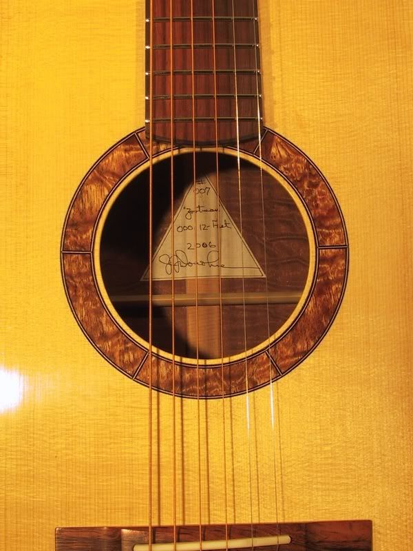

In addition to the guitar crash already posted, I had a disaster on the rosette. After spending the better part of a week to get all the miters and segments matched up, gluing it together and planing and scraping it smooth, I decided to touch up the rest of the top with a larger plane to smooth out the surface. Well, I snagged a few spots on the rosette and blew out 4 chunks. I had to rout out the chunk holes and replace them with matching plugs. Good thing I didn't have to match fine grain but it took many additional hours to restore the rosette. Sooo...see if you can spot the 3 repair plugs (The 4th is under the FB extension).
Sound clips...right now I have no knowledge, nor equipment to produce a sample clip. I'd love to know what is recommended.
As I said...Zootman is the 1st of three that I'm completing. In a few more days, I should have the 2nd ready for posting. The 3rd is in Nitro limbo for a month or so.
PostPosted: Fri Mar 02, 2007 6:38 am
Posts: 588
WOW !!! I love this guitar, JJ!!!   The rosette is beautiful. The quilt on the
sides look like it's 3 inchs thick!!!   It must sparkle in person!
Can't wait to see the next two.
Long
PostPosted: Fri Mar 02, 2007 6:44 am
Posts: 588
JJ, Did you do a burst on the neck??   It may just be the photo that makes
it look that way, but it looks great. Can ya tell us....How'd-ya-do-that??
thanks, Long
PostPosted: Fri Mar 02, 2007 6:49 am
John K...My bar might be getting higher but still a lot lower than that of the K-Bros!
I've FP'd 4 guitars now. I'm becoming more efficient and proficient with each one but I would say it takes me 15-20 hours over a 2 week period to do an entire body now. I've settled on the method that Robbie shows in his DVD...it's far simpler and just as effective as the Milburns' method. Rather than using the traditional pore filling method, I use Zpoxy. I also use de-waxed canned Zinnser shellac at a 1# cut. Both come highly recommended by our other resident experts, Michael P. and Colin.
PostPosted: Fri Mar 02, 2007 7:41 am
Bob...It's not a burst on the neck...just a few coats of Danish oil. The headstock and body is FP'd and what you may be seeing is the contrast between the glossy and matte surfaces.
PostPosted: Fri Mar 02, 2007 8:09 am
Well JJ I am both honored and overwhelmed with your
"Zootman" guitar. Your friendship means very much to me too bro' Very very beautiful instrument that you should be very proud of. I can't wait to see it in person. Thanks again for the HONOR my friend.
PostPosted: Fri Mar 02, 2007 9:07 am
Posts: 565
No way I could have done any better JJ.
What do you think about the oil finished neck? Is it smooth and not sticky. Does the oil harden enough to withstand ware? Does that take a lot of time and a lot of coats? Do you recommend a particular brand of oil?
TIA
