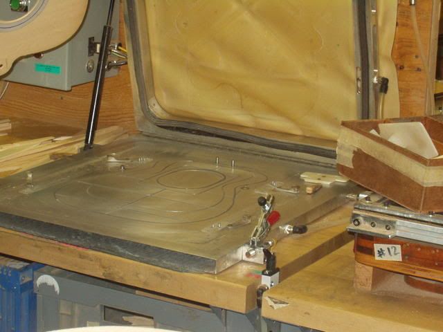

Here's one of Martins sound board vacuum clamps -- I'll ask my Martin Engineering contact if its flat or slightly contoured.
There's plenty of boutique builders that use tighter radius bracing than Martin -- the folks at Santa Cruz and Taylor have indicated that this strategy increases treble response with the net result of less perceived bass response.
Ken Cierp
PostPosted: Wed Jul 20, 2016 9:36 am
Posts: 1737
Location: Litchfield MI
Update from the Martin factory
Hi Ken,
That is a top bracing fixture. The plate is flat with a 1deg. angle that starts at the back of the number 1 brace just above the soundhole and continues to the top or front block.
Ken Cierp
