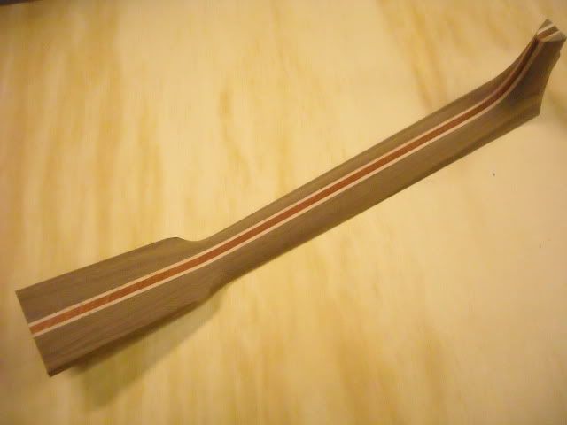

No pictures? Well how about a bad one?
A small parlor, did a three piece neck. I agree that a 3/4" center lamination does look heavy. Would go for a 5 piece next time.

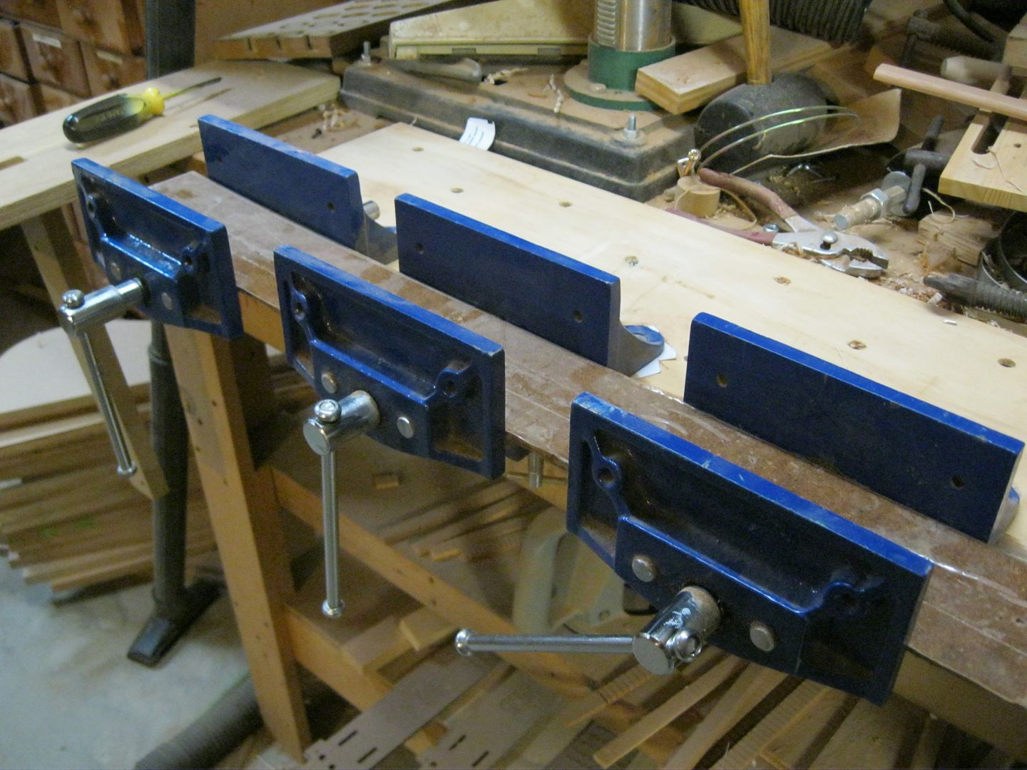

 Post subject: Re: Laminated Neck
PostPosted: Sat Jul 16, 2016 7:59 am
Posts: 1737
Location: Litchfield MI
To speed up our laminated neck assembly we set up this clamping station.
Ken Cierp

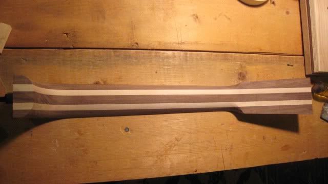

Here's something a little different, it's the neck for my challenge entry.
The neck is walnut with maple accent stripes. The headstock is 3/4" thick and is scarf joined to the outside laminates.
There's more construction photos in the challenge thread, as well as plans, if anyone is interested.
