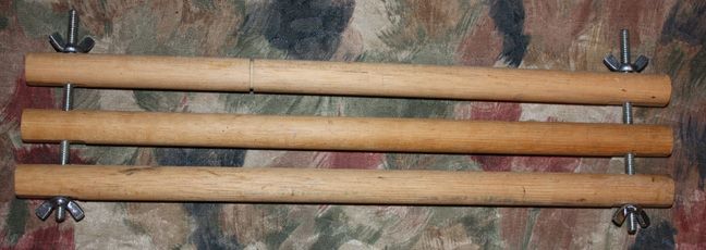

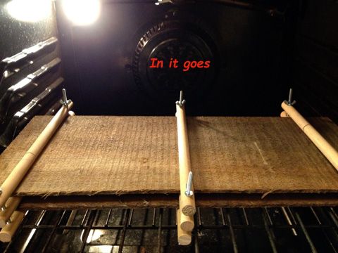

I use 3 of these Image , set up like this Image . Don't tighten the wing-nuts to tight or it leaves a dowel impression in the top. 200F for 1 hour, let cool in the oven then repeat.
Bob

Great idea Bob!

I have setup like Bobs, but mine is made up of some flat maple pieces, about 1/2 inch wide by maybe 1/4 tall, threaded rod and wing nuts holds it all together .. I can get about a dozen tops at a time into the oven, 2 hours at 195F, convection fan on, then complete cool down overnight in the oven .. wing nuts are snug when they go in, and are about two revolutions loose once the tops are done ... everything except sinker redwood gets done, I had a couple of those crack on me first time I did them ..
